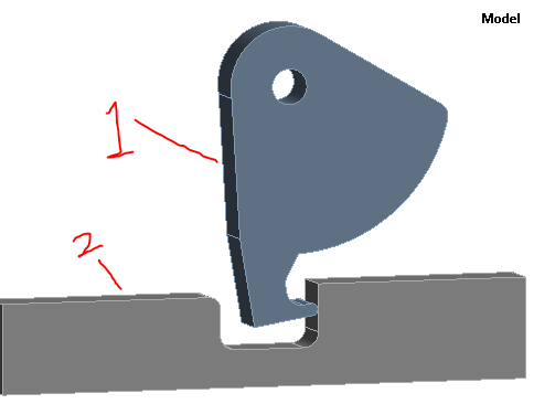

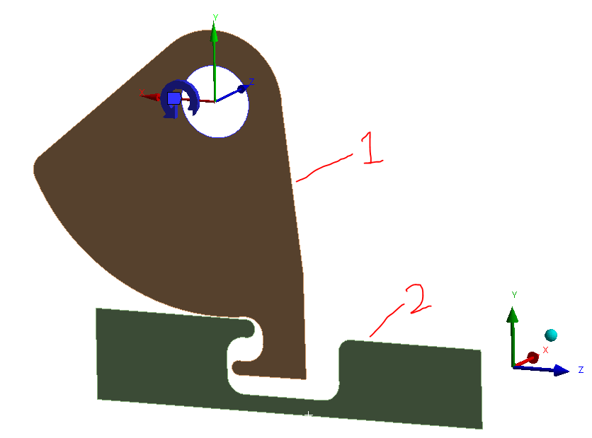

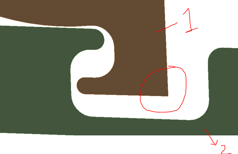

      Thanks for your reply.  Below are the screenshots of the analysis I am working on. Component 1 will rotate about its axis back and forth like a pendulum. As it rotates back and forth , it will push and pull the component 2 . I am interested in finding out the wear at the sharp edge of component 1. Whether the Archard wear model will be suitable for this case? Here it is more of an impact than sliding wear. i have to simulate and estimate the wear after a few thousand cycles.
      Thanks & Regards ,
      Manoj
      Hello Manoj
      I believe the wear is calculated based on the contact force as the sliding occurs.
      You will need a very fine mesh to have many elements along the sliding distance.
      You might find the contact is more stable if you put a very small radius on the sharp corner.

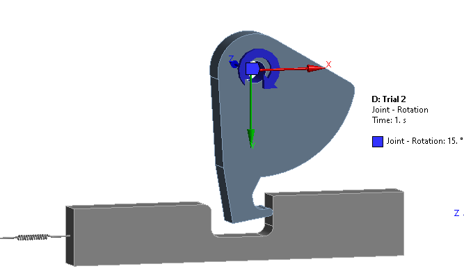

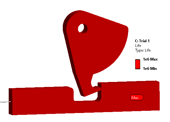

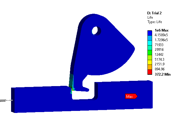

      Thanks again for the input. I did 2 trial fatigue analyses.
      In the first trial, component 1 will rotate back and forth ( 2 steps), and as it rotates, it will push and pull component 2. i observed some stresses in the component, but in the fatigue tool, I am finding the component’s life to be infinite.
      In the second trial, component 1 will rotate only in the clockwise direction. I observed some stress in this too, but now the fatigue tool is showing varying life across the component.
      I don’t know why for one trial I am getting infinite life and for the other I am getting finite life. How to attach the workbench archive file in this post. I can share the workbench archive for this.

      I don't know why one Fatigue Tool gives you a plot and the other doesn't, but I don't use the Fatigue Tool much. As I suggested before, look up the minimum life manually.
      Note that Fatigue life is different than a wear simulation. A wear simulation will actually move the nodes to show the amount of material lost over the cycles of sliding with a contact force present.
