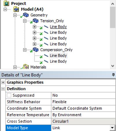

      In 19.2, you can change Beams to Links inside Mechanical without using APDL code, which is where you made the change.
      Change the Model Type to Link. (If you shift-click, you can do four at once).

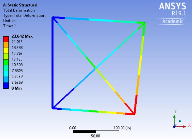

      Another problem is you don't have sufficient constraints to have a Static solution. You have only one Fixed Support. You need another vertex to have a constraint in the X-Y plane.
      I changed Displacement 2 to provide the four vertex corners a Z=0 constraint, while leaving all others free.
      To allow it so solve, I added an X=0 Displacement Support at the top left vertex.

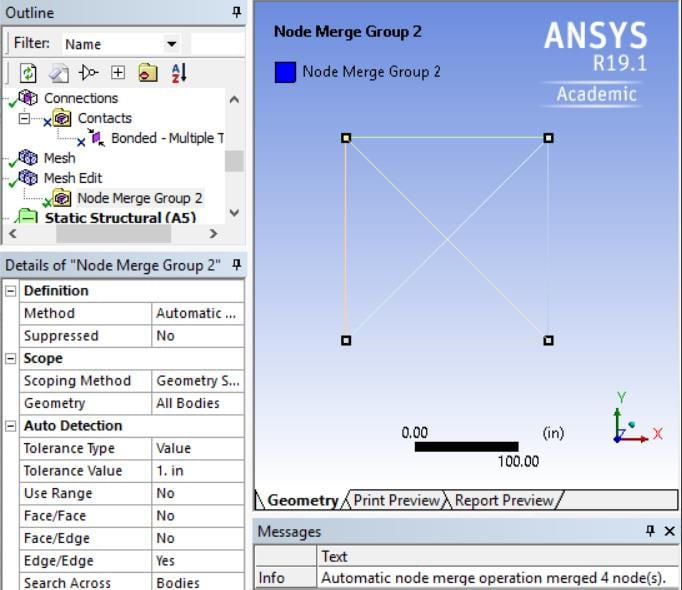

      Did you confirm that your Mesh Edit merged 4 nodes?
      With all the above changes, and if I suppress your Command Object, the model solves.
