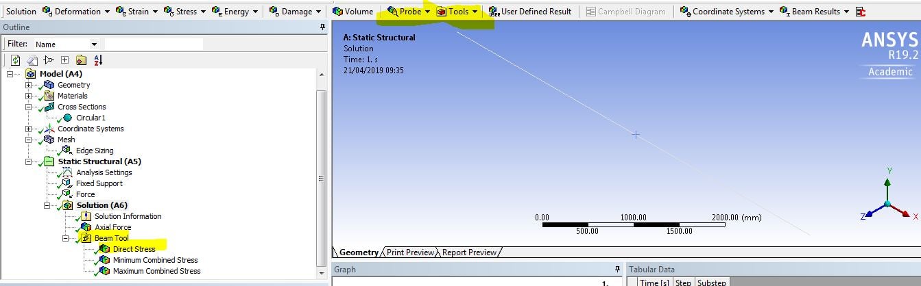

      It is very easy, go to tools (see marking below), and insert beam tool, and look on direct stress which is the axial stress (Faxial/Area).
    • yang
      Hello!
      Thanks for the suggestion. I've tried, but because the element type is changed from beam to Link180. This is not workable for Link180.
    • yang
      Hello!
      Thanks for the suggestion. I've tried, but because the element type is changed from beam to Link180. This is not workable for Link180. There's an error says "The result data for BEAM is not contained in the result file."

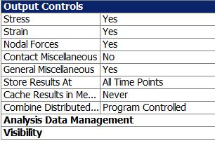

      Hello Yang,
      Beam Tool > Direct Stress did not work for me either.
      But the User Defined Result did work for me.
      You might need to set the Output Controls the same as I used.  It may be the General Misc. output.
      Note: the real area of the cable in this model is 1.2566e-05 m² while I used 0.001 m² for an example.
