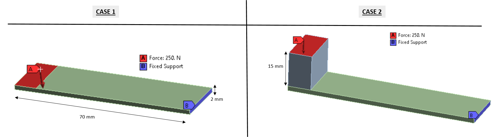

SubscriberSo, I was just doing some Finite Element Analysis (FEA) to figure out what would be the effect on the stiffness of a cantilever beam if another beam is attached to it on its free end.

February 24, 2022 at 12:53 pmpeteroznewman
SubscriberYes, the change in deformation is due to the addition of the block. Move the block to the other end of the cantilever and you will see a much larger change in tip deformation. Move the block to the halfway point along the length and the tip deflection will be between the other two results.
The addition of the block is changing the stiffness of the beam. While the change in local stiffness is the same in the three positions of the block, the effect on tip deflection depends on where the stiffness increase was located. The effect is largest when the stiffness increase was near the base and smallest when the stiffness increase was near the tip. The reason is the bending moment is large at the base and small at the tip, so adding stiffness at the location where the bending moment is largest has the greatest effect on tip deflection.
I should add that if you use a Kinematic Mount to connect a block to a beam, that will have zero influence on the stiffness of the beam. That means the static tip deflection will not change whether the block is mounted at the tip, the base or not mounted at all. However, since many systems are subject to gravity or vibration, the mass of the block will cause the mounting position to influence other results such as the first natural frequency or the deformation under a gravity load instead of a tip force.
February 24, 2022 at 8:31 pmRameez_ul_Haq
SubscriberThe reason is the bending moment is large at the base and small at the tip, so adding stiffness at the location where the bending moment is largest has the greatest effect on tip deflection.
Is this coming from the general Bernoulli beam theory? And also, not only for this system, but for any type of system if I increase the stiffness in the region where the moment is highest, that will have the greatest effect on the max displacement of the beam, is that correct? Say, a beam load in the middle with two pin supports at each end.
In you last para, you mentioned these:
However, ........ , the mass of the block will cause the mounting position to influence other results such as the first natural frequency ....
how is that, can you please provide a visual example to elaborate what you meant by connecting the gray beam to the green one using Kinematic Mount? i would be grateful. I know what you meant is that now the gray beam can be thought of a simple Point Mass, but how can kinematic mount achieve that, I want to understand this.
Secondly, why would the location of this gray beam (or a point mass) change the natural freqeuncy, since still the total mass in the system and its overall stiffness is still the same?

February 27, 2022 at 11:38 pmpeteroznewman
SubscriberYou could compute the stiffness of each length of the beam using Bernoulli beam theory and show that putting the high stiffness section closest to the base reduces the tip deflection the most.
I have provided many images of a Kinematic Mount. Here is one using three balls in three Vees created by a pair of cylindrical pins with magnets at the center to pull the two plates together.
While the total mass and stiffness stays the same, the distribution of mass plays a large role in the modal frequencies.

February 28, 2022 at 12:07 pmpeteroznewman
SubscriberYes, the center of a simply supported beam has the highest bending moments, so mounting at the center might reduce the static deflection due to gravity as long as the increase in stiffness compensates for the added mass.
However if you look at a Modal analysis, mounting at the center might also reduce the first natural frequency (which is bad), because the increase in mass might push the frequency down faster than the increase in stiffness pushes it up.

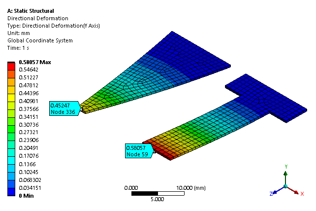

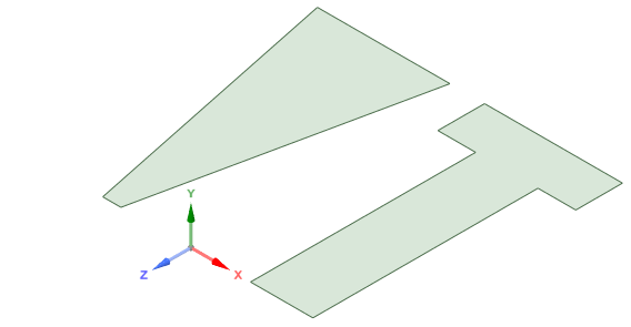

March 1, 2022 at 3:47 ampeteroznewman
SubscriberSince we are talking about using Bending Moment to decide where to increase stiffness, that implies that we are talking about loads that create bending in the beam. In other words, axial loads would not be a valid load to consider when distributing stiffness along the length.
Bolts should only see axial loads, so bolts are not a good place to apply the method of reducing bending by adding stiffness.
March 1, 2022 at 6:59 amRameez_ul_Haq
Subscriber,I mean there can be shear forces in the bolts as well, which can cause bending moment altogether in the bolt. Isn't it?
But I hope I was able to clarify my question that if boundaries, loads, contacts, materials, etc matters. Or this statement which you gave, that increasing the stiffness in a structure at the location of max bending moment will have the max impact in reducing the max deformation, was infact generic.
March 1, 2022 at 1:13 pmpeteroznewman
SubscriberShear forces are supported at a bolted joint by the friction between the two flanges. The bolt only provides the axial clamping force that squeezes the flanges together. If the shear force is larger than the limiting friction force, the joint needs to be redesigned using more bolts or larger bolts that have a higher axial force to generate a higher limiting friction force.
Consider two cantilever beams that have the exact same area, but one has a lower tip deflection for the same force.
It is too simple to say to "increase stiffness at the location of maximum bending moment". You can see that was done on the T-shaped cantilever. The tapered cantilever has lower deflection for the same weight of material.
