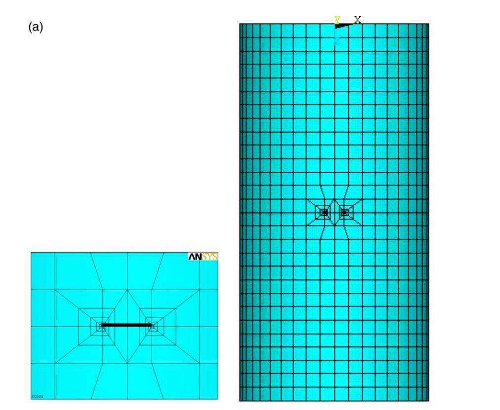

SubscriberHey all! I hope you guys are doing well. I am actually trying to replicate one of shell buckling problem from a research paper. He used ansys to assign crack seam and described crack onwards. My question is how do we assign a crack in workbench without the fracture mechaincs techniques and how do we then process Eigenvalue buckling. I am attaching the screenshot of the crack he assigned in Ansys.
I just want to simulate eigenvalue buckling for a shell with a crack. Also I dont want to introduce a crack by modelling like cutting the shell while modelling it etc type of stuff. Any kind of help would be beneficial.

SubscriberHey Aurojyoti ! I get your point. But it really doesnt answer my problem. We cant use fracture mechanics to insert crack in workbench since eigenvalue buckling isnt supported with it. So its typically a lost cause. What I want to do is to model the crack like we do in abaqus. Like we assign a crack seam and etc and then we can do linear buckling analysis too. But I cant find the option for such assignment of crack in workbench. Only fracture mechanics tool is available which again proposes the problem that we cannot then use eigenvalue buckling with it.
Can we model this type of crack in APDL? or run APDL commands in workbench to assign the crack length etc.

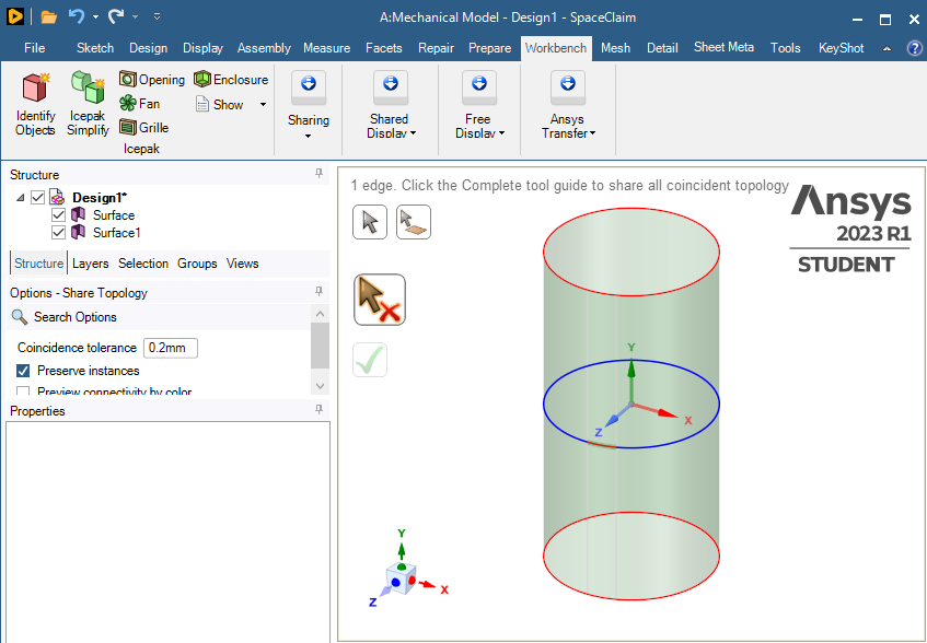

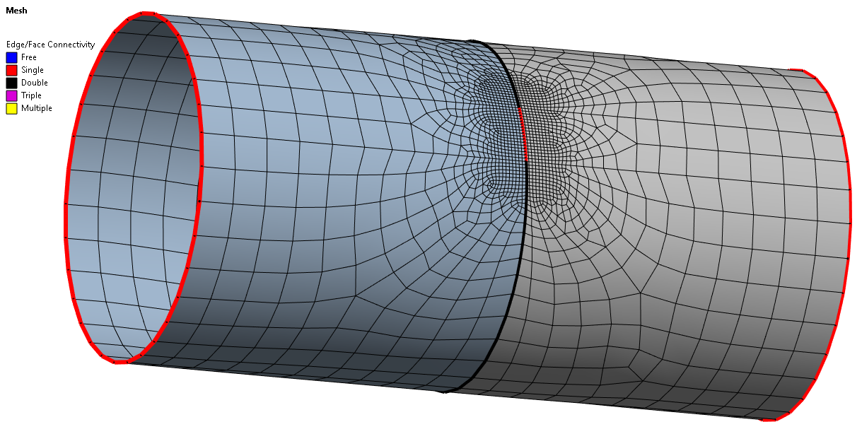

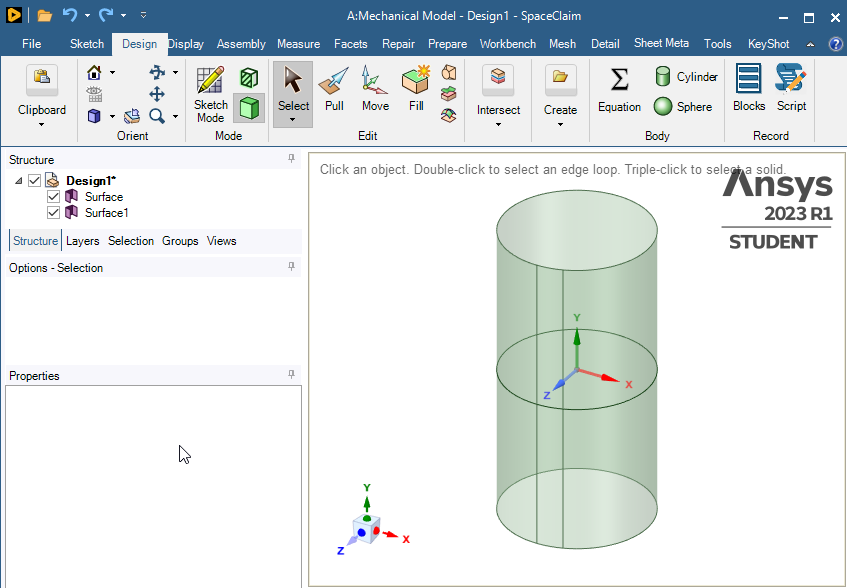

You say you don’t want to model the crack in geometry, but that is a simple way to get a pre-meshed crack. In SpaceClaim, I created a half-length tube and used 2 planes to split the face to make the crack length. I mirrored the half-tube to make the bottom half, then on the Workbench tab, used the Share button and the Exclude button to keep the crack on the surface.
In Mechanical, add a Coordinate System on each vertex of the crack length and create two Sphere of Influence type of Face Size mesh constraint on each crack tip.
