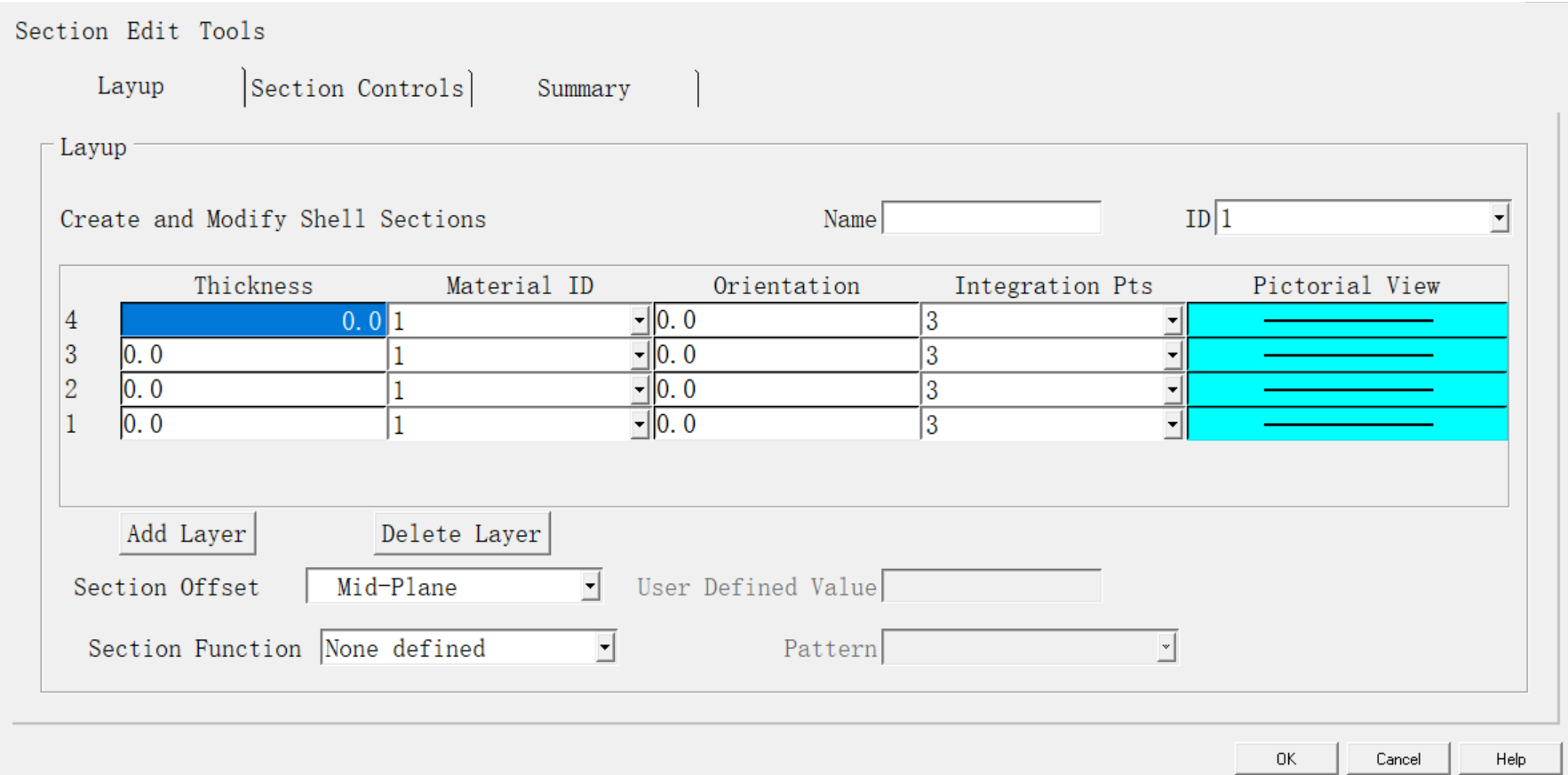

SubscriberUsing the shell 181 material model, there are four fiber layers with a thickness of 0.025m within a single-layer board thickness of 0.1m, and the laying angle of the fiber layer is [0 °, 90 °] 2. How to fill in the section edit tools. A single-layer board composed of four fiber layers laid at different angles can be obtained.

You can see the layer number in the left side (1,2,3 and 4). In the row for each layer, you can enter the corresponding thickness and the orientation(angle)
For details on section offset check – 13.2. Creating a Shell Cross Section (ansys.com)
Mid-plane considers the nodes to be at the midplane of the section
