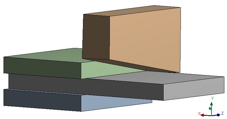

I am trying to make a cutting analysis a simple analysis, whatever i select the values in animation i couldn't see plactic deformation, the cutting edge is just end its motion by the time contact the sheet metal i think i did miss something while i make mathematical model , Can somebody help me with this thaks

SubscriberHello özkan,
I can try to help. What material model did you use for the part you want to cut? You must include a material failure model. Most materials in the Explicit Dynamics library include that. It will be easy to help you if you save an Archive of your model. That means close Mechanical, and in Workbench, File, Archive... and save a .wbpz file. You can attach that file to your post if it is < 120 MB. If the archive is too large, right click on Model and select Clear Generated Data, which will clear the mesh. Save the project, then do File, Archive... again and the file size will be smaller.

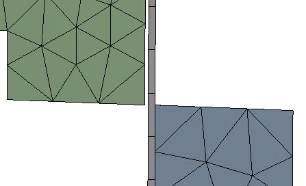

SubscriberI opened your model, the first observation is that you have only 1 element through the thickness of the plate you want to cut and there is a gap between the plate and the tool.
You can see that in my model, I have 20 elements through the thickness of the part that is being cut and the tool is touching the plate.
If your goal is to make an animation of the cutting, it will be best if you take this geometry and scale it up 1000 times. The reason for this is that the solver calculates a time step based on the dimension of the smallest element. If you check the size of my plate, it is 1000 mm thick! But it solves in about 15 minutes. If my plate was 1 mm thick like your model, it would take 15,000 minutes or 250 hours or 10.4 days to solve.

SubscriberYes you have to have contact on both sides of the sheet, which you can see in my model. But I am not clamping. I picked the back edge of the plate and added a fixed support.
Also, instead of a displacement to move the tool, I used velocity with an equation that is number*time. That means that at t=0, v=0 and the velocity ramps up over time. Your ramped displacement creates a constant velocity so that the tool makes an impact with the plate which can cause the solution to fail due to energy error.
