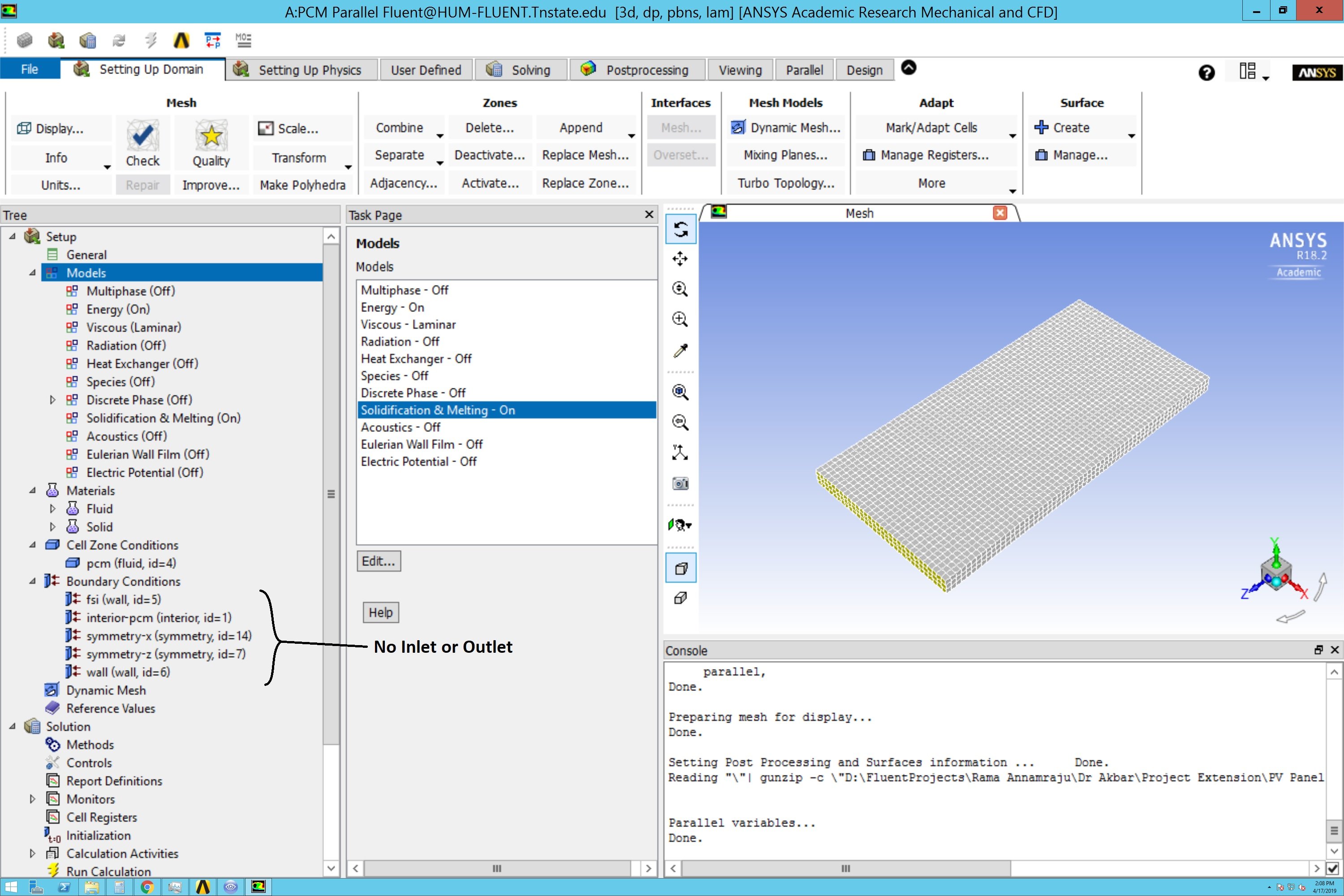

      I am trying to introduce a Phase Change Material in the bottom surface of a Solar Panel to mitigate its excess operating temperature. For that I saw one tutorial showing:
      1) How to perform solidification and Melting in Fluent
      2) Sharing the load data from fluent to steady state thermal.

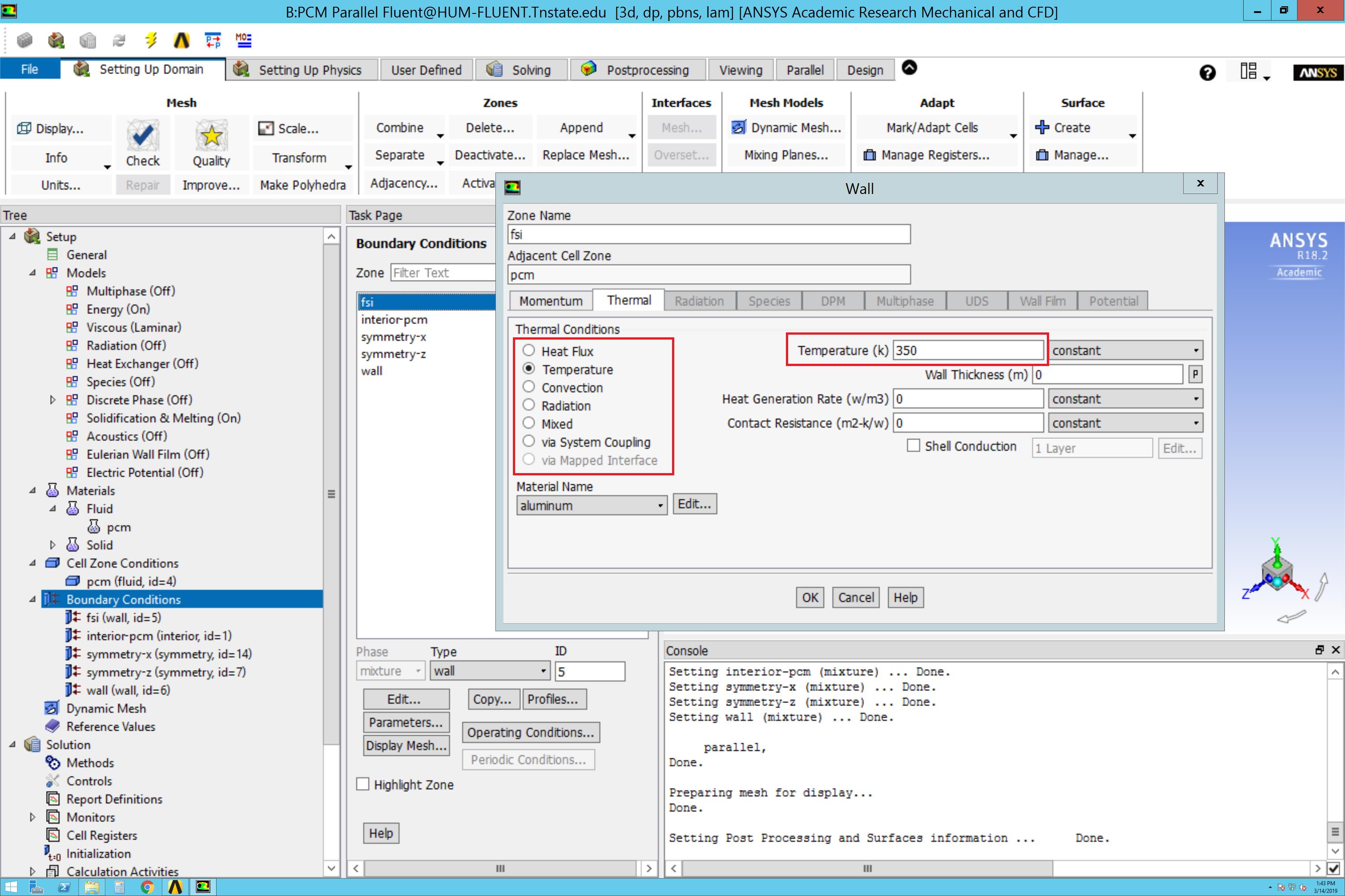

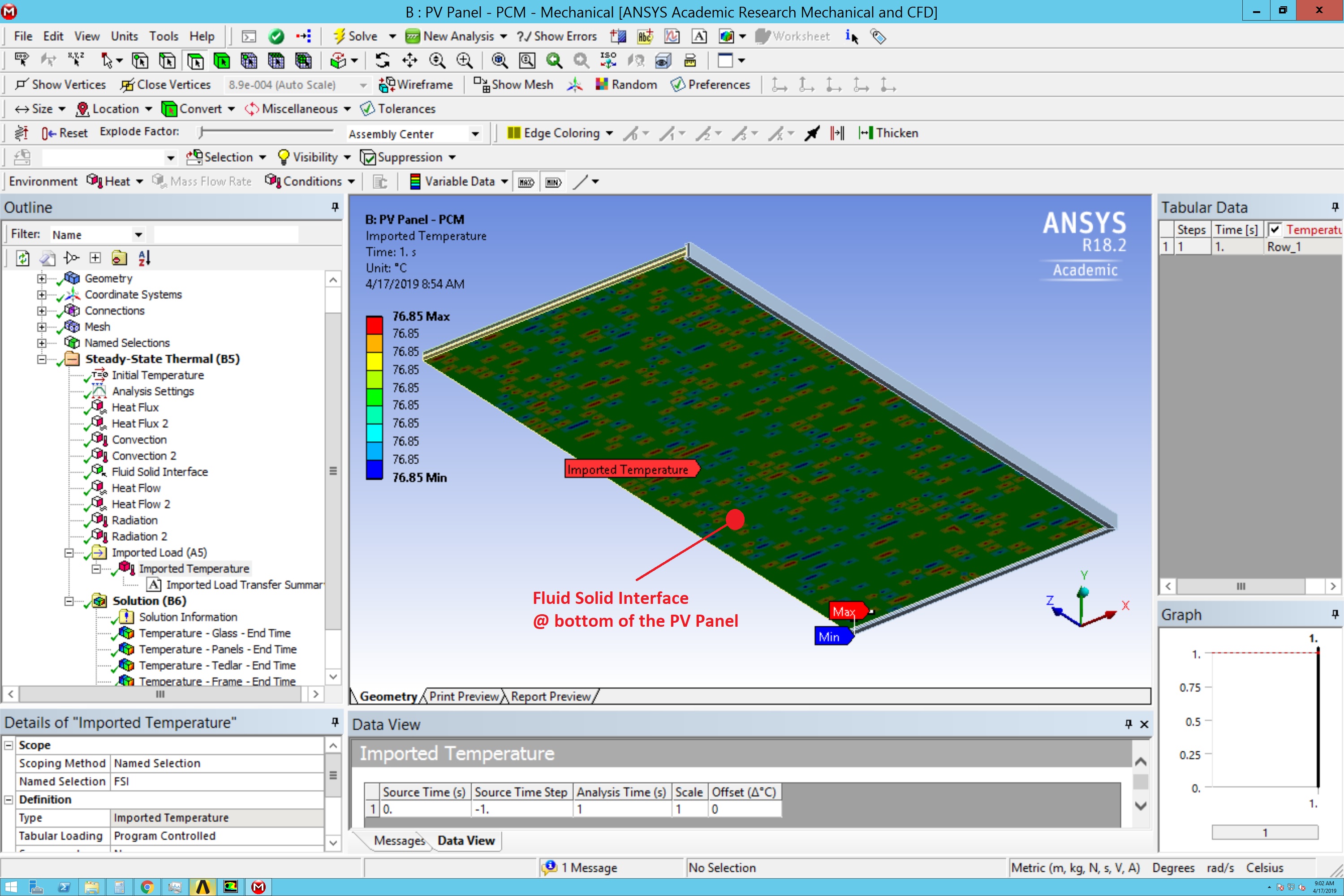

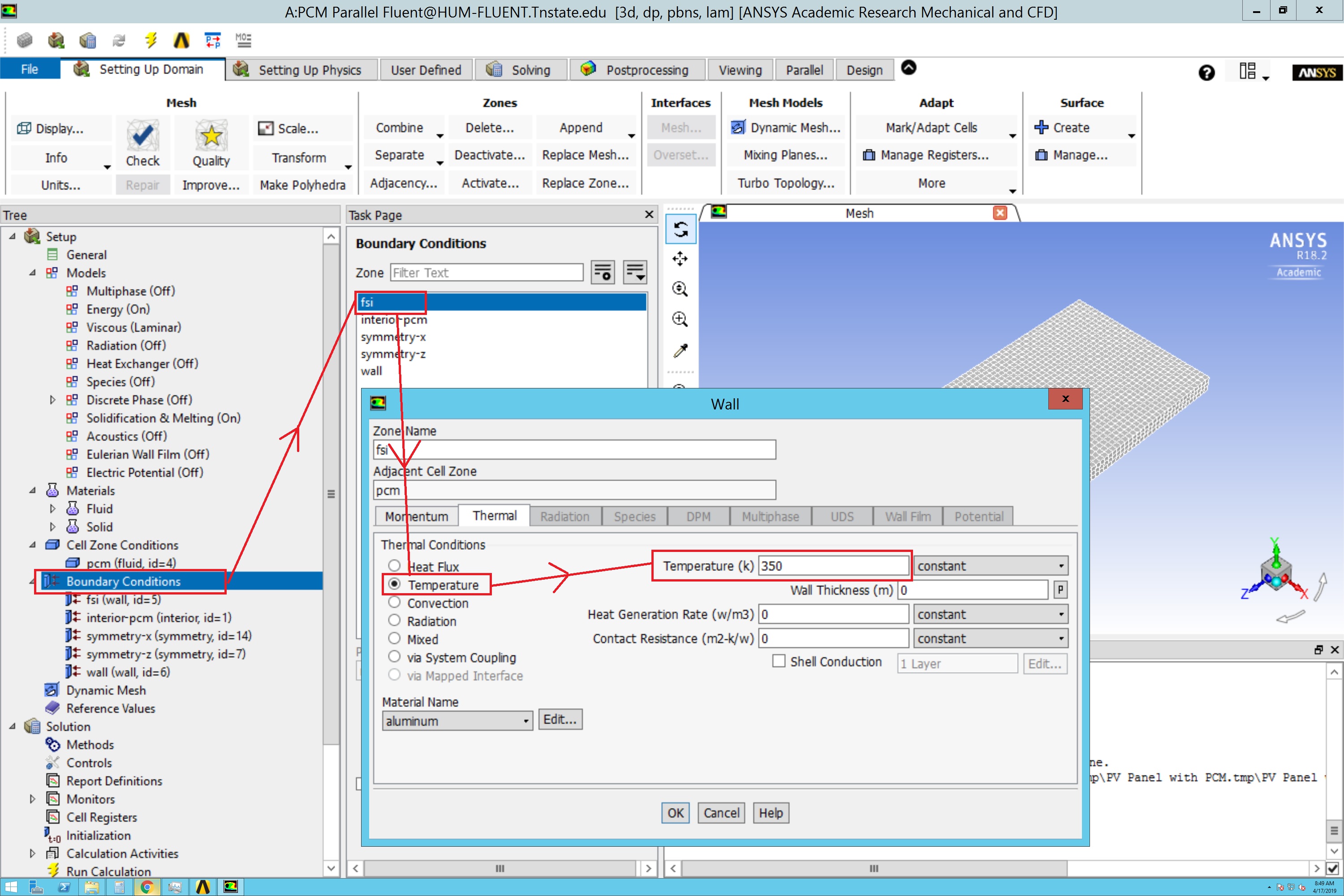

      2. In fluent I have not defined any inlet or outlet for the PCM as there is none. However the FSI temperature is derived from the Panel(Simulated in Steady State Thermal). These temperatures, we enter in the boundary conditions tab of the fluent module. I need help in defining those boundary conditions.

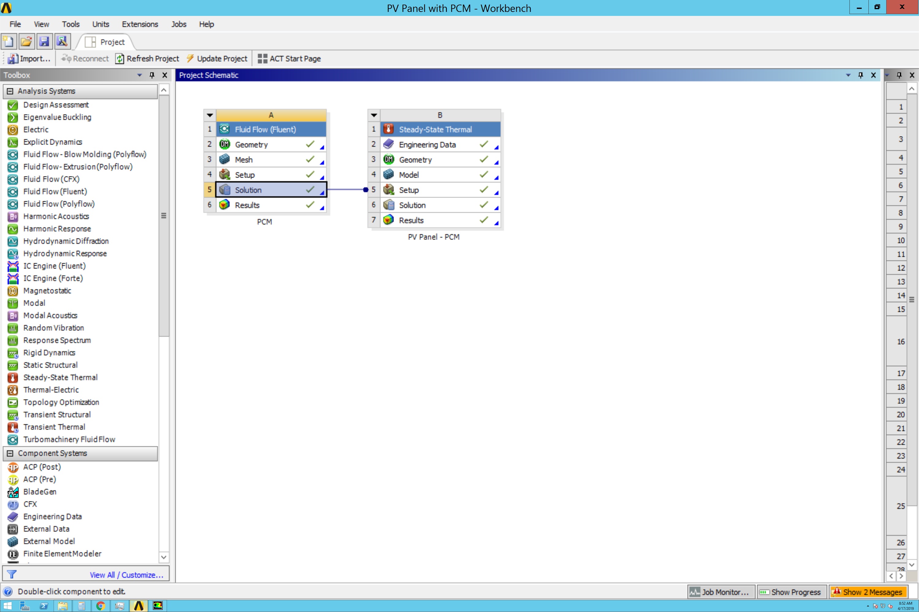

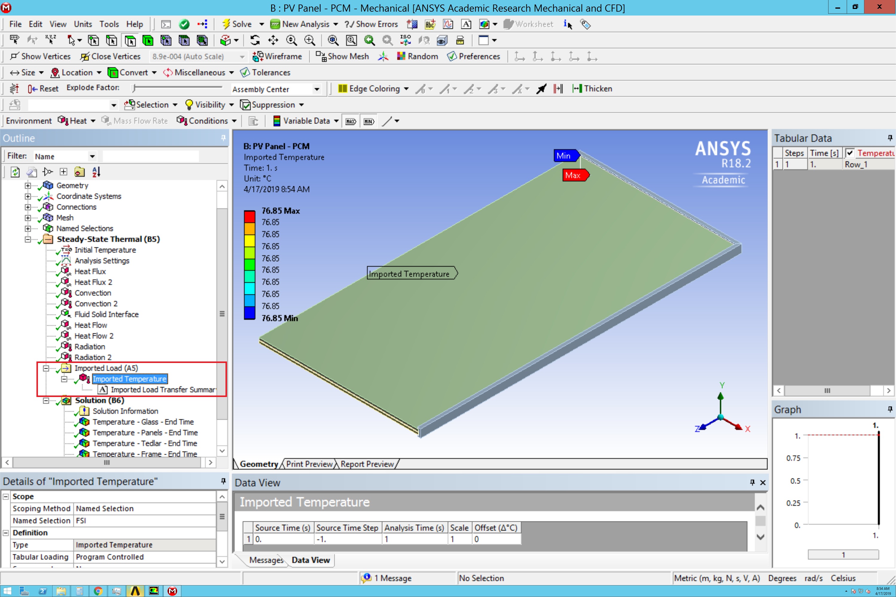

      3. I am not using coupling both the tools. I just shared the load data from the fluent module to the steady state thermal module and imported the temperature load data from fluent module.
      To give you a gist of the project. I need to obtain the temperature distribution inside a PV panel.
      a) I have modeled a standard PV panel in Steady State Thermal and applied predetermined load to obtain the initial results.
      b) then I have modeled a Phase Change Material with solidification & melting in fluent and applied the FSI temperature obtained from the thermal simulation
      c) Once the Fluent simulation is done, the load data is exported into the steady state thermal module for integration.

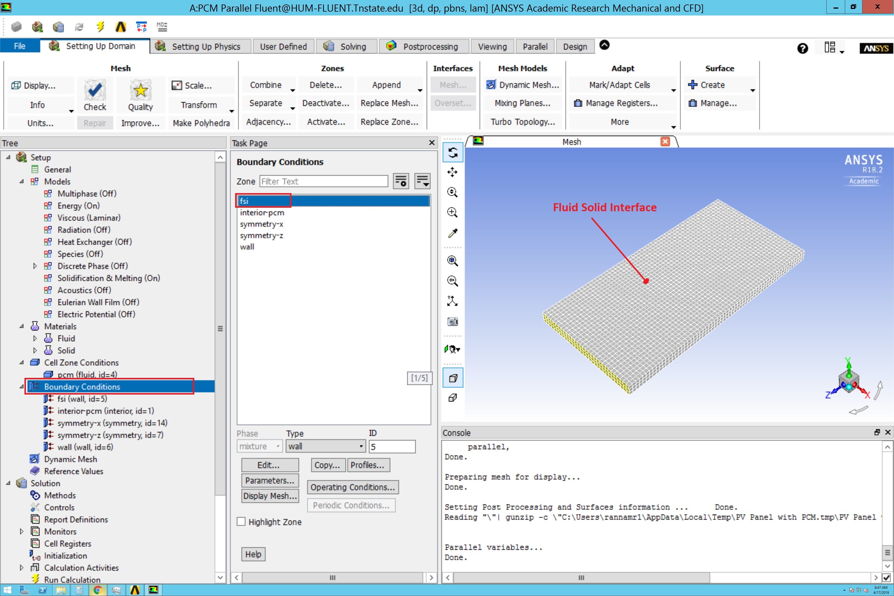

      The problem is, in Ansys Fluent when I go to Tree -> boundary condition -> fsi (wall, id=5) and open the edit window to change the temperature value. My total simulation results are changing accordingly (which is not supposed to happen)

      FSI Boundary - Fluent
      Imported Load Data from Fluent in Thermal
      FSI in Thermal

      Thank you for your elaborate response. If I understand your model, you are looking to pass thermal data (temperature) from 'Steady State Thermal' into 'Fluent' on you 'fsi' face zone. You should be able to do this using the option 'via System Coupling' from the 'Thermal' tab on your fsi face zone. You should be able to write out the data from Steady state thermal and when you set up the problem using 'System coupling', Fluent will use this temperature data and impose it on this face zone.

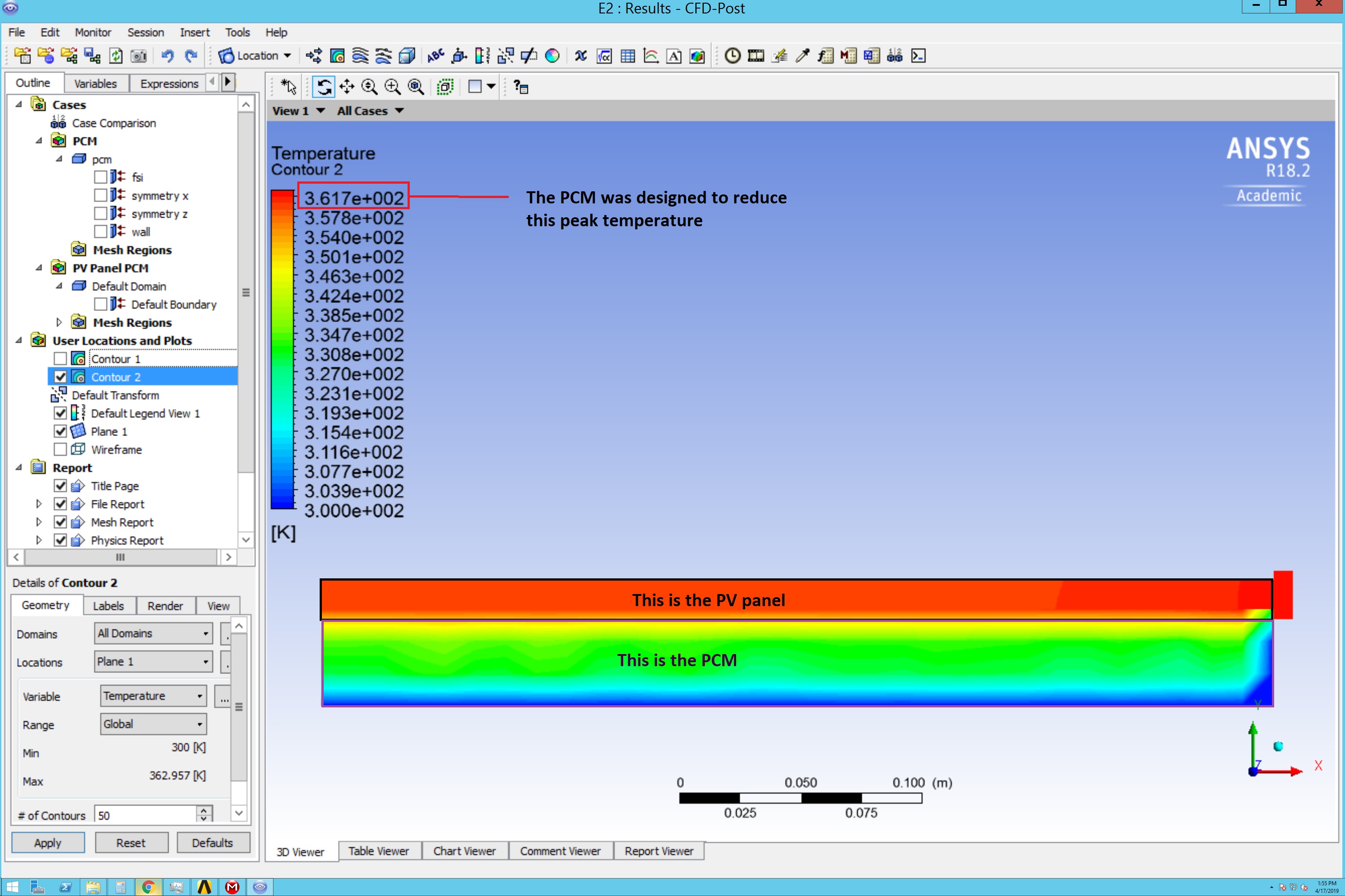

      Below is the result if I used this tutorial. However it was not what I was looking for.

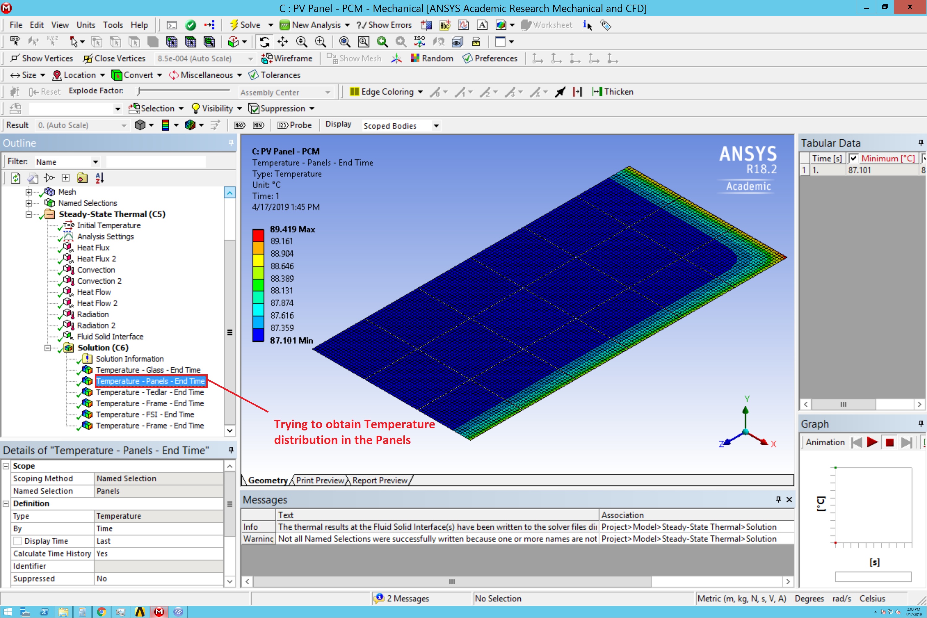

      I need the Temperature distribution inside the various components of the PV panel which can be obtained precisely using steady state thermal. I was transferring the load data from Fluent to Thermal for the same reason. See Picture below
      In any case the solidification and melting of the PCM is not happening. PCM is supposed to absorb the temperature for the PV panel and melt thus reducing the PV panel temperature. But I am unable to achieve it. Please let me know if my simulation in FLUENT is wrong. Also please note that there is no Inlet or Outlet in the PCM simulation as it is an enclosed body.

      If you are attempting to solve a conjugate heat transfer problem (with PCM phase change), I'd strongly recommend doing it all in one single tool. In your current strategy, you are solving a transient problem thermal and phase change problem in ANSYS Fluent and a steady state problem in ANSYS Steady State Thermal. You are passing data back and forth between these solvers. Instead, you could solve your entire problem in ANSYS Fluent directly (both heat transfer in the PV panel and phase change), if I understand your problem correctly. This way you do not need to worry about any manual data transfer. Fluent will take care of this for you. Is there a reason why you are attempting to do this separately? I might be missing something here.
