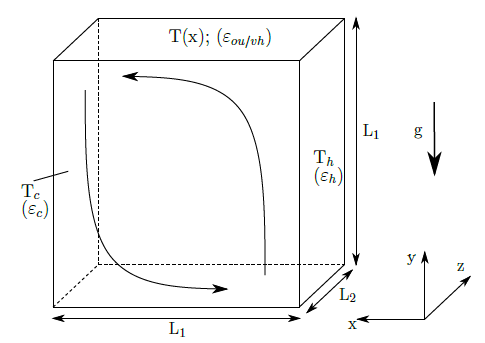

The problem depicted is a cubical cavity filled with air. The left wall of the domain is cold with a fixed temperature, the left wall is cold with a fixed temperature. Goal of this simulation is to visualize the natural convection occurring in a setup like this. The walls on top, bottom, front and back are insulated walls. The temperature difference between warm and cold wall is small, the Boussinesq Approximation therefor to my knowledge applicable. Ideally I would like to set the fluid material to air as an ideal fluid.

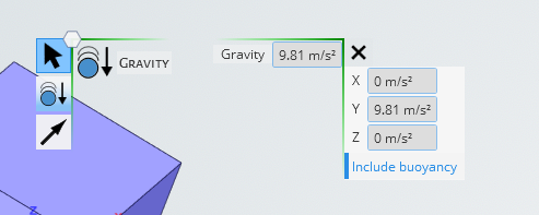

Furthermore, since buoyancy and gravity are relevant for this simulation, I was wondering what the default value for the gravity was and if it is possible to change it anywhere? Since I would like to calculate natural convection for different Rayleigh Numbers, I would like to specify a reference density and operating pressure for my system. Is there a way to implement this in Discovery? If not, what is the default operating pressure and density used in fluid simulations?

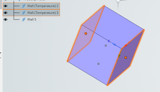

This problem is possible in Discovery Explore mode, but the accuracy of the solution might not be that well. Although, it is soon to be released in Refine mode in the next release. ÂThe left wall of the domain is cold with a fixed temperature, the left wall is cold with a fixed temperature....The walls on top, bottom, front and back are insulated walls.
This can be done by defining wall conditions and defining thermal conditions for them (with temperatures on two walls and insulated on the remaining as shown below
You can define and modify gravity by double-clicking gravity in the physics tree, and you can activate the buoyancy effect from there.

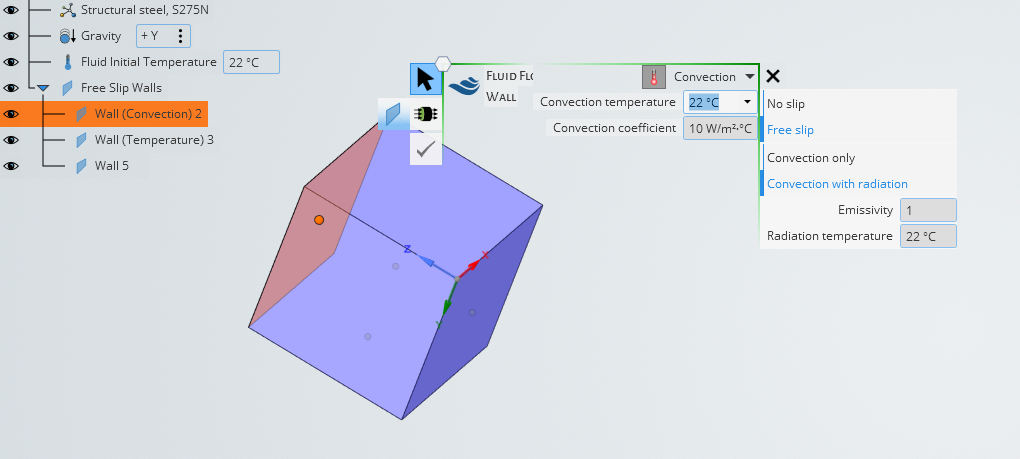

Also I was wondering if it was possible to apply an emissivity to the walls as well? I only saw this option in combination with the convection boundary condition and was unsure if setting the convection and radiation temperatures to either the cold or warm wall temperature would result in the same outcome as applying an emissivity to a wall with constant temperature.Â

That is very correct.Also I was wondering if it was possible to apply an emissivity to the walls as well? I only saw this option in combination with the convection boundary condition and was unsure if setting the convection and radiation temperatures to either the cold or warm wall temperature would result in the same outcome as applying an emissivity to a wall with constant temperature.Â
Yes, you can define emissivity, by selecting convection with radiation, which will open the option to define the wall emissivity (ε) and radiation temperature.
