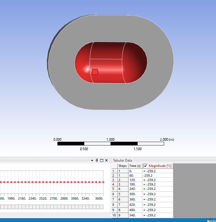

      I've been trying to model a tank system for my degree using transisnet thermal analysis. I believe I have everything set up correctley, but the issue I have is setting the inner tank temperature with insert->temperature, leads to a constant temperature. I've tried editing it but not had any sucess. I am only modelling half the tank as it is symmetrical, and I've included some screenshots of the setup below. Any help would be appreciated!
      The time steps are every 60 seconds up to one hour, as you can see the temperature defaults to staying at the -259.2 for the whole hour, when I want to see how much the temperature within the tank will increase over that period.

        I think I have posted in the wrong section, I am definitely using transient thermal, but am having issues setting up a non-uniform initial temperature

      If you have the varying time-temperature data in excel then copy and paste the data from excel in Mechanical Tabular Data for time and temperature.
