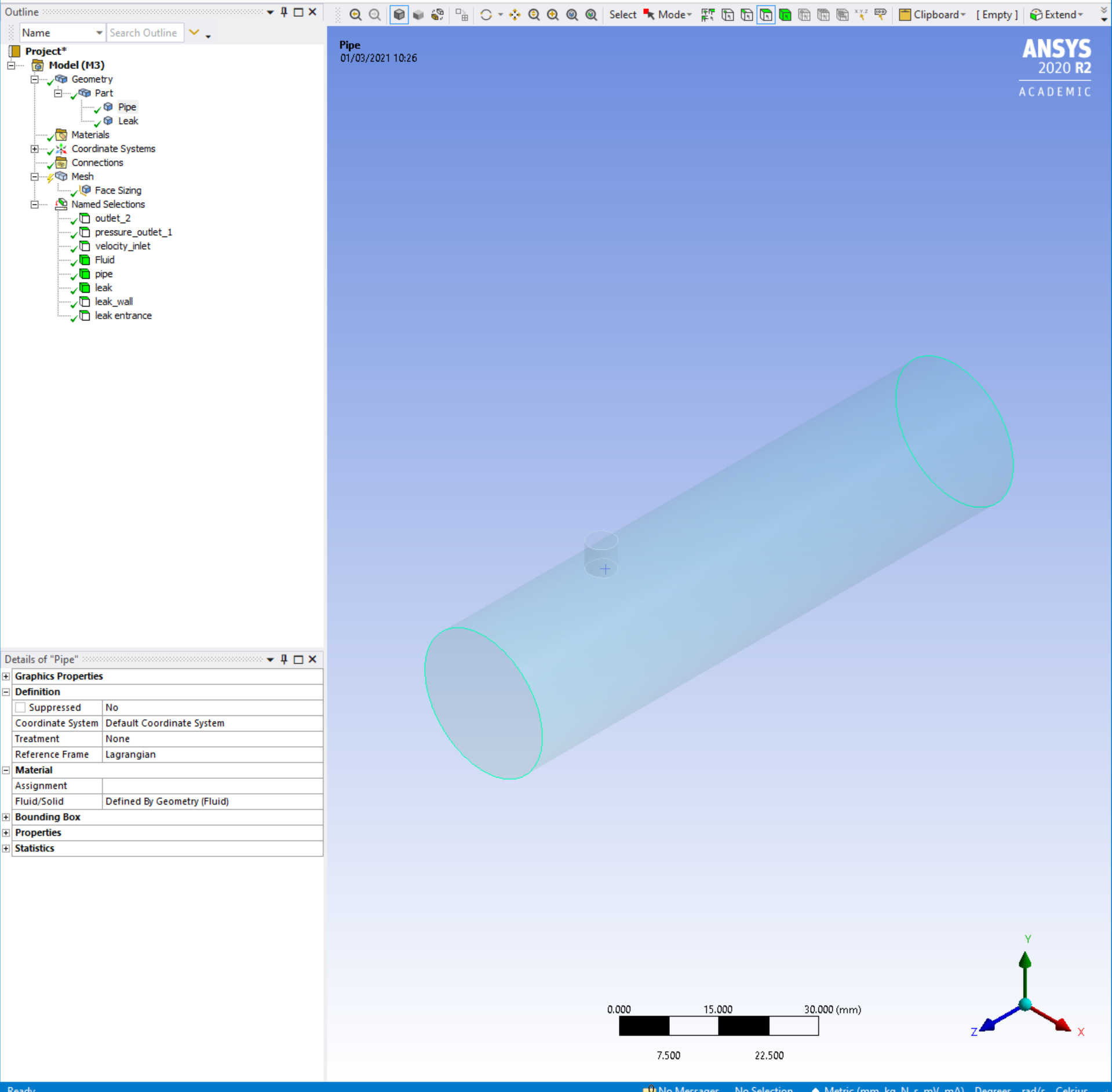

SubscriberI am modelling a leak within a domestic supply-side water pipe, and am using the Macroscopic Particle Model (MPM) to insert a particle into the pipe, which would flow into the leak due to the pressure gradient, blocking the leak. A screenshot of this geometry is below:

Forum ModeratorYou can have a mass flow outlet, but for velocity boundaries try a negative velocity magnitude or component point out of the domain. Use a pressure inlet on the other end! nViewing 1 reply thread- The topic ‘Set velocity at outlet for leak in pipe?’ is closed to new replies.
