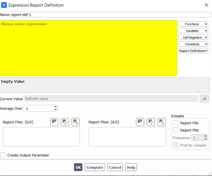

Set up a report for a cell register
    • Lugia_06
    • DrAmine
      If you are using the last version you can create an Expression based report definition where you use the cell register.n
    • Lugia_06
      Thanks ! Is there a way to create it on 2020 R1?n
    • DrAmine
      I think so. If not sure with 20R2. What is your cell register?n
    • Lugia_06
      I think I found it. Is this the one? Thank you very much!nn
    • Lugia_06
      If I want to setup the water volume integral of the droplet register, How should be syntax be paraphrased? Thanks in advancenn
    • DrAmine
      Yes that is the right one. Please check the USer's Guide for further information. Actually you start from Function where you might use the Sum and the weight will be volume:nhttps://ansyshelp.ansys.com/account/secured?returnurl=/Views/Secured/corp/v202/en/flu_ug/flu_ug_expression_syntax.html%23flu_ug_expressions_functionsn
