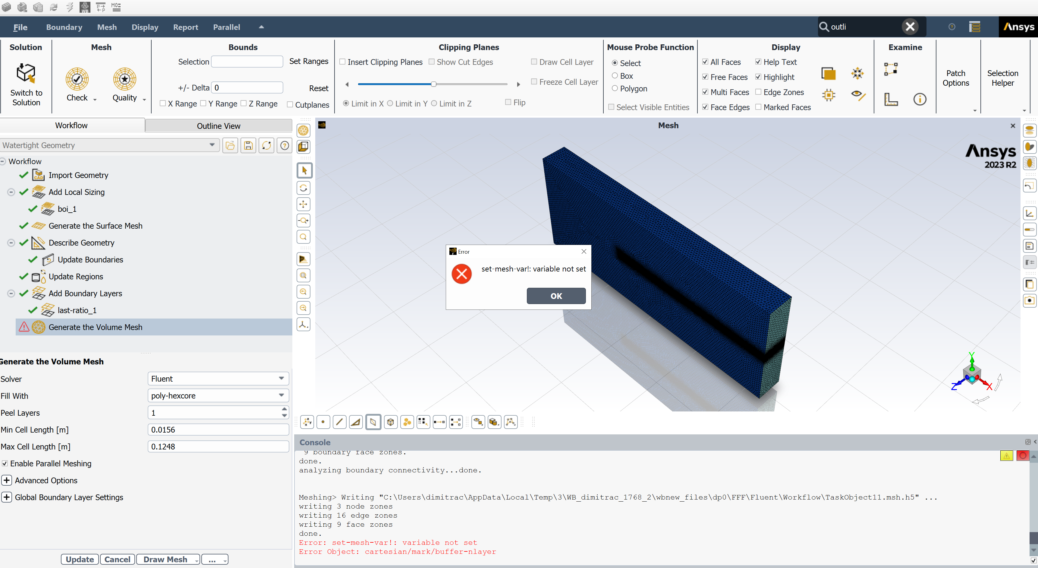

When I am traying to generate the volume mesh for my geometry I get the following error:Â
Error: set-mesh-var!: variable not set
Error Object: cartesian/mark/buffer-nlayer
I do not know how to slove this error and it is blocking any progress in my simulations.
I am using the workbench 2023 R2 with the Fluid Mechanics (Fluent with Fluent meshing) tool box.
Can someone please help?
Regards

unfortunately, this error is not really descriptive. Can you try with a different Fill-With method to see if it reproduces the error?

Volume meshing gets completed for Fill With: polyhedra and Fill With: tetrahedral but I get the same error for Fill With: hexcore and I still get the error for Fill With: poly-hexcoreÂ
Does this help with understanding what is causing the error?
