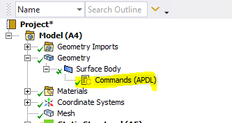

SubscriberIs there a way to set the number of integration points or change the element type (reduced or fully integrated) in Mechanical? It appears that mechanical automatcially creates 3 integration points and reduced integration Shell 281 elements when you use a quadratic mesh on a shell element. All the examples I found online use APDL commands, but is there a way to do it through the mechanical interface?

Akshay Maniyar
Ansys EmployeeHi Cody Kerr,
For surface bodies, you will have to use the command snippet to set integration points. As per the Ansys help link I shared previously, the above option is only supported for hex elements.
Thank you,
Akshay Maniyar
May 9, 2023 at 11:51 am
Cody Kerr
SubscriberI can't get MAPDL to open but I didn't know about command snippets, that is exactly what I was looking for thank you! Do you know where I would input the Sectype command to set the number of integration points? After the mesh?
