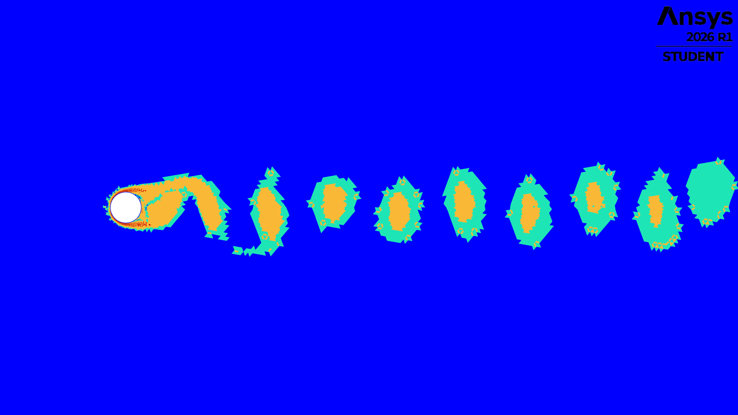

      I am using automatic mesh refienemt with the refinement/coarsening criteria specified above. In the first time step I apply manually the refinements in order to have the desired mesh refinements at the start of the next iteration and concentrate the cells at the high vorticity regions. The image below shows the cell refinement level in the domain at time step 1 (blue = lvl 0, cyan = lvl 1, yellow = lvl 2 and red is lvl 3):
      Now this is time step 25, as you can see the vortex core start to get closer and closer and the coarsening step isn't working
      Beyond a certain time step (around 100 time steps) the mesh clusters merge and the mesh starts to be constant. The image below is time step 500. It is also relevant to mention that the mesh patterns from time step 1 are kept and you can clearly identify where the mesh was refined initially.
      Can someone explain to me why this is happening in such a simple scenario?

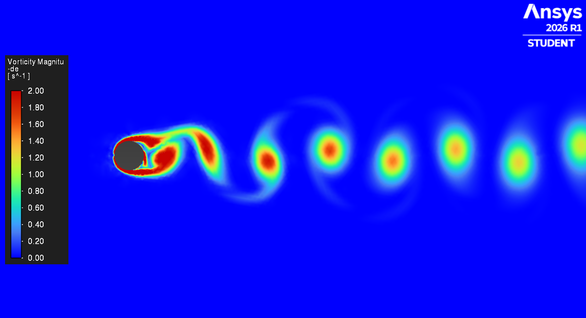

      I have tried playing with the refinement levels but the number of cells increase way too much but i don't think that my issue comes from there. I would like to have only up to 3 levels of refinement which seem logical to me (one for almost zero values (blue), low values (cyan), intermediate values (orange) and high values (red) as shown in this image at the time step 0 which should capture fairly well the flow features:
      Which corresponds to this flow scenario, so there should be clear mesh refinement gaps between vortex and not the continuous refinement sheet that advances with the vortex as shown in my previous reply:
      For more context I am leaving here the exact refinement settings that I am trying:
      Cell registers (6 in total):
      L1_ref -> field: vorticity-mag -> more-than: 0.20
      L1_coa -> field: vorticity-mag -> less-than: 0.18
      L2_ref -> field: vorticity-mag -> more-than: 1.25
      L2_coa -> field: vorticity-mag -> less-than: 1.00
      L3_ref -> field: vorticity-mag -> more-than: 5.00
      L3_coa -> field: vorticity-mag -> less-than: 4.00
      Note that a value range gap is kept intentionally to avoid mesh flip-flop refinement near the limit values.
      Automatic mesh refinements (3 in total):
      AMR_L1 -> frequency:1
      AMR_L1 -> refinement_expression: AND(AMR_L1_ref,CellRefineLevel<1)
      AMR_L1 -> coarsening_expression: AND(AMR_L1_coa,CellRefineLevel>0)
      AMR_L2 -> frequency:1
      AMR_L2 -> refinement_expression: AND(AMR_L2_ref,CellRefineLevel<2)
      AMR_L2 -> coarsening_expression: AND(AMR_L2_coa,CellRefineLevel>1)
      AMR_L3 -> frequency:1
      AMR_L3 -> refinement_expression: AND(AMR_L3_ref,CellRefineLevel<3)
      AMR_L3 -> coarsening_expression: AND(AMR_L3_coa,CellRefineLevel>2)
      If I understand correctly the following logic should apply:
      • A cell that has a vorticity value of 8 s-1 and hasn't been refined yet (CellRefineLevel==0), should be refined 3 times on that time step because it is affected by the three automatic refinement.
      • A cell that has a value of 0.15 s-1 and CellRefineLevel=1 will be coarsened once (affected by AMR_L1)
      • A cell that has a value of  1.5 s-1 and CellRefineLevel=1 will be regined once by AMR_L1 and AMR_L2 as it has reached it'smaximum refinement level allowed by these 2 automatic methods. (Or maybe here is my problem that it will be refined twice as both methods are triggered)
      Are my rules interpretations correct? Or is there any other appropiated good practice to apply in this scenario?
