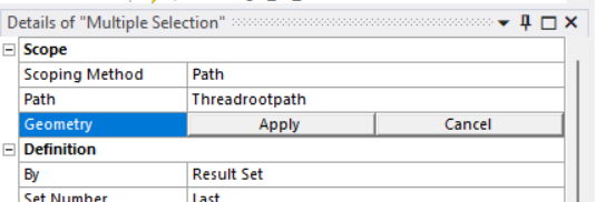

      i want to generate a Result for a Path from the Construction Geometry ("Threadrootpath") with a Python Script. The path touches several bodies, but the evaluation should be done only on certain bodies ("body_selection"). The picuture shows the function from the GUI of Ansys Mechanical, that i want to use by the Script but i cant find any documentation for the correct command. Can anyone help me?

      Hi This post shows how to do this: https://discuss.ansys.com/discussion/2491/how-to-set-path-and-geometry-scoping-when-defining-result-object-with-path-as-the-scoping-method All the best Erik
