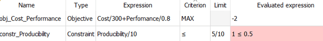

Instead, I would recommend scaling the components of the objective function to the same order of magnitude. Here you see an example:
If you do not scale it, the optimizer will tend to improve the component of objective with the larger numerical value. After scaling, the objectives have a rather equal importance.
