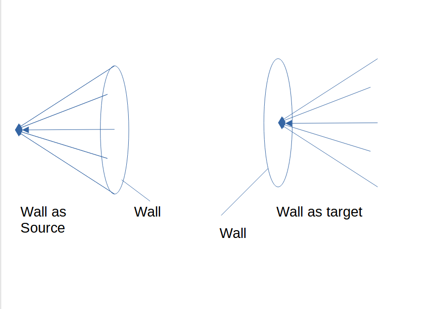

      Hello I am trying to understand how the semi transparent wall boundary condition works. After reading the manual I did not get it much. Does it model the wall as the radiation source (left drawing)?. Or does it model the wall as the target of the incoming beam? (right drawing)

      Hello If you are using the Beam settings on a semi-transparent wall, your wall will be acting as the source (and not the target). All of the beam irradiation will originate from this semi-transparent wall.
