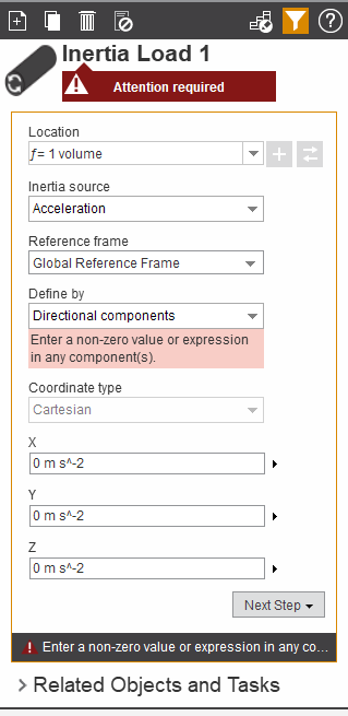

      If I don't include any force, displacement, etc., then shouldn't the results (stress and deformation) be computed due to self weight?
      I tried to do this but it didn't work. Please guide on how to solve for self weight.
    • Charudatta Bandgar
      Hello calvintan , For gravity load to be considered, you will have to use inertia load and apply the gravity accordingly. Regards.
      • productdev
        Charudatta Bandgar Thank you for your answer. Just wanted to confirm another thing: we can add the add the whole assembly in Location or we have to apply load individually to components?
