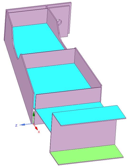

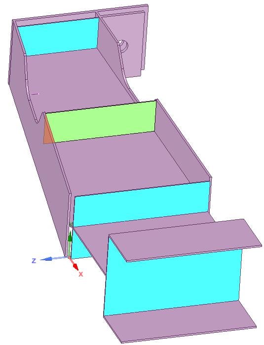

      I see you have a thin walled body with at least 3 different wall thicknesses: 15, 25 and 50 mm, and you have some extra bodies that are different thickness such as 55 mm.
      Filling a thin walled solid body with tetrahedral elements is a poor way to make a model. It requires too many elements and might lack accuracy in the results.
      It would be much better to replace the the solid body with a collection of surfaces. Each surface is meshed with shell elements that can be assigned the correct thickness.
      Here are the 50 mm walls
      Here are the 25 mm walls
      Here are the 15 mm walls
      The 55 mm wall that joins a 15 mm and 25 mm wall could be left solid or you can just lose the tapered section in this simplified model.

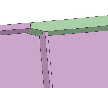

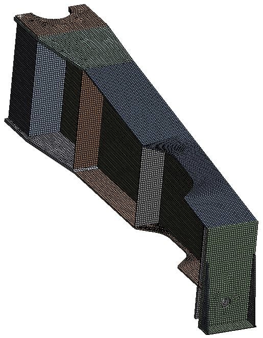

      Hi Simi,
      I looked at your geometry again. If you delete all the operations you made to the imported geometry and set Shared Topology to None on all the parts, then you get almost all the bodies being sweepable.  Therefore, you don't need to do a lot of slicing and dicing. With this approach, you will need to add Bonded Contact to connect the meshes together.
      Attached is an ANSYS 19.2 archive that changed the Mesh to force 2 elements by using the Proximity set to Yes and 2 elements across the gap. That makes a more dense mesh than shown below that was created with the Proximity set to No.
