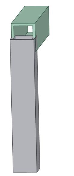

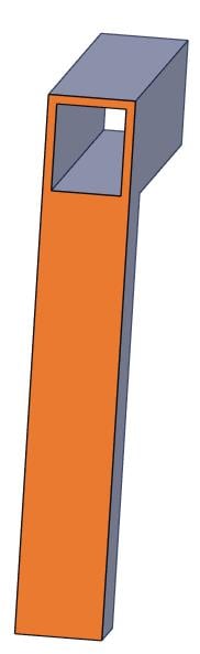

      Thank you for the suggestion. I created another L beam with different dimensions and noticed something. I made the cross sectional area the same for both beams at first and I was able to successfully extract the beams. I then made the cross sectional area of one beam slightly larger, which is actually representative of my model, and again I was met with the same "failed to extract 2 beams" error. Also notable, now its "failed to extract 2 beams" rather than "failed to extract 3 beams" as the error appeared in my model.
      I attached the L beam which is showing the error.

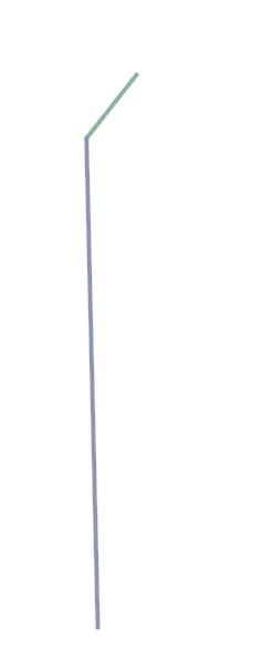

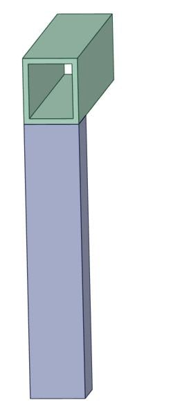

      This solid body breaks the rule I described above. Each beam must be a pure extrusion of one end face.  Look at the orange face. I created a plane on the underside of the top tube and used Split Body to create two separate bodies. Now you can extract two beam. However, since the beams are welded together, I would pull the vertical tube end face up 6 mm to the midpoint of the top tube and pull the top tube back 5 mm as shown in the third image. Now the end points of the two beams meet at the same coordinates and will be easy to "weld" together by using the Share button on the Workbench tab (last image).

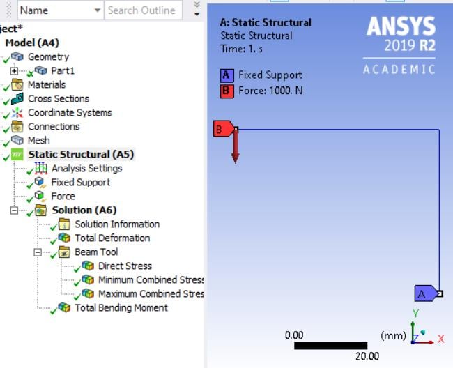

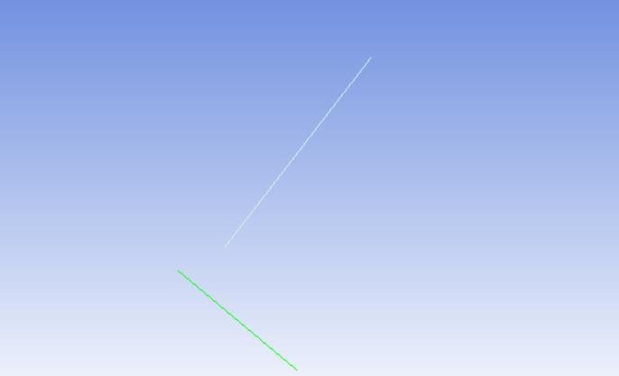

      In mechanical, are the meshes for both beams supposed to combine to effectively create an L shaped mesh? Because it looks like a mesh was just created for each beam separately and not combined. The meshes do instersect each other, but they seem to be seperate; for example, each mesh also has different colors.
      Also, mechanical is acting weird. I applied a fixed support and force to the line bodies and tried to solve, but got a solver error: general error. Then I retried and eventually mechanical closed. Now when I re open mechanical, the configuration of the line bodies as shown below are not connected as they appear in space claim. I have opened the geometry in spaceclaim and the line bodies are still connected. I'm going to try closing and opening workbench.
      The welding occurred when you clicked the Share button on the Workbench tab in SpaceClaim.
      The Fixed Support goes on a Vertex, the force can go on a vertex for a tip load or a line body for a distributed load.
