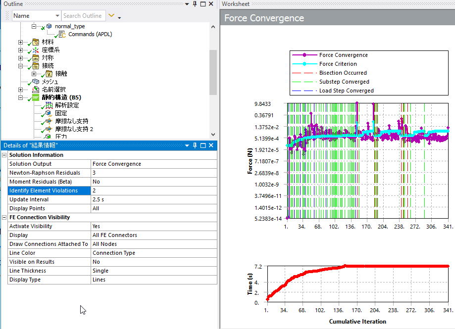

I watched the YouTube link you shared, but I’m still struggling with the issue of element distortion during large deformation analysis.
To investigate the problem, I checked the Newton-Raphson residuals, but I’m not sure how to use this information to resolve the issue. Whenever I identified distorted elements, I refined the mesh locally, but this did not solve the problem.

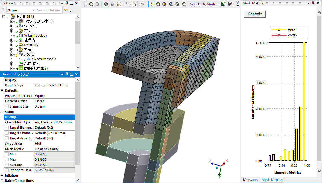

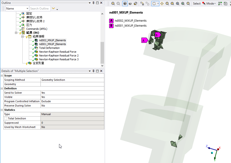

SubscriberI looked at your model and ran the B analysis on Normal -0.05 MPa spead out over 10 steps in 10 seconds. It failed at t=7.2 with highly distorted elements. Under Solution Information folder, you should set some non-zero values for Newton-Raphson Residuals and Identify Element Violations. The later will create a plot showing where the distorted elements are.

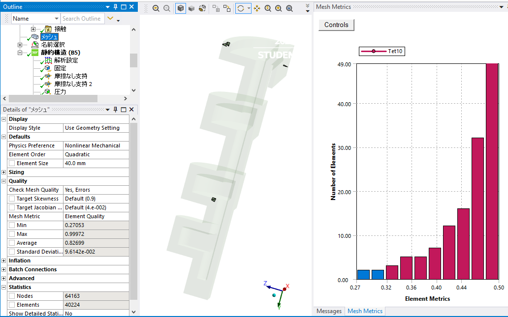

If you check the element quality metric, you can see where the low quality elements were before any distortion was added by the load.
You see that some of the low quality elements in the mesh are the same ones that produce element quality violations.
The corrective action is to create a higher element quality mesh. One way to do that is the slice the geometry up into easilty meshable shapes and use the Share button in SpaceClaim so that you can get a high quality hex mesh. -
