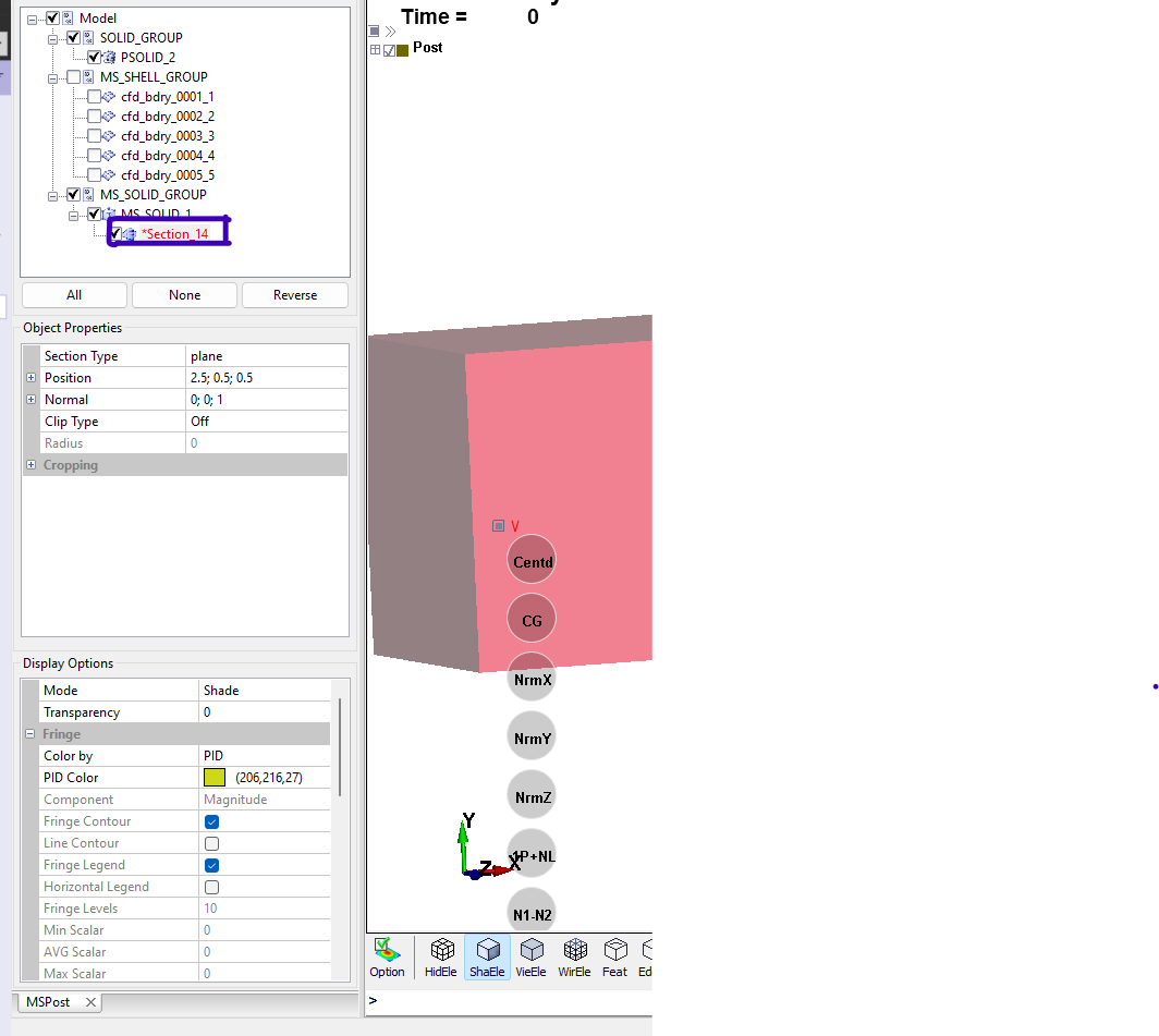

SubscriberHi, I am attempting to complete the ICFD tutorials (i.e
&list=PLhM9_Av_eh25gP8R5GltI4gqzwWmgjsBU&index=3 , &list=PLhM9_Av_eh25gP8R5GltI4gqzwWmgjsBU&index=4) but whenever I attempt to create a section plane as per the instructions in the videos, the section is in red with a *, like it's undefined. I have completed all the required fields (position, normal, section type, even attempted to change clip type), but there's no change. I am unsure what is wrong, and I cannot view the results of the simulation without sections. Is there something I am missing?Â
September 7, 2023 at 11:13 am
Cristina Teleanu
SubscriberNevermind, I have literally just figured it out. If anyone has the same issue, just right-click again on the section and click Update.Â
