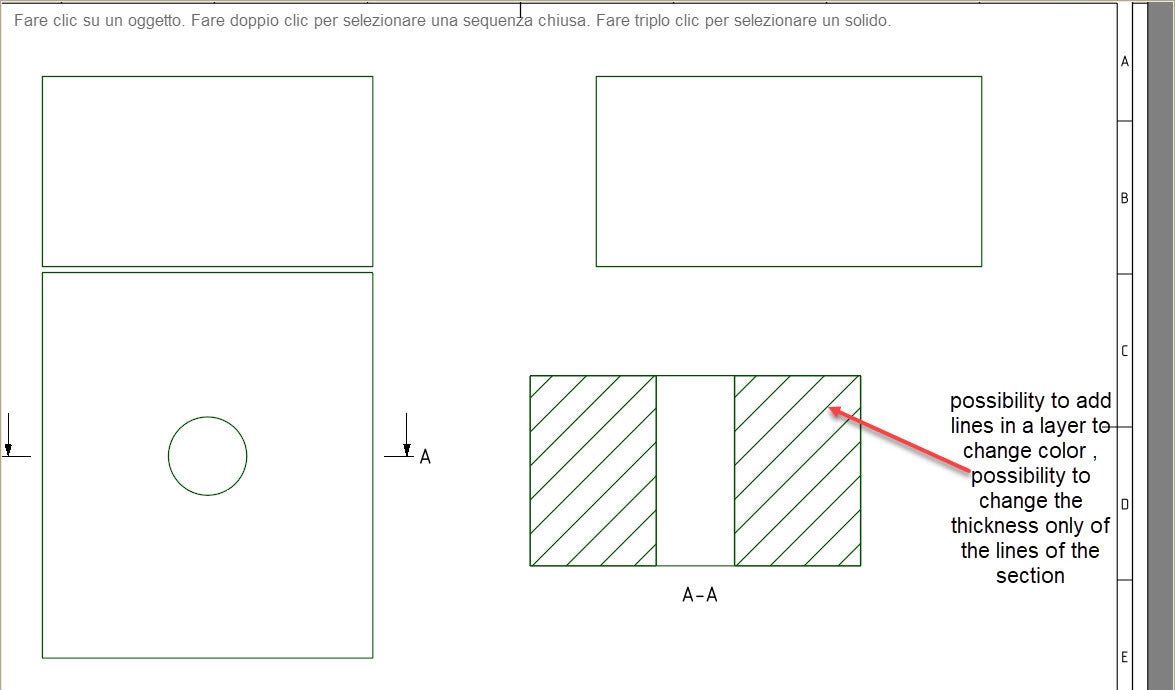

      Hello
      is it possible to change only the thickness of the crosshatch from the SpaceClaim settings?
      is it possible to inherit the crosshatch in a level?
      Best Regards
    • Roberto
      I insert an image to make me understand better

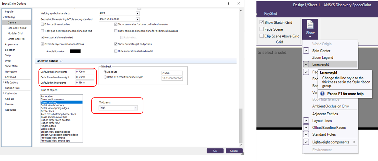

    • Charudatta Bandgar
      Hi Robert
       Yes, you can change hatching line thickness in SpaceClaim options (File>SpaceClaim options> Detailing-General) as shown in figure below. To see the lineweight you need to check ‘lineweight’ option in Display>Show. The lineweight can be changed between thin/medium/thick and the lineweight values (in mm) can be changed as per your convenience.

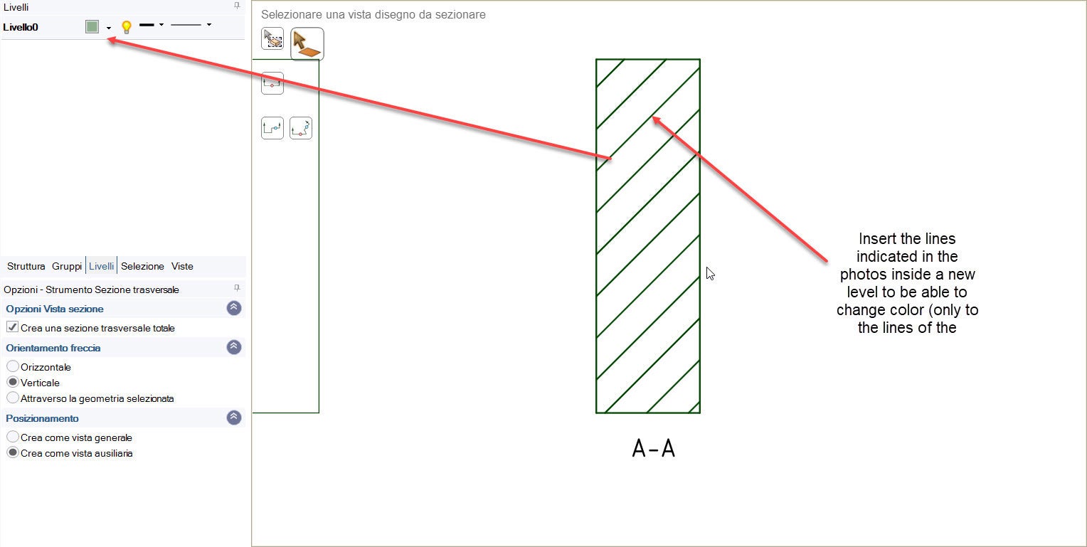

       I'm not sure if I understand what you mean by ‘Inherit cross hatch in a level’. Can you please explain in detail (if possible, with a screenshot) about what your requirement is?

        Hello ,
        Thanks for the answer you helped me
        For the second question I am attaching a photo
        Best Regards
      Hello Robert ,
      It is not possible to have cross hatching as separate layer (level). I would encourage you to suggest it in Idea section.
      We thank you for sharing your feedback. We will share your idea/input with the product development team.
