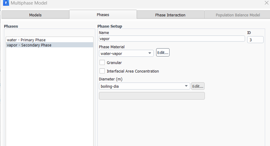

SubscriberHi everyone I am tring to find gheat flux around horozontal tube during pool boiling.Â
I am selecting Secondary Phase - Vapor and one section is displayin as diamate (m), could anyone explain this one ?ÂThere is boiling-dia as well, is that same with bubble diamater ? because in boling I am selectiong ''Tolubinski and Kostanchuk''.

Forum ModeratorHave a look in the Phase Interaction options, there are some more options in there. It's all covered in the documentation, Â https://ansyshelp.ansys.com/account/Secured?returnurl=/Views/Secured/corp/v232/en/flu_th/flu_th_sec_boiling.html
