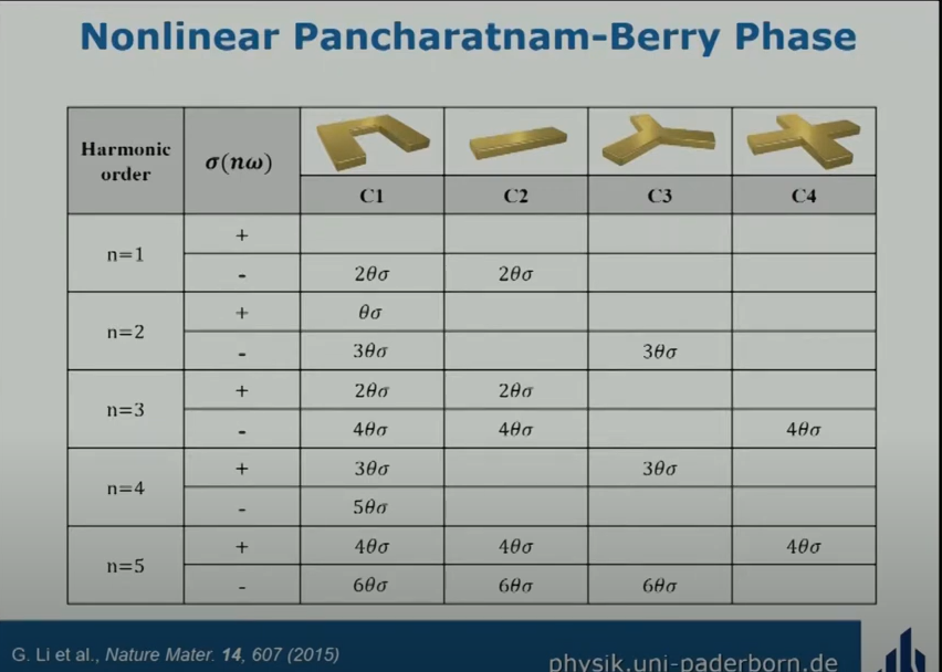

I am trying to study geometric phase in non linear optical process. For example:
Essentialy we have a wave and a non linear material with different shape and we study the phase of the second harmonic wave (with different polarizations) as a function of the rotation of the material.
My question is: how much is reliable Ansys to study a problem like this?
For example I am testing selection rule for non linear optical process:
I have a material with C2 symmetry. The fundamental wave has right circular polarization (RCP). For the harmonic order n=1 I have the same results of the theory, no wave with RCP and a generated wave with LCP with the phase indicated, where theta is the rotation angle of the metastructure.

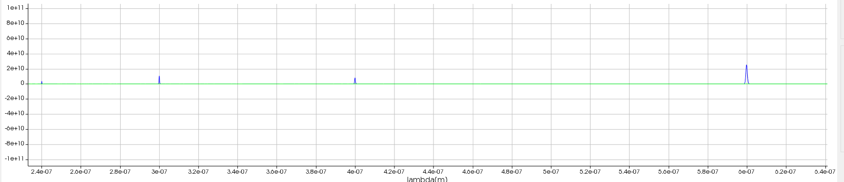

But If I study the spectrum for the other orders with a initial wavelength of 1200 nm:
I see that there is also the harmonic order n=2 that is not expected considering the theory.

Ansys EmployeeIt seems such material and physics can be included in FDTD. thus the simulation accuracy depends on the mesh, PML and other settings.
For higher orders unexpected, it is because the amplitude of the origial signal is too high. you can either reduce the source amplitude, or reduce non-linear coefficient. Theory usually have assumptions. even with perturation chi*E2 is small, it does not guarantee no higher orders can occur.
