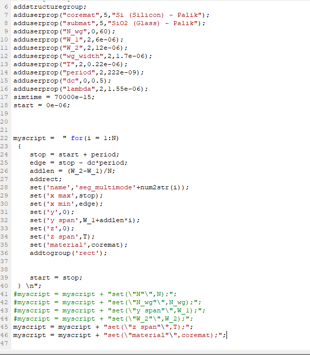

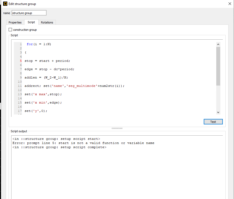

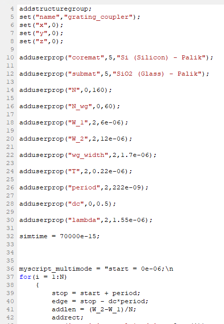

Thanks for sharing more information. Would you be able to copy and paste the script (instead of screenshots) in your response? This would allow me to test the script much faster.Regards,
Amrita -
July 26, 2023 at 10:49 pm
minusunny

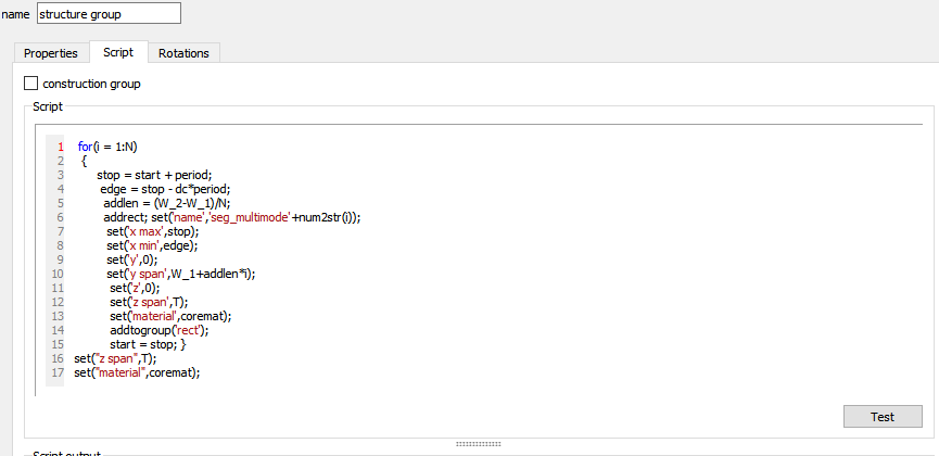

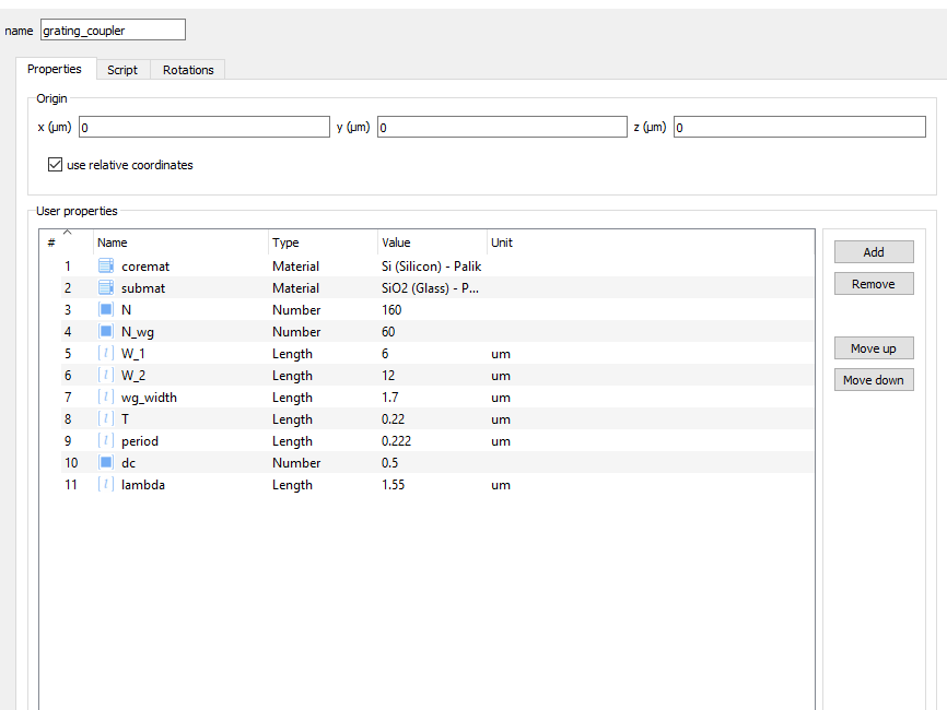

Subscriberaddstructuregroup; adduserprop("coremat",5,"Si (Silicon) - Palik"); adduserprop("submat",5,"SiO2 (Glass) - Palik"); adduserprop("N_wg",0,60); adduserprop("W_1",2,6e-06); adduserprop("W_2",2,12e-06); adduserprop("wg_width",2,1.7e-06); adduserprop("T",2,0.22e-06); adduserprop("period",2,222e-09); adduserprop("dc",0,0.5); adduserprop("lambda",2,1.55e-06); simtime = 70000e-15; start = 0e-06; myscript = " for(i = 1:N) { stop = start + period; edge = stop - dc*period; addlen = (W_2-W_1)/N; addrect; set('name','seg_multimode'+num2str(i)); set('x max',stop); set('x min',edge); set('y',0); set('y span',W_1+addlen*i); set('z',0); set('z span',T); set('material',coremat); addtogroup('rect'); start = stop; } \n"; #myscript = myscript + "set(\"N"\",N);"; #myscript = myscript + "set(\"N_wg"\",N_wg);"; #myscript = myscript + "set(\"y span"\",W_1);"; #myscript = myscript + "set(\"W_2"\",W_2);"; myscript = myscript + "set(\"z span"\",T);"; myscript = myscript + "set(\"material"\",coremat);"; -

Ansys EmployeeHi,
Thank you for sharing your code. Here is the modified version. Please let me know in case it does not work.
addstructuregroup;
set('x max',stop);
set('x min',edge);
set('y',0);
set('z',0);
set('z span',T);
myscript = myscript + "set(\"z span\",T);";
myscript = myscript + "set(\"material\",coremat);";
set('script',myscript);
Amrita -

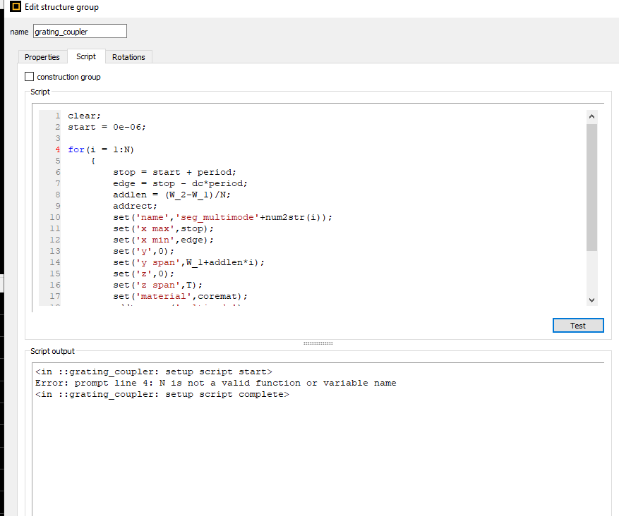

Amrita Pati
Ansys EmployeeThat is beacause you haven’t assigned any value to N before using it in the for loop. I also do not see N being input as a user property in the code.
AmritaÂ

minusunny
SubscriberI figured it out. It was indentation error
