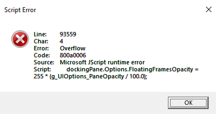

I faced a script error when launching mechanical as shown below.
There is nothing in the mechanical. What is the cause of this error? How can I recover the my mechanical?
By the way, there is no such issue in Spaceclaim, ANSYS version 2021 R1.
Thanks in advance!

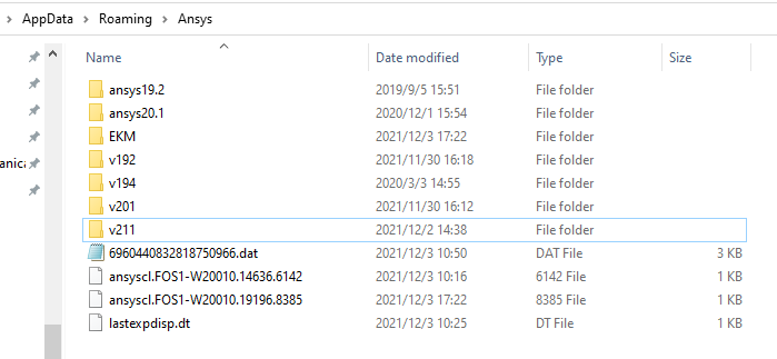

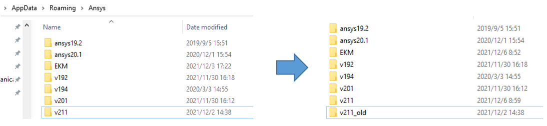

See if renaming the relevant 2021 R1 or R2 (not sure which version gives this issue).
Just type this: %APPDATA%/Ansys
in file explorer and rename the problematic version (say 2020 R2 : called 202 to 202old) as shown below:
Hope this helps.
Erik
December 3, 2021 at 9:38 amDecember 3, 2021 at 10:30 amErKo
Can you rename that v211 folder to v211_old and see if this still happens.
Thank you
Erik
