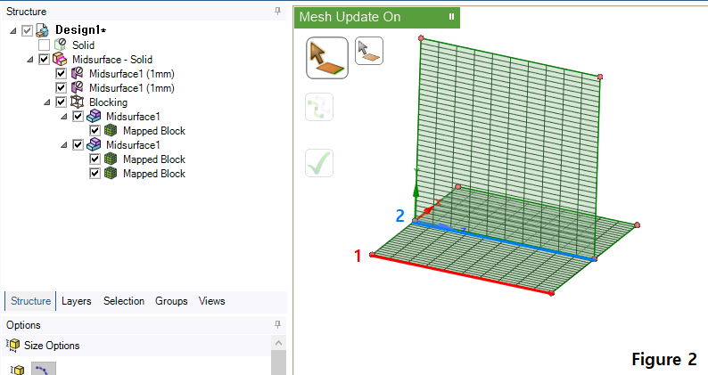

I found the problem with SCDM Meshing and I don't know why.

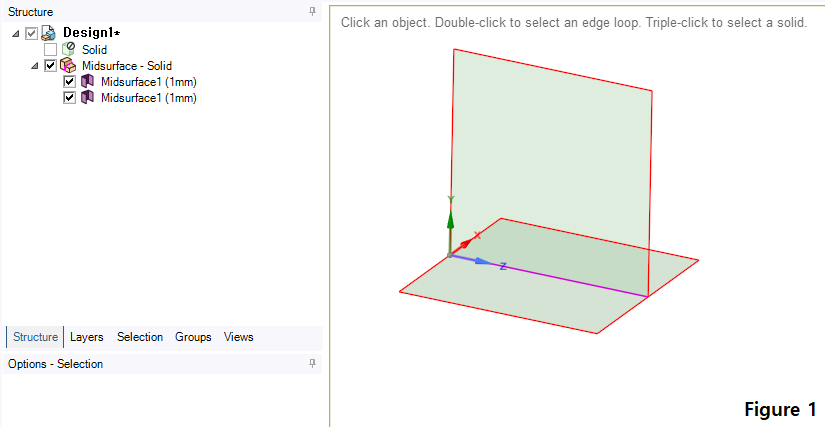

I made the model and shared topology between them, like Figure 1.Â
And I generated blocks and changed number of divisions of edge number1, then meshes are moved together because they share the topology of edge number2.(Figure 2)

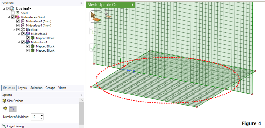

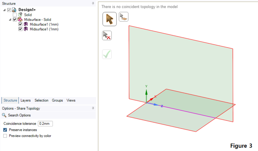

But, if I make the model like Figure 3, Blocks are not sharing mesh(Figure 4) but they seems like to share topology still..Â

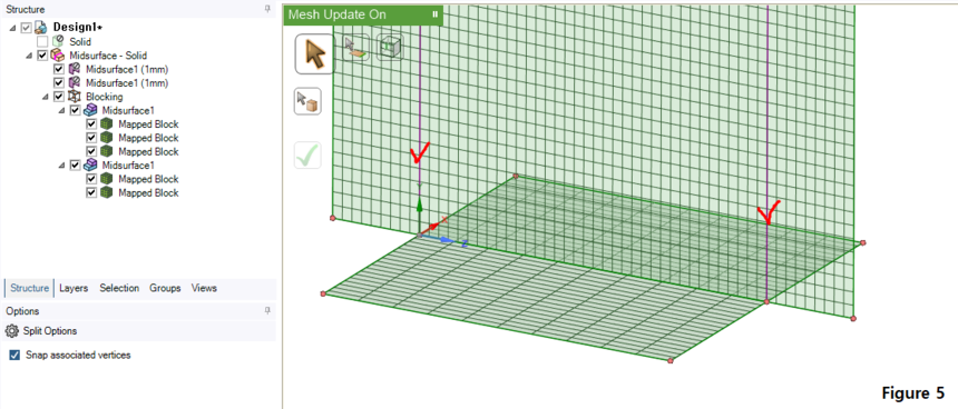

Also, if I split the block and change the mesh again, same thing happens.(Figure 5)
Is this bug? or is there other reasons that they are not sharing mesh?
