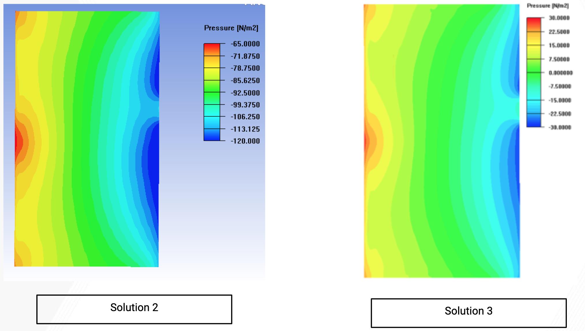

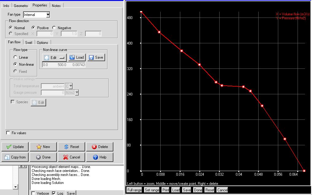

      For the pressure contour plots though, things are not identical. From a qualitative perspective, the contours look very similar with the "high" and "low" pressure spots located in the correct areas. However, when looking at the magnitudes, it seems like my values are shifted by about 90 Pa negative. I am very interested in the pressure drop of a cavity that has airflow thanks to a couple of fans. I have looked at the fan settings a million times and they also look identical (I apologize for using the word identical 10000 times in this post).
      At this point, the real simple answer would be to run his files and move on. The problem is that the files do not yield the expected results from the correct solution he left, the one used for his publication. My solution files are in agreement with the solution from his files but not with the correct solution.

      Solution 1 and 2 agree with each other but these pressure contour plots do not agree with Solution 3.

      What is the difference in the pressure contours if all other quantities are same? Can you insert the screenshots?
    • Snow1Runner
      Thanks for the response Amine. I believe I have included 2 attachments in the post with a comparison of the pressure contours and fan settings. Please let me know if you can't see them.
      Cheers!
    • Amine Ben Hadj Ali
      Ansys staff do not look into attachments. Insert the pictures.
    • Snow1Runner
      Pictures added. Apologies for the confusion!
      Solution 1 is equal to Solution 2 but both differs in pressure magnitude from the pictures the student left. I would first contact the masterand. Better export the settings of each case file and use diff on Linux or similar on Windows and compare the settings. Also use other initialization. Possible that there is a grid change but I doubt why it does only affect pressure.
