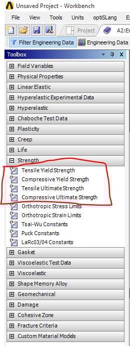

      I want to view the safety factor for my model which I have conducted for static structural analysis. However, the error message "Yield Strength is required but not defined' kept appearing. Same goes for ultimate strength. How do I go about defined these 2 parameters?
    • Rohith Patchigolla
      You can input these parameters in the Engineering Data. They are in the Strength section as shown in the image below.
      Hope this helps.
