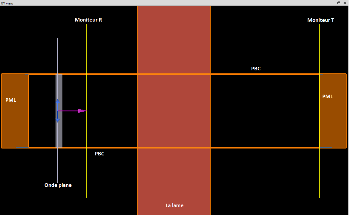

I will try to be more precise in my question.
I am simulating a 2D structure and I need to retrieve the S parameters in order to extract the effective parameters (refractive index, impedance, permittivity and permeability).

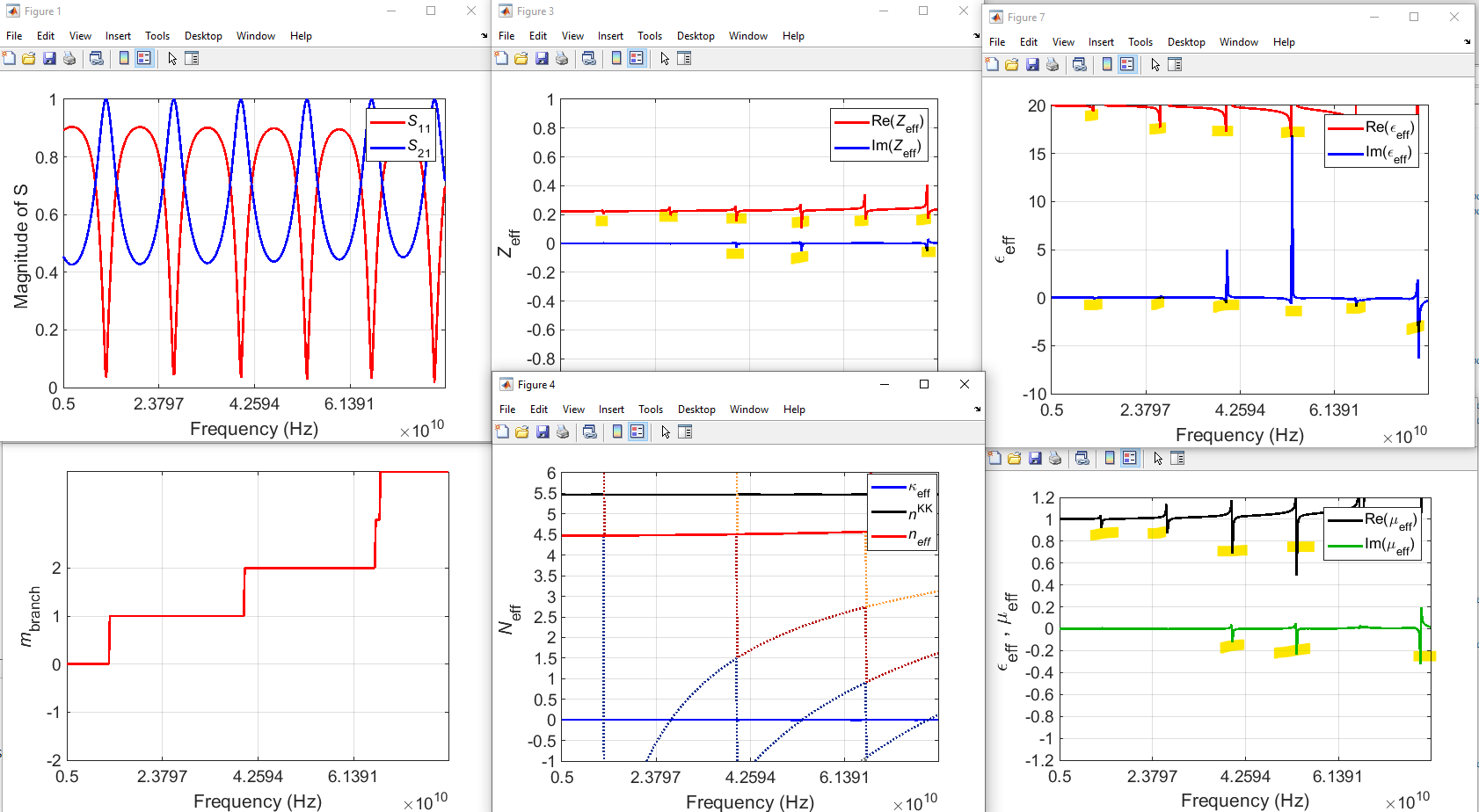

The problem I encounter when I extract the effective parameters, peaks without physical meaning appear on the impedance curve, these peaks appear when S21^2 is close to unity while S11 is close to 0.

August 9, 2021 at 4:01 pmdjihad-amina.djemmah
SubscriberI'm coming back to you because I've been trying to solve this problem for almost a month and I can't, and unfortunately my work is not progressing because of this.
I have varied the number of PML layers, the mesh precision, the mesh size and the simulation time.
I managed to reduce the size of the peaks but it is not enough to make them disappear.
I used two extraction methods: Smith's method (fig 3) and Szabo's method (fig 4) with both methods we can see that the peaks which they don't have any physically significant.
With the Smith model, there is also a fluctuation problem as you can see in fig 4(I don't know why they appear) .

August 9, 2021 at 4:22 pmGuilin Sun
Ansys EmployeeI think you have duplicated your question in other post: S parameters Please do not duplicate it since this is a waste of resources.
From your result, it is clear that the frequency range is too wide that the phase change of S parameters is larger than 2pi. I believe that it is this issue that causes problem. This is the math issue not simulation issue. One simple way is to simulate different frequency range with phase change less than 2Pi. However this may create other issues such as the result is not continuous. I still suggest that you plot the two intermediate quantities and see if they are continuous, and then try to improve the result by all means.
From my experience, sometimes even the two intermediate quantities are continuous, how to calculate the square-root also may lead to different result. This may be script-dependent, eg, different program language could lead two different results but mathematically they are correct. This is mainly due to the branches of the complex square-root operation.
