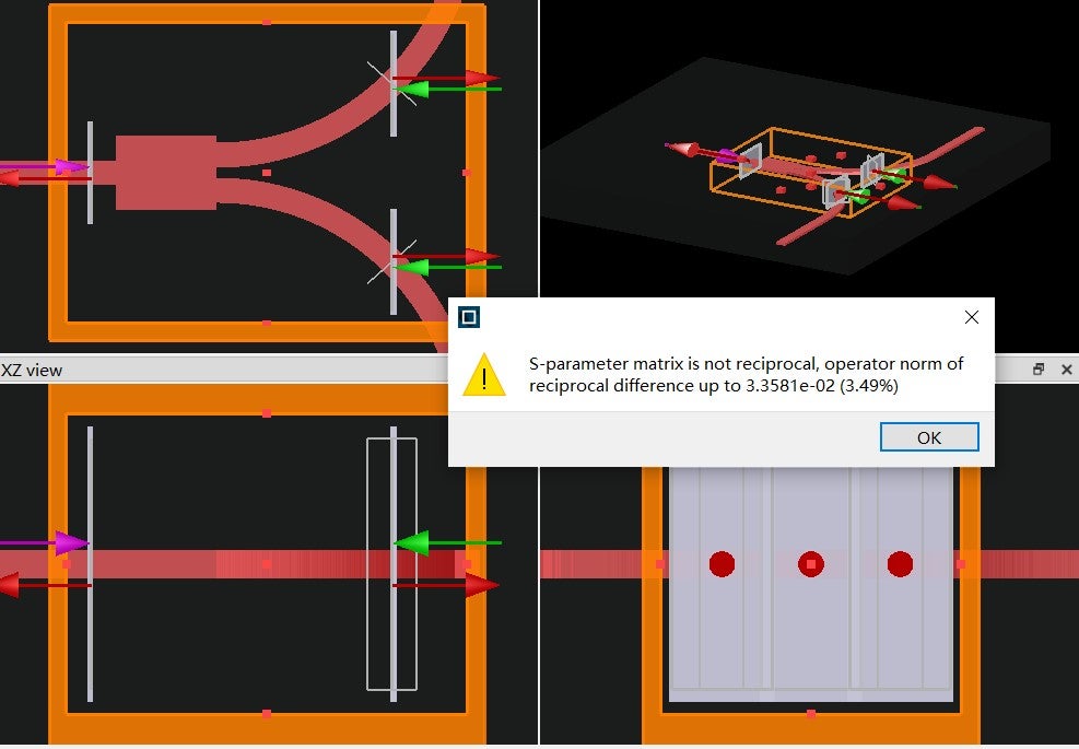

  I would like to ask how to solve these problems

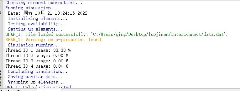

  I will download the examples on the official website(https://optics.ansys.com/hc/en-us/articles/360034403214),(There is a problem as shown in the first figure)How to modify this problem in parameter extraction?Then I import the extracted parameters into INTERCONNECT,This warning appears。 -

Ansys EmployeeThis simply means the S parameters are accurate to 0.03, eg 2nd digits. You can either ignore it, or use much finer mesh (and increase PML layers) to improve it.
