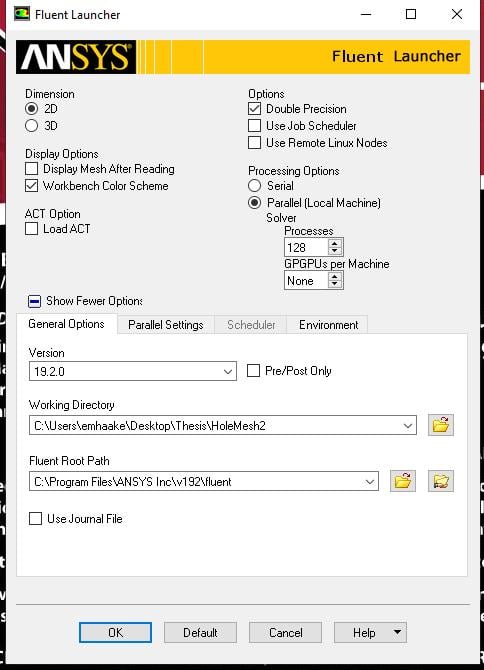

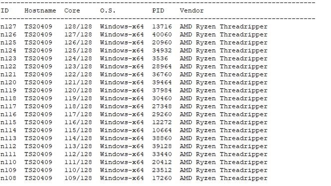

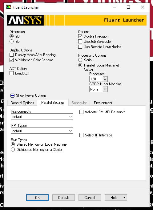

      I am attempting to run a simulation on a new computer my school just obtained.  When launching fluent I set it to be parallel with 128 processes to account for the cores being hyperthreaded.

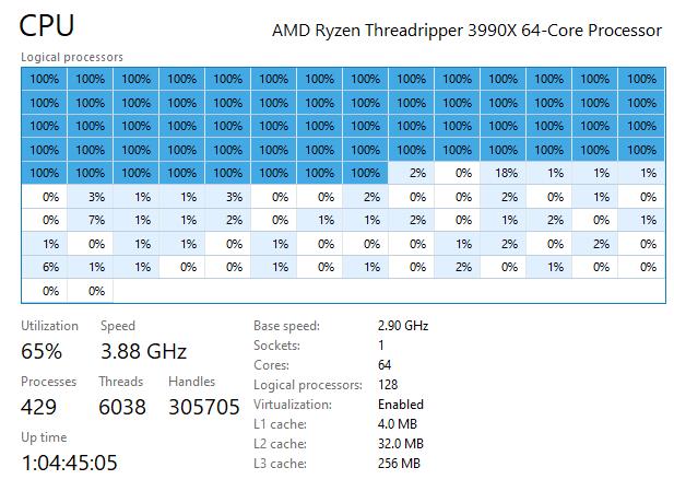

      When I start to run the model only have the CPU is being used.  Currently the CPU has 2 NUMA Nodes and only 1 is ever used by fluent.
      I am wondering if there are any setting that I have to adjust to get fluent to work on both of the NUMA cores at the same time?

      Hi Eric,
      ANSYS solvers (not just Fluent) are already CPU intensive, so hyperthreading actually can degrade the solver performance instead of increasing it. It's always recommended to disable hyperthreading for ANSYS solvers. In your case, 64 physical cores would be best.

      • Supported ONLY for Fluent 18.2 and higher using this flag in your startup script: -platform=Intel
    • ericmh
      Thank you,
      We are currently working with IT to get hyperthreading disabled on the computer.  As for the requirements we are using 256GB of ram, an EVO970 NVMe, and a QuadroRTX4000.  I am going to ask out IT to install and interconnect software and hopefully this will fix the issue.

      You are welcome.
      No need to worry about interconnect as that's needed only when you are solving on multiple machines/nodes.
