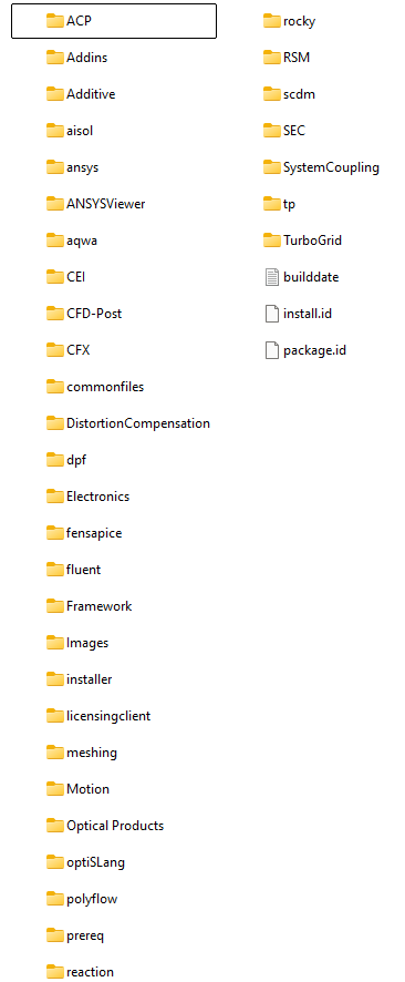

      • kajetankurtek
        Hello, I appreciate your previous suggestions. I tried them, but unfortunately, they didn’t resolve the issue. I replied with more details a few days ago—have you had a chance to see my message? I’d really welcome any further guidance you can provide. Thanks in advance
    • kajetankurtek
      Thank for the response. Unfortunately the first method does not work, the same error message appears when I attempt opening the file. I tried to use the second method, however in the given location (c:\Program Files\ansys Inc\ANSYS Student\v251) I have no ProductConfig.exe file. I attached the screenshots of the folder contents.
