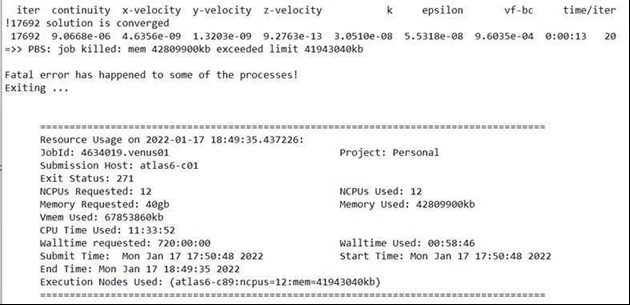

I am trying to run a case on HPC, the cell count is very low (300k), and the case runs fine if i turn off the source terms (mass and momentum in a fluid zone). However, when i turn on the source terms (which are added using "named expressions"), the case runs for sometime then terminates with an error "exceeded allocated memory, even for 160GB memory allocated).
Could someone help me please in this issue?
Is there like a PBS command to clear virtual memory from time to time?
The problem only appears with activating source terms

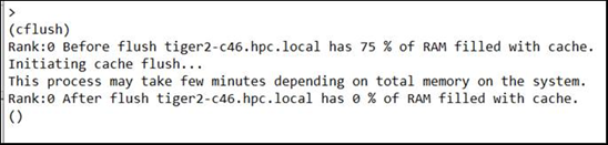

I've tried "execute command" --> (cflush), to clear virtual memory every few time steps (maybe 100 or so), it worked few times as shown below:

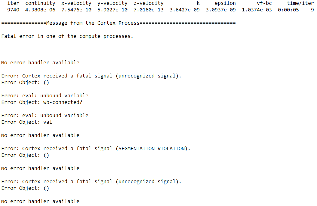

but then, it terminates, showing the following error:

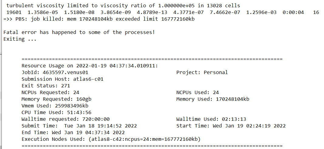

When, i turned off the execute command (cflush) and the animation, the case runs fine for some times steps, then slows down extremely and eventually terminates sowing the below error:
or this error:

Forum ModeratorThe source terms shouldn't cause a memory leak like that. What calculations are done to find the source terms? Can you monitor RAM usage from the IT side? Also what's using the RAM as we've seen rogue (or deliberate!) IT tasks kill jobs before, typically the virus scanner tries to do something clever.

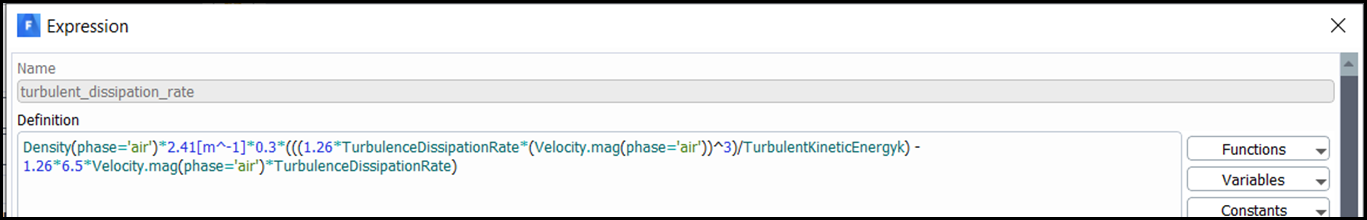

SubscriberHi Mr Rob Below is an example of a source term (the case has 18 source terms like this):

As you can see below, i've requested 160GB of ram, and it still terminated after slightly over 5000 time steps:

Forum ModeratorIt's almost certainly the expression step that's leaking RAM as it's evaluated for every cell in every iteration. I know we've been doing more work on expressions since 2021R1 so I'll see if it's a known issue, and if so whether it's fixed in 2022R1 (due "soon").
The IT comment is based on experience. A few users at various companies lost jobs when running over some nights but not others. We eventually traced this to a deep virus scan on the clusters that was trying to check an open Fluent log file: as the file kept changing the scanner kept restarting the scan whilst not closing the previous scan. By the time the user returned in the morning the cluster had killed the task with a RAM error. The virus scanner then completed the tasks as it restarted automatically and didn't report an error......

I tried "(cflush)" as exectue command every 100 time steps, it worked few times, then the solution crashed too, as you can see in the above messages.
Could this solve the problem? but why it generated "cortex error" ? and sometimes it doesnt even work

Forum ModeratorIt's a memory leak - and may be fixed in 2021R2 and 2022R1: this assumes you've found the same issue as the earlier one.

Forum ModeratorAs far as I can see it's version specific, so updating should fix it. Note, Student won't play well with any installs of the normally licenced software so be wary of putting it on a Uni machine. 2022R1 is due soon so it may be a good time to talk to the IT department about an update. You can run multiple versions of the Ansys software on one machine (I've usually got 5-6 different release of Fluent installed) so it shouldn't impact any other users.
