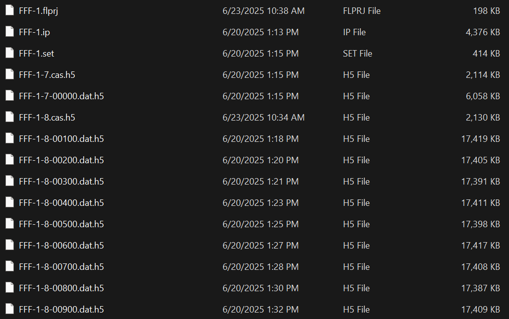

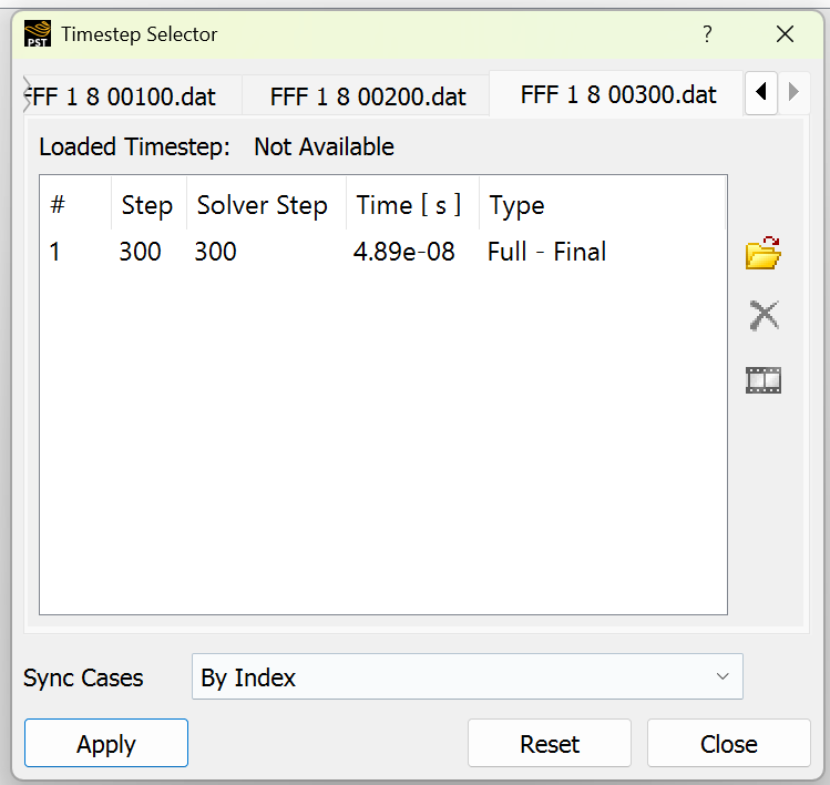

          However, I’ve having trouble loading them into CFD-Post via the Results component in Workbench, or into CFD-Post through the Windows start menu. After running my simulation, I did not save a case file each timestep (at the time I did not find it necessary since the mesh/setup don't change) so I have a case file “FFF-1-8.cas.h5” (the second Fluent system on the project and the 8th version of the case file) and several data files named by timestep “FFF-1-8-XXXXX.dat.h5”. When loading results into CFD-Post, each timestep is loaded in a new tab in the Timestep Selector menu and defined as a final timestep, instead of listed vertically and defined as partway through the simulation as they should be. This seems like something simple, but I’m having some difficulty figuring out how to fix this.

      Try loading the flpj file. There are a few changes with transient data sets so some of the older guidance isn't current, but as people are using several versions we can't just delete the older notes.
    • jdch232
      Loading the flprj file worked perfectly, thank you Rob. For anyone encountering similar problems, reading through CFD-Post User's Guide Chapter 8.15: "File Types Used and Produced bf CFD-Post" contains information on various file types used and recommended practices. In my case, transient cases using CFF files from Fluent are highly recommended to load the fluid project (flprj) file.
