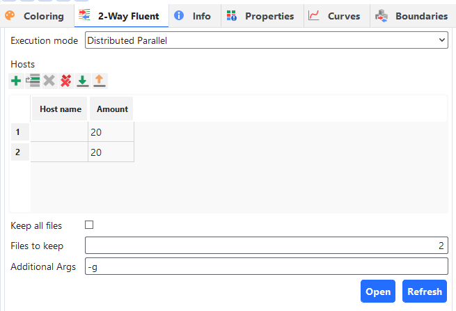

running coupled rockey-fluent in distributed parallel on HPC
    • parsaary
      I recently asked a question about how to speed up a slow rocky-fluent simulation (https://innovationspace.ansys.com/forum/forums/topic/ways-to-accelerate-a-cfd-dem-simulation/?template=rocky)
      In response, I was told that "if the bottleneck is on the Fluent side, you can allocate more CPU cores and even run it in distributed mode. If the bottleneck is on the Rocky side, you can allocate more GPUs to increase performance"
      I think the bottleneck is in the fluent portion, so I'd like to use 2 nodes to run fluent in distributed parallel.
      Coud you please check my set-up and tell me what's wrong? Setup details and error are all shown below. Thanks.
      Best regards,
      Parsa
      Set-up:
      I am running the sim on a remote HPC using 2 nodes that each have 4 gpu's and 24 cpu's. Since rocky can't do multinode, i am assigning it to only one of the nodes, such that it uses 4 gpu's, as well as 4 cpu's for miscellaneous tasks such as data transfer. The other 20 cpu's of that node as well as all 20 (or 24?) of cpu's from the other node are assigned to fluent (distributed parallel).
      Gui:
      .sh file:
      #!/bin/bash
      #SBATCH --account=ABC-gpu       # GPU account
      #SBATCH --job-name=distpl    # Job name
      #SBATCH --time=00-12:00                  # Time limit dd-hh:mm
      #SBATCH --nodes=2                        # Request 2 compute nodes
      #SBATCH --ntasks-per-node=24             # 24 CPU cores per node
      #SBATCH --cpus-per-task=1                # Do not change
      #SBATCH --mem-per-cpu=7G                 # Memory per CPU
      #SBATCH --gpus-per-node=4                # 4 GPUs per GPU node
      #SBATCH --output=myrockylog.out          # Output file

      # SLURM → Fluent Node File
      scontrol show hostnames $SLURM_JOB_NODELIST > hosts.txt
      export SLURM_NODEFILE=hosts.txt
      echo "==== Rocky/Fluent Nodefile ===="
      cat hosts.txt
      echo "==============================="
      # CPU count
      NCORES=$((SLURM_NTASKS * SLURM_CPUS_PER_TASK))
      echo "NCORES = $NCORES"
      # Force Rocky to run ONLY on GPU node #1
      GPU_NODE=$(scontrol show hostnames $SLURM_JOB_NODELIST | head -n 1)
      echo "Running ROCKY on GPU node: $GPU_NODE"
      srun --nodes=1 --nodelist=$GPU_NODE --gres=gpu:4 \
          Rocky --simulate "RProcky.rocky" --resume=1 \
          --use-gpu=1 \
          --gpu-num=0 --gpu-num=1 --gpu-num=2 --gpu-num=3 \
          --ncpus=4

        File "/home/jenkins/Work/Jenkins/workspace/rocky30-rb-ROCKY-v23.2.0-ansys-newlinux/etk/plugins10/source/python/plugins10/plugins/pool/poolcontent.py", line 144, in _Engage
        File "/home/jenkins/Work/Jenkins/workspace/rocky30-rb-ROCKY-v23.2.0-ansys-newlinux/rocky30/source/python/rocky30/plugins/model/study_model_builder.py", line 421, in Engage
        File "/home/jenkins/Work/Jenkins/workspace/rocky30-rb-ROCKY-v23.2.0-ansys-newlinux/etk/coilib50/source/python/coilib50/subject/_pool.py", line 400, in __getitem__
      KeyError: 'project.study_00001.materials_interaction_container'
      The above exception was the direct cause of the following exception:
      Traceback (most recent call last):
        File "/home/jenkins/Work/Jenkins/workspace/rocky30-rb-ROCKY-v23.2.0-ansys-newlinux/etk/plugins10/source/python/plugins10/plugins/scripting/base_scripting.py", line 97, in ExecScripting
        File "/home/jenkins/Work/Jenkins/workspace/rocky30-rb-ROCKY-v23.2.0-ansys-newlinux/kraken20/source/python/kraken20/plugins/project_manager/_project_manager.py", line 22, in ActualOpen
        File "/home/jenkins/Work/Jenkins/workspace/rocky30-rb-ROCKY-v23.2.0-ansys-newlinux/etk/petroapp10/source/python/petroapp10/plugins/project_handler/_project_manager.py", line 29, in ActualOpen
        File "/home/jenkins/Work/Jenkins/workspace/rocky30-rb-ROCKY-v23.2.0-ansys-newlinux/etk/plugins10/source/python/plugins10/plugins/project_manager/_project_manager.py", line 428, in Open
        File "/home/jenkins/Work/Jenkins/workspace/rocky30-rb-ROCKY-v23.2.0-ansys-newlinux/etk/plugins10/source/python/plugins10/plugins/project_manager/_project_manager.py", line 695, in DoOpen
        File "/home/jenkins/Work/Jenkins/workspace/rocky30-rb-ROCKY-v23.2.0-ansys-newlinux/etk/plugins10/source/python/plugins10/plugins/project_manager/_project_manager.py", line 439, in DoOpen
        File "/home/jenkins/Work/Jenkins/workspace/rocky30-rb-ROCKY-v23.2.0-ansys-newlinux/rocky30/source/python/rocky30/plugins/project/project_handler.py", line 553, in Open
        File "/home/jenkins/Work/Jenkins/workspace/rocky30-rb-ROCKY-v23.2.0-ansys-newlinux/etk/petroapp10/source/python/petroapp10/plugins/project_handler/_project_handler.py", line 480, in Open
        File "/home/jenkins/Work/Jenkins/workspace/rocky30-rb-ROCKY-v23.2.0-ansys-newlinux/etk/plugins10/source/python/plugins10/plugins/undo_redo/_undo_redo_helpers.py", line 86, in CleanAndExecuteWithoutCmdHis
        File "/home/jenkins/Work/Jenkins/workspace/rocky30-rb-ROCKY-v23.2.0-ansys-newlinux/etk/petroapp10/source/python/petroapp10/plugins/project_handler/_project_handler.py", line 279, in Open
        File "/home/jenkins/Work/Jenkins/workspace/rocky30-rb-ROCKY-v23.2.0-ansys-newlinux/ben10/source/python/ben10/foundation/reraise.py", line 9, in Reraise
      KeyError: 'Unable to open project file.'
        File "/home/jenkins/Work/miniconda/envs/_rocky30-freeze-linux64-py36-v3/lib/python3.6/site-packages/cx_Freeze/initscripts/__startup__.py", line 14, in run
        File "/home/jenkins/Work/miniconda/envs/_rocky30-freeze-linux64-py36-v3/lib/python3.6/site-packages/cx_Freeze/initscripts/Console.py", line 26, in run
        File "/home/jenkins/Work/Jenkins/workspace/rocky30-rb-ROCKY-v23.2.0-ansys-newlinux/rocky30/source/python/main.py", line 13, in
        File "/home/jenkins/Work/Jenkins/workspace/rocky30-rb-ROCKY-v23.2.0-ansys-newlinux/rocky30/source/python/rocky30/frozen_utils.py", line 70, in RockyBasedAppMain
        File "/home/jenkins/Work/Jenkins/workspace/rocky30-rb-ROCKY-v23.2.0-ansys-newlinux/etk/plugins10/source/python/plugins10/plugins/basic_application/main.py", line 264, in Main
        File "/home/jenkins/Work/Jenkins/workspace/rocky30-rb-ROCKY-v23.2.0-ansys-newlinux/etk/plugins10/source/python/plugins10/plugins/basic_application/main.py", line 426, in _Main
        File "/home/jenkins/Work/Jenkins/workspace/rocky30-rb-ROCKY-v23.2.0-ansys-newlinux/rocky30/source/python/rocky30/rocky_application_setup.py", line 49, in CallMain
        File "/home/jenkins/Work/Jenkins/workspace/rocky30-rb-ROCKY-v23.2.0-ansys-newlinux/rocky30/source/python/rocky30/batch_mode.py", line 25, in MainBatch
        File "/home/jenkins/Work/Jenkins/workspace/rocky30-rb-ROCKY-v23.2.0-ansys-newlinux/rocky30/source/python/rocky30/batch_mode.py", line 55, in _RunInBatchMode
        File "/home/jenkins/Work/Jenkins/workspace/rocky30-rb-ROCKY-v23.2.0-ansys-newlinux/etk/plugins10core/source/python/plugins10core/pluginmanager.py", line 1109, in Main
        File "/home/jenkins/Work/Jenkins/workspace/rocky30-rb-ROCKY-v23.2.0-ansys-newlinux/etk/plugins10core/source/python/plugins10core/pluginmanager.py", line 708, in Main
        File "/home/jenkins/Work/Jenkins/workspace/rocky30-rb-ROCKY-v23.2.0-ansys-newlinux/etk/plugins10/source/python/plugins10/plugins/uiapplication/uiapplication.py", line 370, in Main
        File "/home/jenkins/Work/Jenkins/workspace/rocky30-rb-ROCKY-v23.2.0-ansys-newlinux/etk/plugins10/source/python/plugins10/plugins/uiapplication/uiapplication.py", line 388, in BeforeProcessEvents
        File "/home/jenkins/Work/Jenkins/workspace/rocky30-rb-ROCKY-v23.2.0-ansys-newlinux/etk/petroapp10/source/python/petroapp10/plugins/command_line/command_line_open.py", line 212, in HandleCommandLine
        File "/home/jenkins/Work/Jenkins/workspace/rocky30-rb-ROCKY-v23.2.0-ansys-newlinux/etk/petroapp10/source/python/petroapp10/plugins/command_line/command_line_open.py", line 143, in HandleOpenProject
        File "/home/jenkins/Work/Jenkins/workspace/rocky30-rb-ROCKY-v23.2.0-ansys-newlinux/etk/petroapp10/source/python/petroapp10/plugins/command_line/command_line_open.py", line 125, in _OpenProjectFile
        File "/home/jenkins/Work/Jenkins/workspace/rocky30-rb-ROCKY-v23.2.0-ansys-newlinux/etk/petroapp10/source/python/petroapp10/plugins/project_handler/_project_manager.py", line 46, in Open
        File "/home/jenkins/Work/Jenkins/workspace/rocky30-rb-ROCKY-v23.2.0-ansys-newlinux/etk/petroapp10/source/python/petroapp10/plugins/scripting/_petroapp10_scripting.py", line 100, in Open
        File "/home/jenkins/Work/Jenkins/workspace/rocky30-rb-ROCKY-v23.2.0-ansys-newlinux/etk/plugins10/source/python/plugins10/plugins/scripting/base_scripting.py", line 127, in ExecScripting
      KeyError: "Error when executing scripting command: Open. Arguments: {'filename': 'RProcky.rocky'}"
      [2025-11-21T23:55:31.264] error: *** STEP 6818447.0 ON se355 CANCELLED AT 2025-11-21T23:55:31 DUE TO TASK FAILURE ***
      srun: error: se355: tasks 0-9,12-23: Terminated
      srun: error: se355: task 10: Terminated
      srun: Force Terminated StepId=6818447.0
