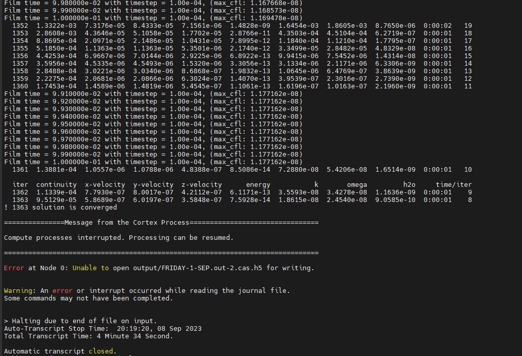

      I am trying to run fluent on linux using batch, in the directory there is  FILE.cas.h5, FILE.dat.h5, job scheduler (FILE.sh) and journal file. After submitting the job it iterates until 99th time step (it is supposed to autosave every 100 time step), but then stops with the following errors:
      "Error at Node 0: Unable to open output/FILE.out-2.cas.h5 for writing."
      and for another case:
      "Warning: An error or interrupt occurred while reading the journal file.
      Some commands may not have been completed."
      The journal file contains the following:

      I am new at running ansys on linux and do not know what is causing the problem.
      If it's failing at the autosave point I'd check you have the /output folder and that you have write permissions to it.
