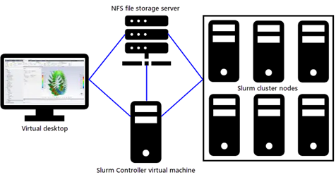

      Cluster Requirements:
      To configure an HPC workflow that uses a Slurm cluster the following resources are required in the following order :

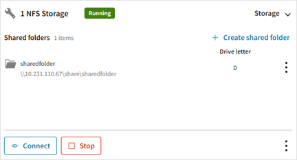

      1. NFS file storage server with a shared folder.

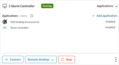

      2. Linux Virtual Desktop with Slurm Controller and KDE

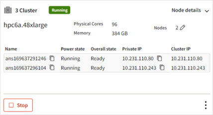

      3. HPC Cluster with Slurm Node with NFS and EFA
      Please ensure that all resources are ready and RUNNING before proceeding.

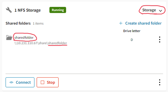

      1. Take a note of the shared folder name
      2. Connect to the Slurm Controller VM. (use RDP, or SSH)

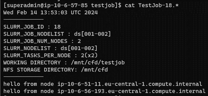

      5. Check the output, it should look like this
        cat /mnt/sharedfolder/TestJob-1*
