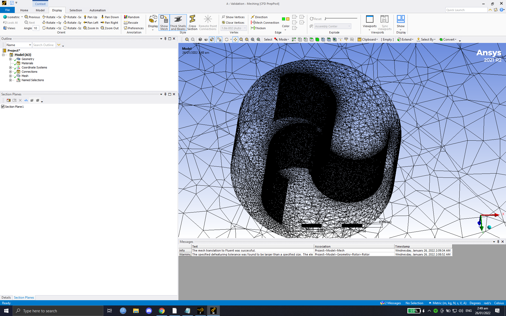

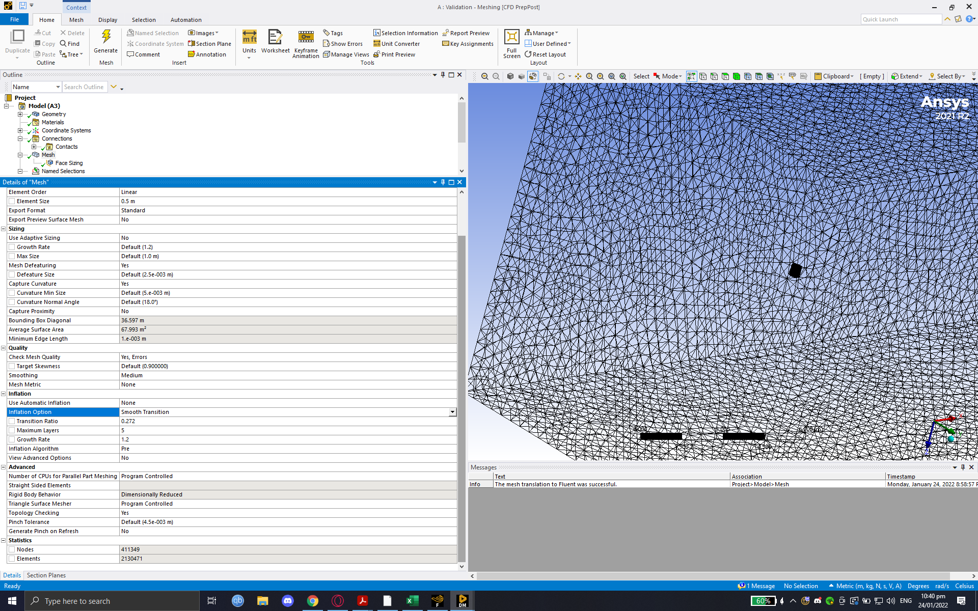

SubscriberI'm trying to validate an experimental study by trying to obtain the same torque.

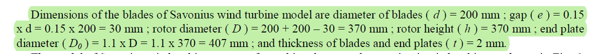

the dimensions of the blades were given, so I modeled and ran simulations on CFD fluent
TSR: 0.555
wind speed: 7 m/s
Used this formula to calculate rpm : rpm = 60 * V * TSR / ( Pi * D )
January 24, 2022 at 11:29 amRob
Forum ModeratorAssuming the blade shape is also defined I'd expect to get a similar result with a good mesh. With a poor mesh I'd expect to be closer than you're seeing above.

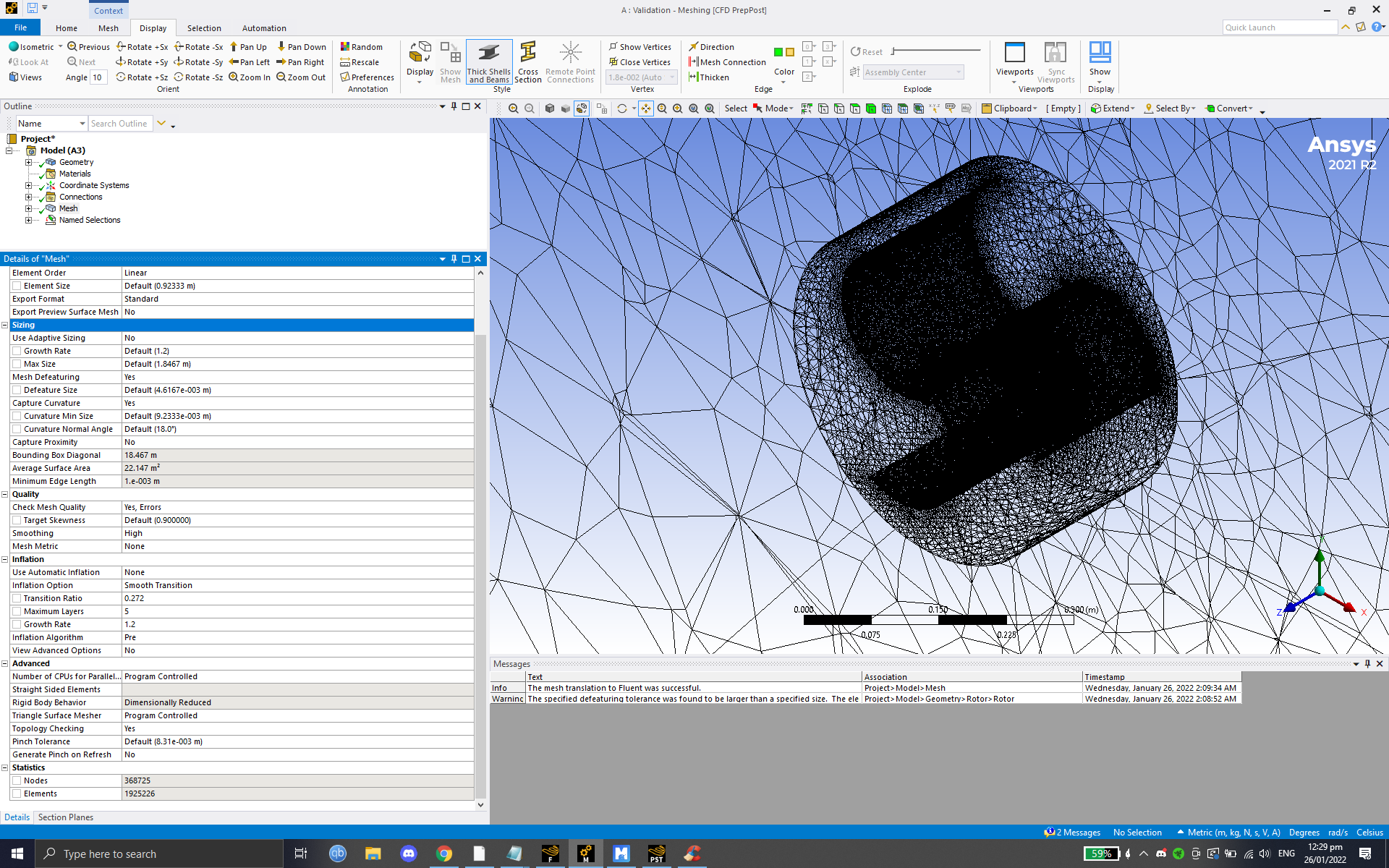

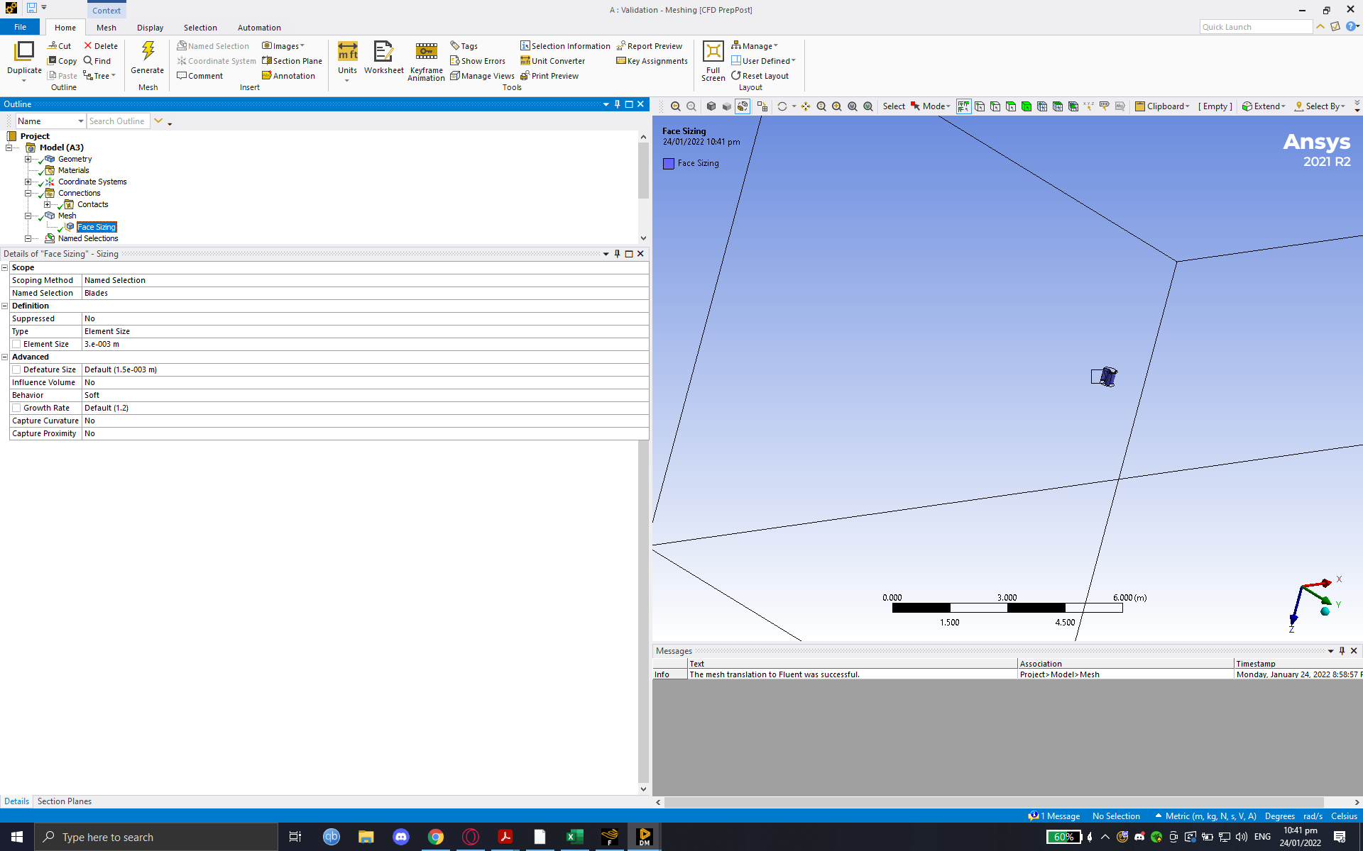

January 24, 2022 at 2:45 pmJansys
SubscriberThe blade shapes are halve cylinders, here are my mesh settings as well. I'm not sure what would be considered as good mesh?
Here is a link to the study I am trying to validate for as required by our thesis defense panel:
https://reader.elsevier.com/reader/sd/pii/S1876610215005652?token=06F41B08CDE2292E2B4025CCE91C6A45B3144166B70DFF7FEEEAFA81455DDF1EEB8398AF983295C66EB2F957E4E90A2B&originRegion=us-east-1&originCreation=20220124144208

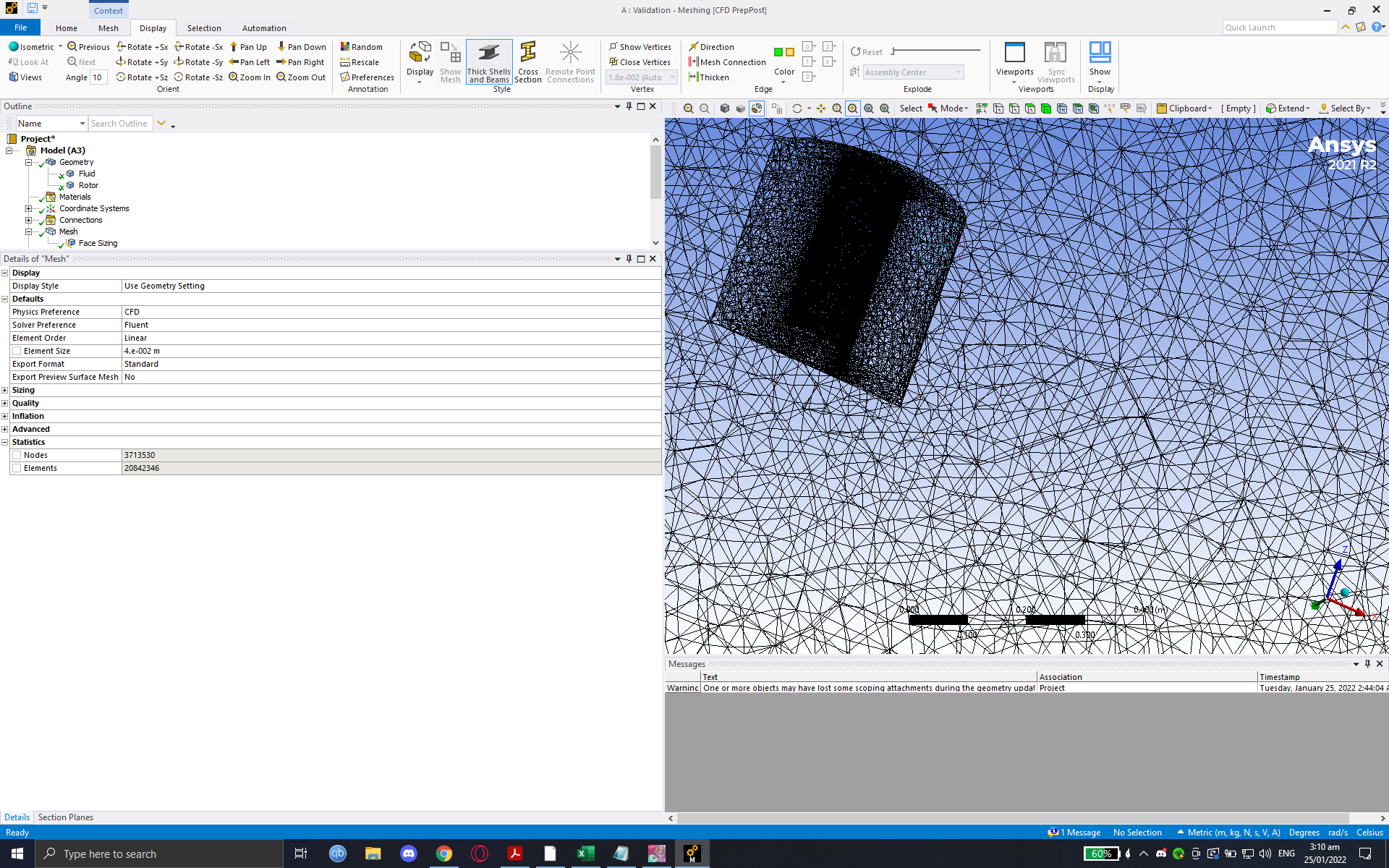

Results after increasing domain size at 5 m/s: I was able to reach torque of around .06 still far from .03 as per graph above
January 24, 2022 at 2:46 pmJanuary 24, 2022 at 3:44 pmRob

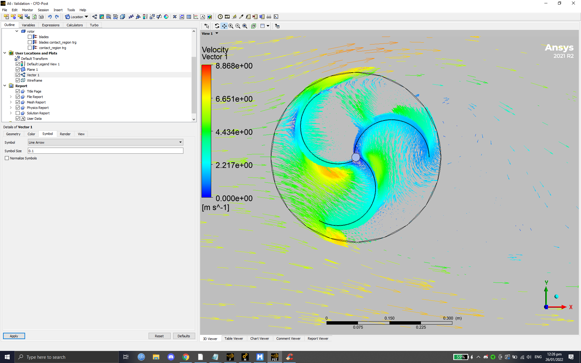

Forum ModeratorPlease show a slice through the mesh on a z-plane and zoom in on the rotor. How many cell zones have you got?
January 24, 2022 at 7:11 pmJanuary 25, 2022 at 9:38 amRob
Forum Moderatorz-plane please - ie across the turbine unit. Contours of velocity will be useful too.
January 26, 2022 at 4:28 amJanuary 26, 2022 at 5:32 amJanuary 26, 2022 at 7:20 amDrAmine
Ansys EmployeeHow are you calculating the torque in Fluent?
January 26, 2022 at 11:34 amJansys
SubscriberBy using the report definitions for moment at the blades, is that correct?
January 26, 2022 at 12:04 pmRob
Forum ModeratorYes, what did you define as the axis?
January 26, 2022 at 12:10 pmJansys
SubscriberI used the z axis
