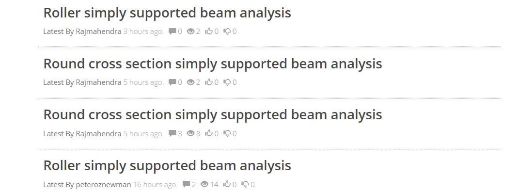

      Rajmahendra,
      You have started four New Discussions, but they are all on the same topic.
      The concept of a Discussion is that multiple posts of questions and answers are grouped under one Discussion. When you start a New Discussion and you get a reply, the idea is you use Add Post to respond with more information or ask a related question. I believe this discussion is simply an answer to my post in this other discussion.
      Please use the Add Post to reply to responses you get from your New Discussion.  Only use New Discussion when you are asking a question on an unrelated topic.
      Also, please delete the duplicate post. That sometimes happens to me when the website freezes.
      Maybe the Admins can combine these four Discussions into one?
