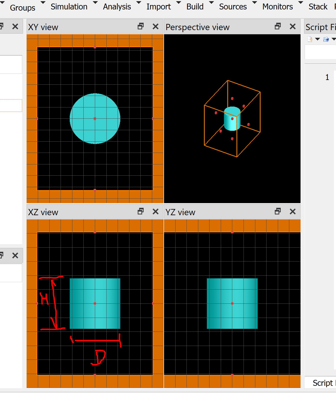

SubscriberBasically, my question is how to set up a Lumerical FDTD simulation so that it can simulate a radially symmetric structure as fast and efficiently as possible. If I were to do a complete 3D FDTD simulation, I think it would be a much more computationally intensive simulation than it would need to be. Is there a way to use radial symmetry to do the simulation efficiently?
September 27, 2021 at 5:15 pmGuilin Sun

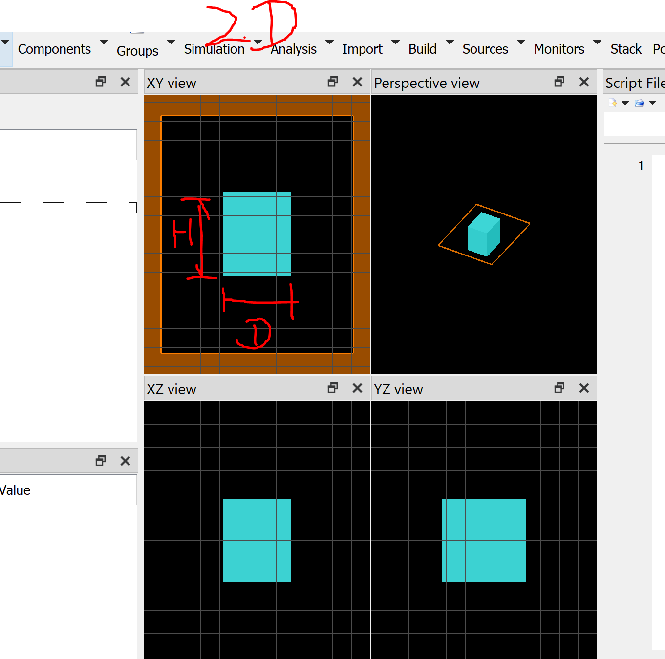

Ansys EmployeeSince you know it is radially symmetric and want to do 2D simulation, please just start with a 2D simulation (only in xy plane) and see if the result is expected, where the cylinder become a rectangle with diameter and height. You can also use 3D simulation with the true cylinder, but only set the other axis with periodic BCs, and one mesh cell only. eg, if the cylinder is along z axis and its cross section is in xy plane, you can set y axis in periodic BC. Now it is not the geometry nor the simulation determine the 3D, it is your post processing. please try one of the two methods and check the result. Those two methods will show different cylinder orientation, but the post processing result should be the same, except that due to the curve in y there is a small error in representing it.

SubscriberI think that just doing a 2D simulation without any additional configuration is incorrect: The 2D simulation would assume that the structure is unchanged along the z axis (out of the simulation plane) which is different from a structure that is radially symmetric about the y-axis. Is there a way to properly configure the 2D simulation to account for radial symmetry?
I saw the help article on how to do a smaller 3D simulation with periodic BCs as you have described, but this will only reduce the overall simulation time by a factor of ~4x because you still have to do a 3D simulation (over a smaller volume).
What I would really like to know is how to configure the 2D simulation for radial symmetry, instead of a structure which is invariant along the z axis.

Ansys EmployeeI suggest that you carefully consider what I suggested: it is the post processing that matters. take the cylinder along z as an example: any cut parallel to and through the cylinder axis has the same result, isn't it? in this cut, can you do a 2D simulation? if yes, just take the cut geometry size and do a 2D simulation, you WILL get what you want as long as your assumption is correct.

SubscriberThis is incorrect. The 2D simulation you have shown assumes that the structure is infinitely long in z. It will not give the same result as a cylinder or a square that has finite dimensions in z, even for the central xy-cross-section at z=0. Is there a Lumerical FDTD help line where I can schedule a quick phone-conversation to discuss my issue? Thanks!
