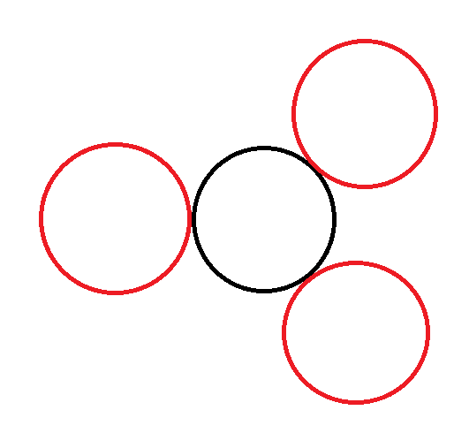

SubscriberHi guys. I have a circuit of 4 gears.
Three red gears rotate the black one in the middle
How to set joints correctly?
I can't get everything to rotate.
For each circle, I set the body-ground rotation to rtevolute.
Between myself, I connected each red with black (3 joint) as body-body - revolute. I also tried to set planar for them but then only two shafts rotate.
Help me please.
How to make a connection so that everyone rotates each other?
Or what's right?

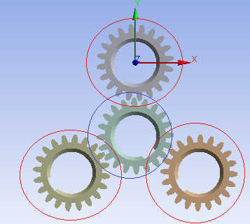

SubscriberOne way to evaluate stress in the teeth does not require all gears to rotate. If the red gears all have the same torque load, the center black gear gets a revolute joint while the three red gears are held fixed at the hub. A Joint Load of Torque is put on the Revolute Joint. Frictional Contact is created between the gear teeth that are touching. This is done in a Static Structural analysis.
If the red gears each have a different torque, then you mostly care about the highest torque load. You can fix the hub of the center black gear and put a revolute joint on the high torque red gear and apply a joint load of torque on that one red gear. It will have the largest stress.

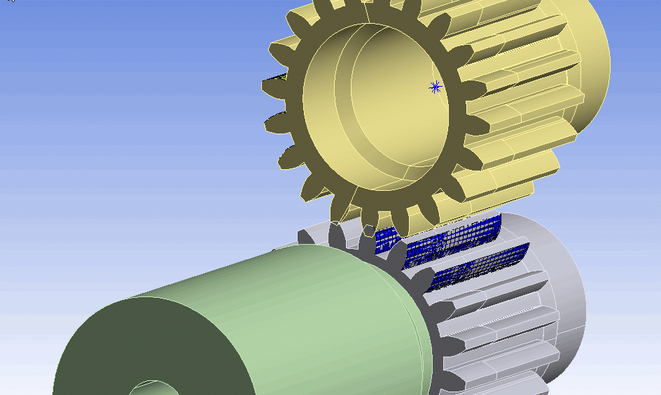

SubscriberYes you are right.
It is enough to leave only two shafts.

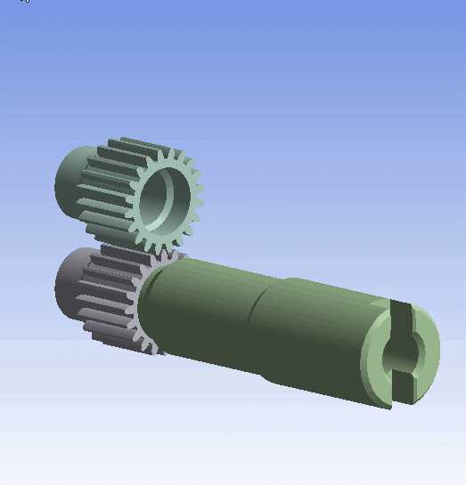

I have a paradox. When I set the rotation to 360 degrees, the two shafts only rotate 180 degrees. All body rigid:
If I set 720 degrees they make one revolution.
But if I add a shaft to the wheel, then the shaft slows down and the wheels spin in place:
I made animations (see above) but they don't work on the site
attached them as files:
May 26, 2022 at 6:31 pm
peteroznewman
SubscriberWhat is your purpose in rotating the gears? I thought your goal was to evaluate stress in the teeth. You don't need more than a few degrees of rotation on one gear to load up the torque and evaluate the tooth stress. The other gear hub is fixed.

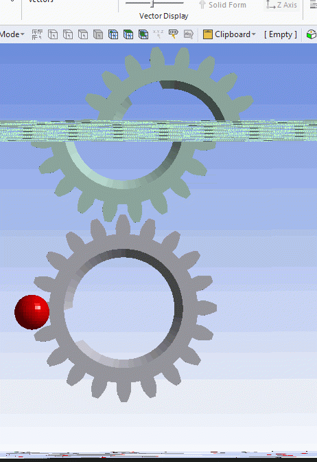

SubscriberI don't have many tasks. I need to rotate the gears to see what happens to the shaft that is attached to one gear. I will look at different loads, including on the gears. I need to figure out why this strange rotation is happening. Suspicion that revolute does not work between gears but planar works - I put it
May 28, 2022 at 5:12 pm
peteroznewman
SubscriberThe GIFs you attached don't show any animation.
The gear teeth don't look like the have the correct shape to transmit motion smoothly.

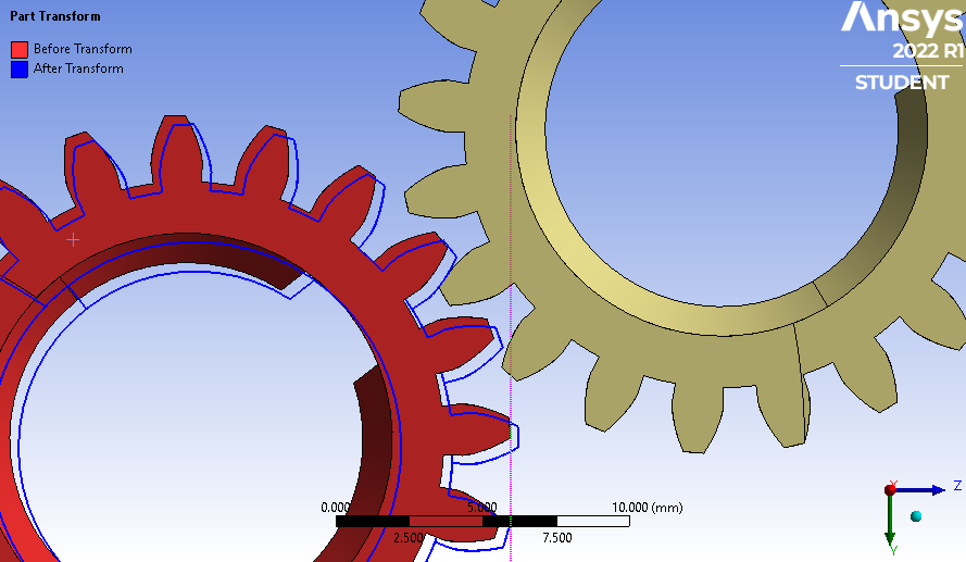

SubscriberThe gear teeth should be tangent to each other to begin the simulation. I opened the Geometry in SpaceClaim and moved one gear tooth face to be tangent to another tooth face.
There should be a moment on one gear to push the teeth together. The other gear needs a rotation defined to rotate the gears. ANSYS 2022 R1 archive attached.

Subscriber36*time is the equation for the rotation angle of the joint. At 1 second, the joint will have rotated 36 degrees.
You can make Frictional Contact with rigid bodies.
The geometry you have shows multiple faces on the gear teeth and there are steps in the surfaces. This is not good. You should improve the geometry.
I have shown a working simulation with a larger torque. If you use a smaller torque, you may need to make other adjustments in the simulation. Nonlinear convergence is not easy to achieve so expect to spend some time tweaking the model to get it to converge. You may need smaller time increments or smaller elements. Adding some damping to the joint with the moment applied may help. You may find a smoother motion profile if you ramp a rotational velocity up from zero rather than a rotation. It may help if one of the gears becomes flexible instead of a rigid-rigid contact with two joints, the whole structure is extremely stiff which makes convergence more difficult.
