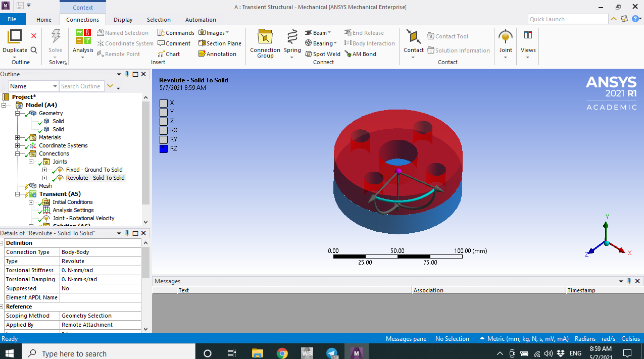

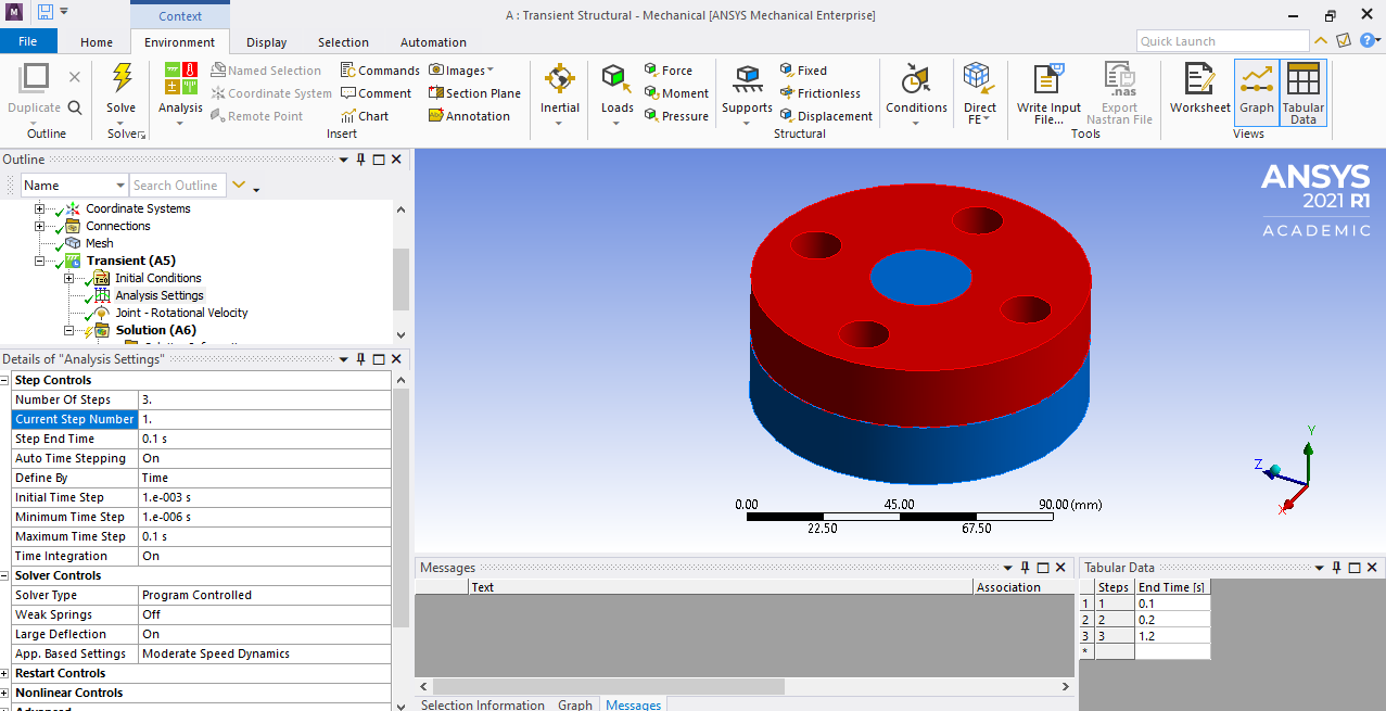

      Hey guys, I am simulating a rotating tank in transient structural. I use revolute joints and apply a joint load of rotational velocity to obtain the desired motion. However, the system keeps giving me errors. The error is "not enough constraints appear to be applied rotational velocity". I do the same problem with the same adjustments in Ansys "Rigid Dynamics" and everything is OK. But, to my odds, I find that transient structural is unable to solve this problem.

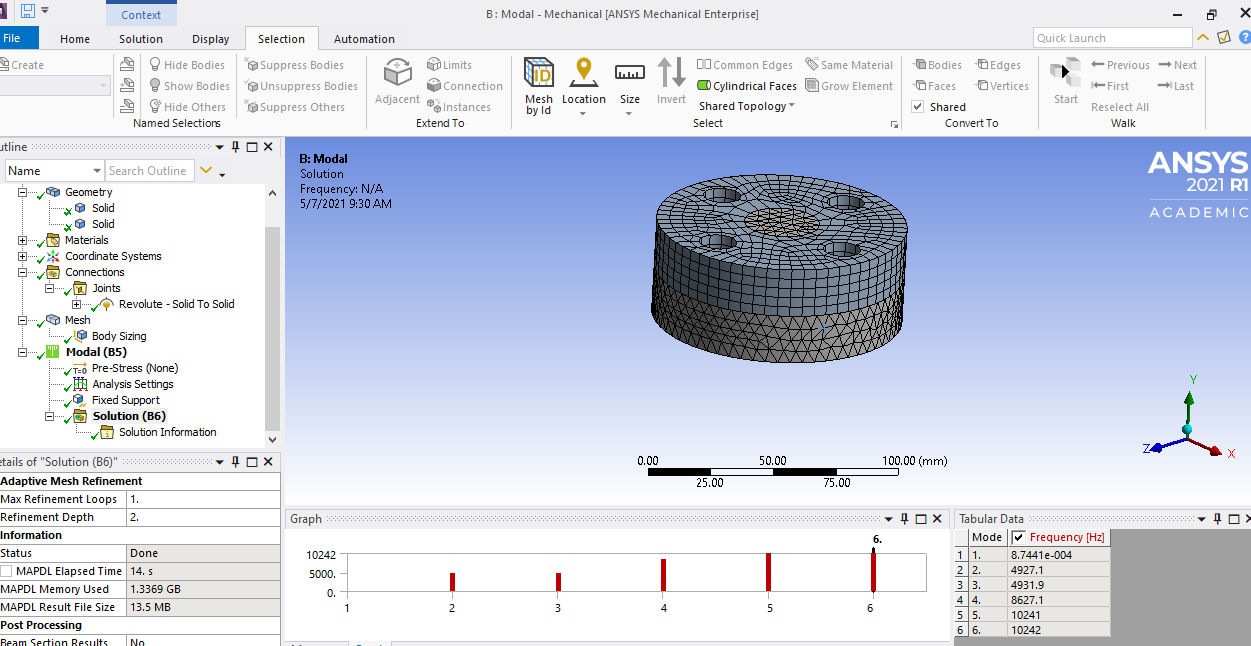

      Could you post some images of you model setup? Could you check whether all the connections are applied properly(perform a quick modal by duplicating the same analysis). Also, I hope large deflection and auto time stepping is ON.
      Regards Ishan.
    • masoudmtl

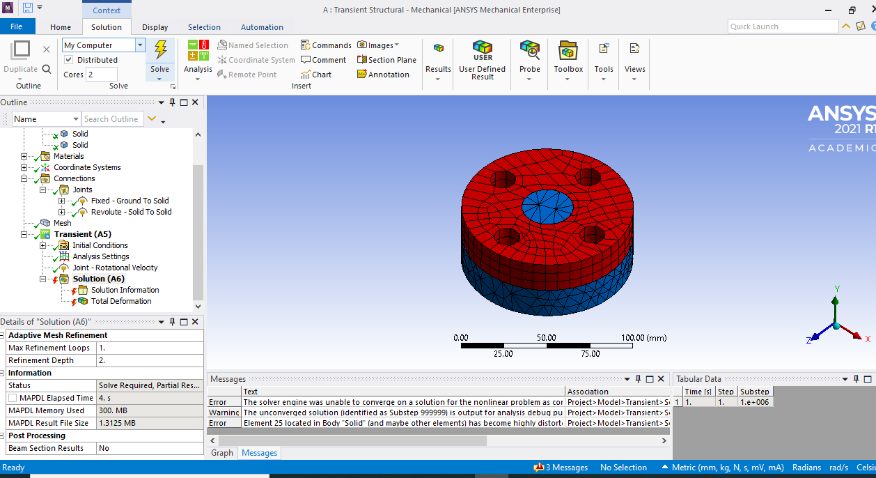

      Hello Ishan, I am not very familiar with Modal analysis in Ansys. Please let me know what kind of outputs you want from the modal part so that I can simulate it. In addition, you can find the images here. I receive 3 errors:
      The solver engine was unable to converge on a solution for the nonlinear problem as constrained.Please see the Troubleshooting section of the Help System for more information.
      The unconverged solution (identified as Substep 999999) is output for analysis debug purposes. Results at this time should not be used for any other purpose.
      Element 25 located in Body "Solid" (and maybe other elements) has become highly distorted.You may select the offending object and/or geometry via RMB on this warning in the Messages window.Excessive distortion of elements is usually a symptom indicating the need for corrective action elsewhere.Try incrementing the load more slowly (increase the number of substeps or decrease the time step size).You may need to improve your mesh to obtain elements with better aspect ratios.Also consider the behavior of materials, contact pairs, and/or constraint equations.If this message appears in the first iteration of first substep, be sure to perform element shape checking. Named Selections for the offending element can be created via the Identify Element Violations property on the Solution Information Object.

      I performed the modal analysis and the frequencies are really large as you can see.

      The distorted element error is because the velocity is step applied. That discontinuity is impossible to solve.
      Use a 2 step solution. In step 1, ramp the velocity from 0 to 20 rad/s over 1 second, then in step 2, have the velocity be a constant value of 20 rad/s.
      The images show different models: the first and third has a fixed and revolute joint, the second image has two revolute joints, the fourth has a single revolute joint. The correct configuration is one fixed and one revolute joint.

      Show the error. Show the Analysis Settings. Show the Step Settings. Show the Force Convergence Plot. Show the Model. Show the Loads.

      Hi again, these were the errors and warnings I received:
      The solution was executed using restart information
      The solution failed to solve completely at all time points. Restart points are available to continue the analysis.
      Although the solution failed to solve completely at all time points, partial results at some points have been able to be solved.Refer to Troubleshooting in the Help System for more details.
      Here you see the model:
      The analysis setting is here:
      The force convergence plot could not be obtained because the Ansys cannot solve the current situation. To my odds, the same settings in a rigid dynamics environment give me results.

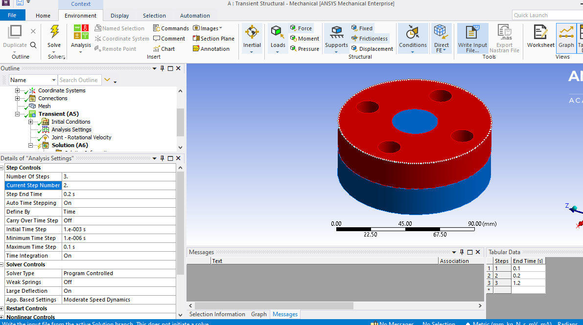

      Right click on the Solution branch and Clear Generated Data. You don't want a model that you are having problems with to Restart, you want it to have a clean start.

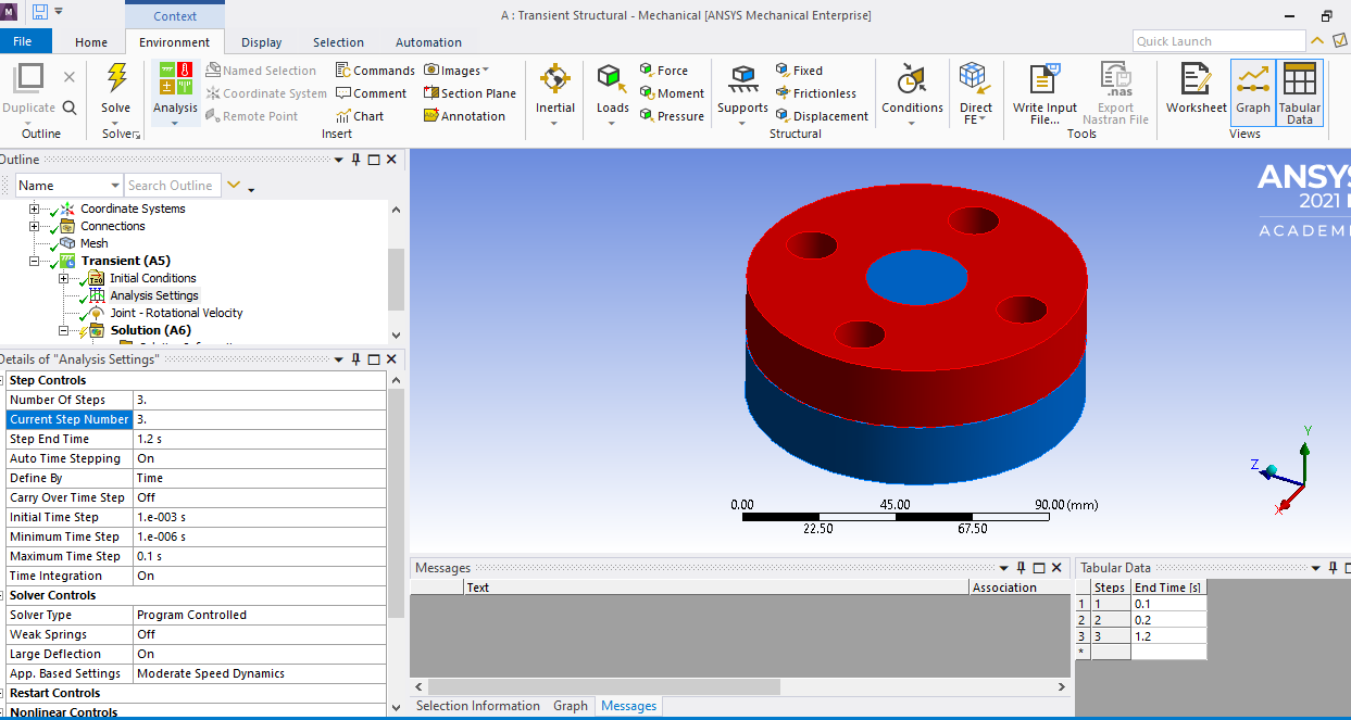

      You have not shown Step 1, you showed Step 3. Step 1 should have the Initial Time Step of 0.001 and a Minimum Time Step of 0.000001.

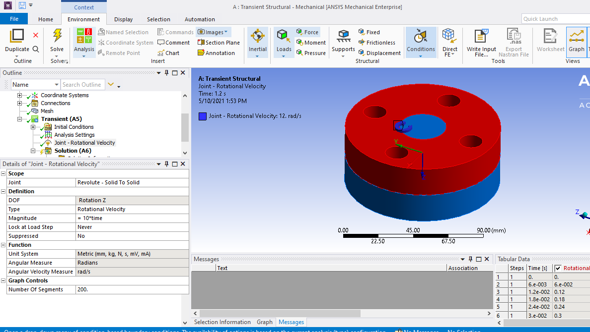

      You have not shown the load and what happens to the Rotational Velocity over Step 1, 2 and 3.
    • masoudmtl
      Dear peteroznewman, thanks for your notes. I changed step1 and 2 according to your instructions.
      step 2
      step 3
      and here is the rotational load

      Perhaps it is time for you to attach an archive of your model so I (or other non-Ansys staff members) can look for the mistake.

      Your test model ran just fine on my computer.
      Perhaps it is time to reinstall ANSYS?

      I used the Academic Version. I could see the rotation. See the .mp4 video.
    • masoudmtl
      Now, it is working for me too. Many thanks for your help!
