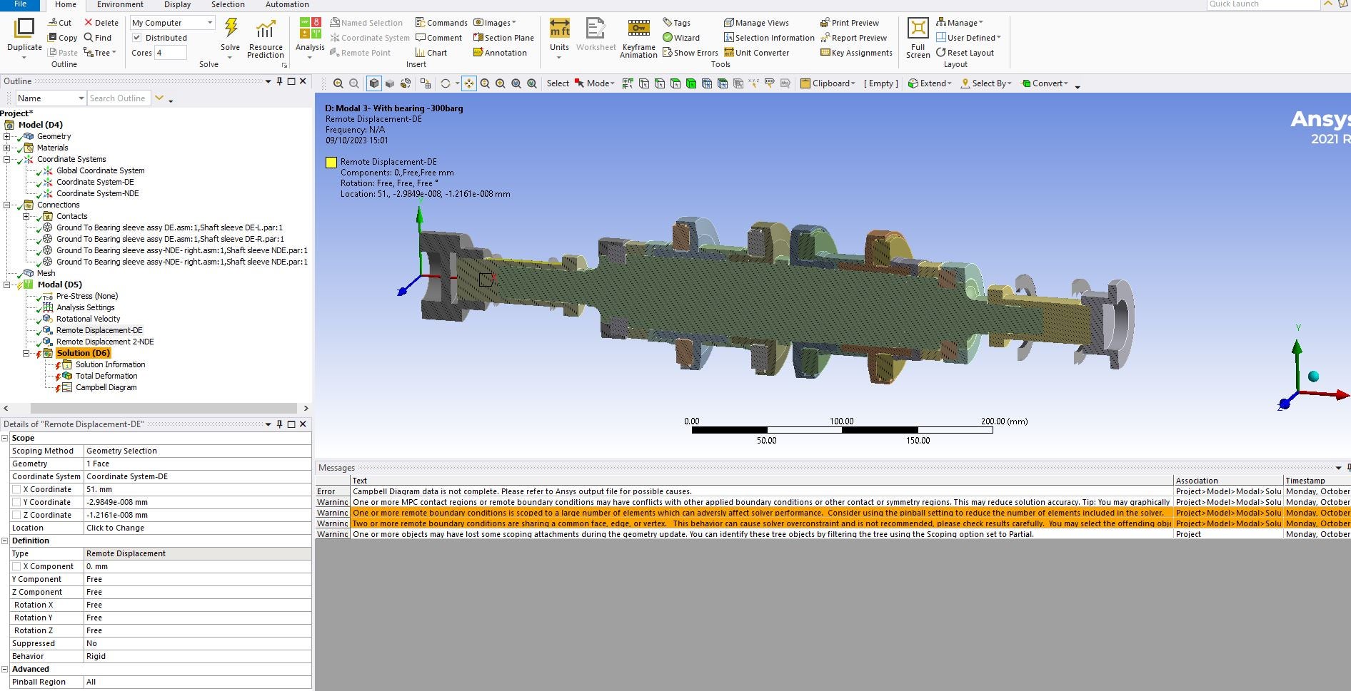

SubscriberHi, I am doing a modal analysis for a rotating shaft, there are 4 bearings, and 2 sets of bearings at each side of the shaft.Â
The bearing set includes stiffness and damping information. I have also constrained the axial motion with a remote displacement and have only X=0 leaving all others free for both ends.
I keep getting errors as shown in the picture and I do not know what to do to solve the problem.

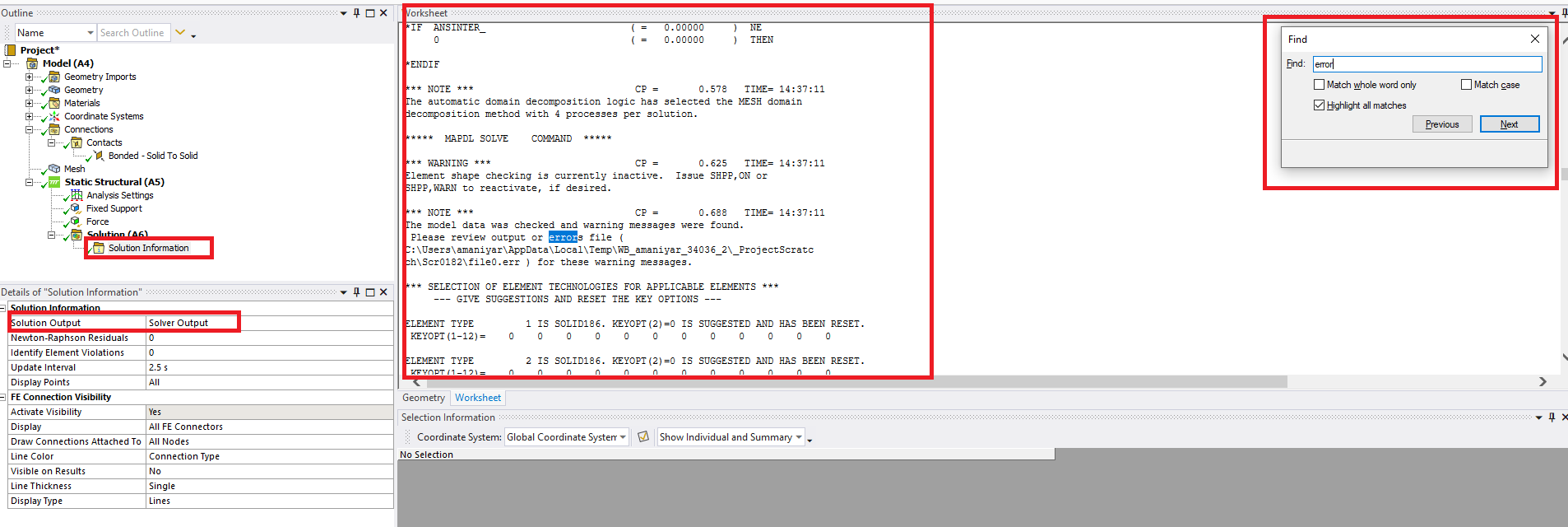

Ansys EmployeeHi Samira,
Can you also include the error messages in the solver output file?Â

Samira Ghasemabadi
SubscriberHi Akshay,
I could run the modal and got the result. I checked the solution information and my problem was the disk space availability.Â
Thanks for your reply.
