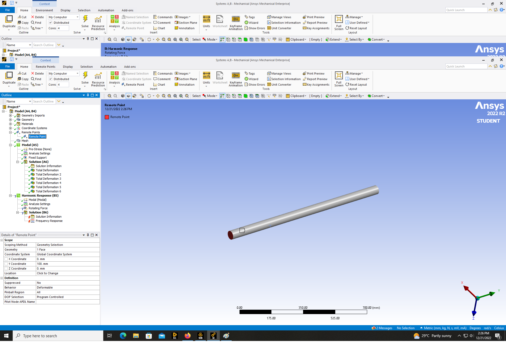

      Dear all, i tried to do harmonic analysis by using MSUP method on a rod.
      6 modes and its frequencies are obtained under fixed support of rod at one end and other end free.
      Remote point is created and used for the rotating force application, but still i could not simulate the conditions.
      i am attaching the files for reference. Kindly suggest me what to do?

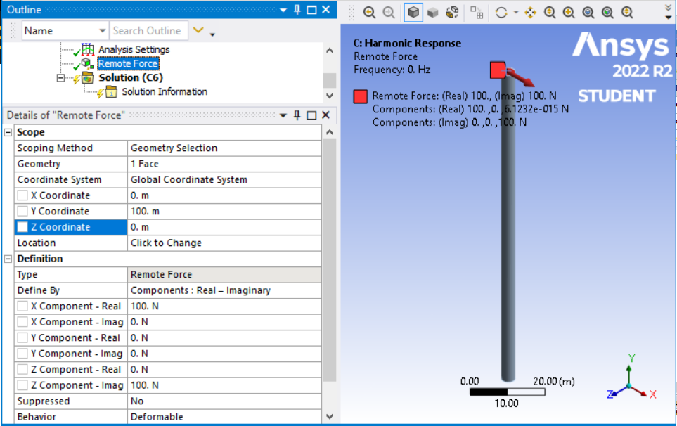

      Delete the Rotating Force. Create a Remote Force scoped to the Remote Point and enter the Components of the force in both the Real and Imag lines as shown below. This will create a rotating force of 100 N in the X-Z plane.
