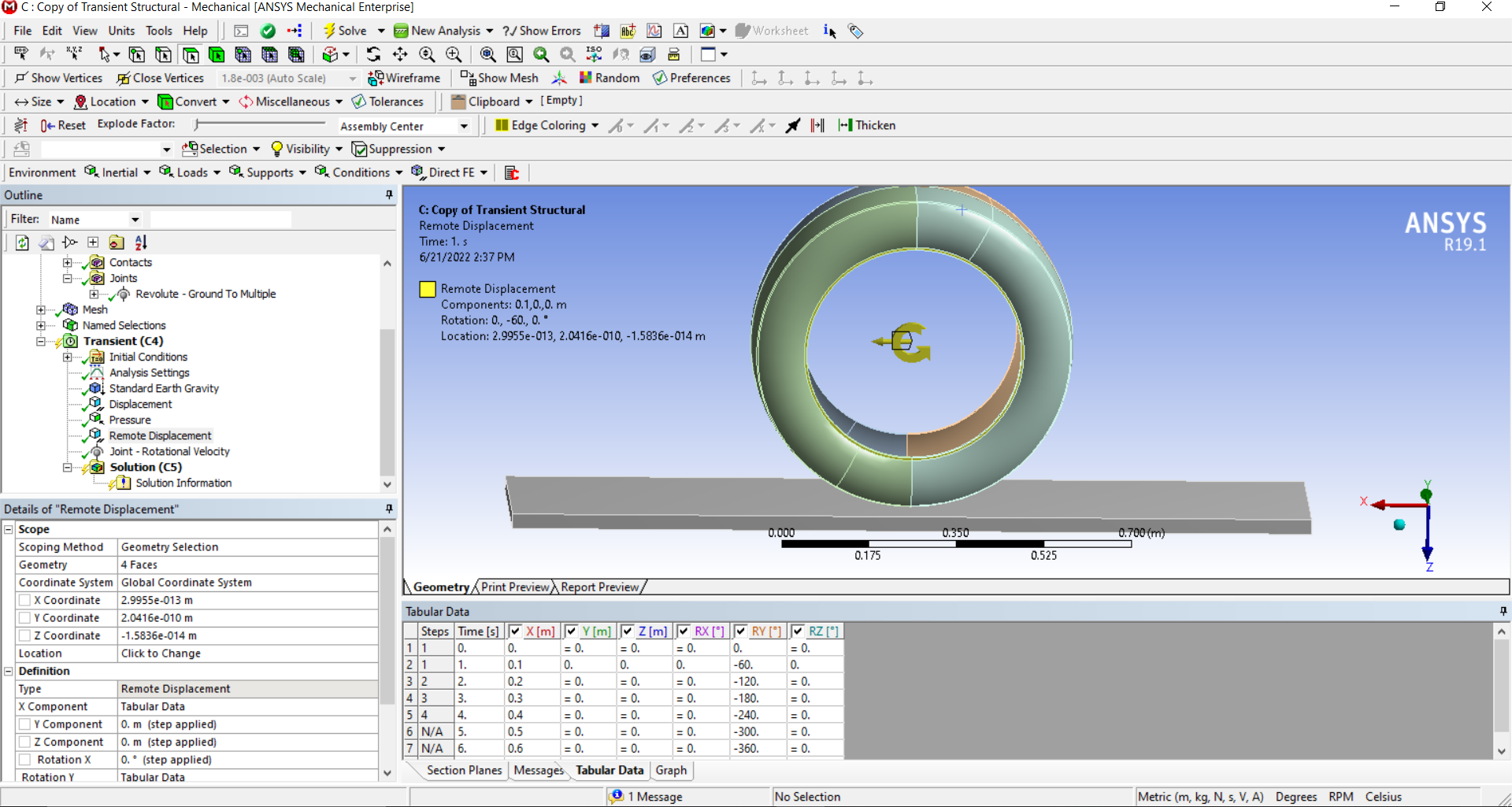

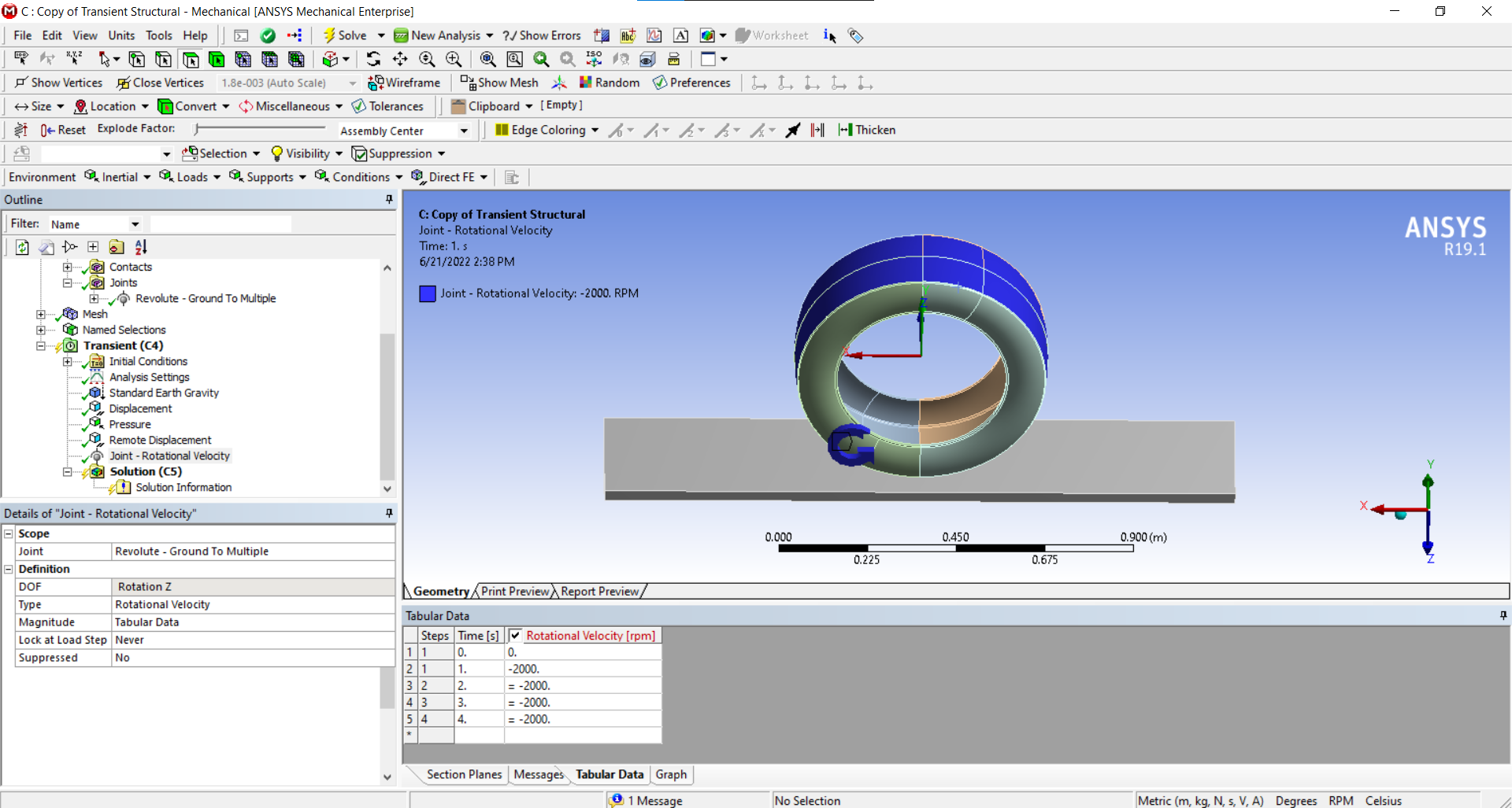

Hi! Your remote displacement will turn and move the wheel, while the rotational velocity doesn’t actually move anything. It creates forces radially outwards (centrifugal force) as if your part was spinning. Whether you chose the surfaces correctly depends on the problem you are investigating, but your selection will at least make the wheel move and turn.Â

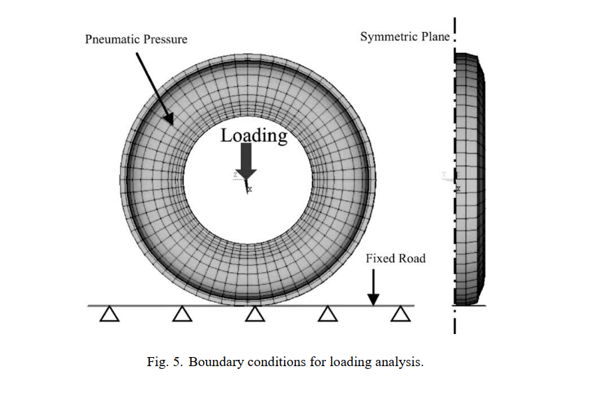

Since I'm looking at the temperature generated through frictional rotation I think it's better to use the Transient model.
I used remote displacement and the tire passed and shifted forward. I want to add the rotational velocity relative to the car's speed to see if it makes much of a difference.

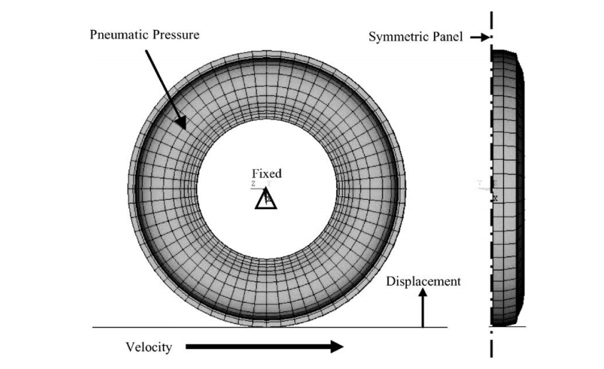

I'm choosing a model between the tire and the road so I'll do another similar problem later on.
In the previous paper, they would leave the tire standing still. The pavement has velocity and the upper surface will move upwards.
In this problem, I want the tire to move and rotate on the pavement.
I want to set the rotational velocity of the tire, how should I set it?

SubscriberIf you reread that discussion, it begins with a road and I describe how to do that.

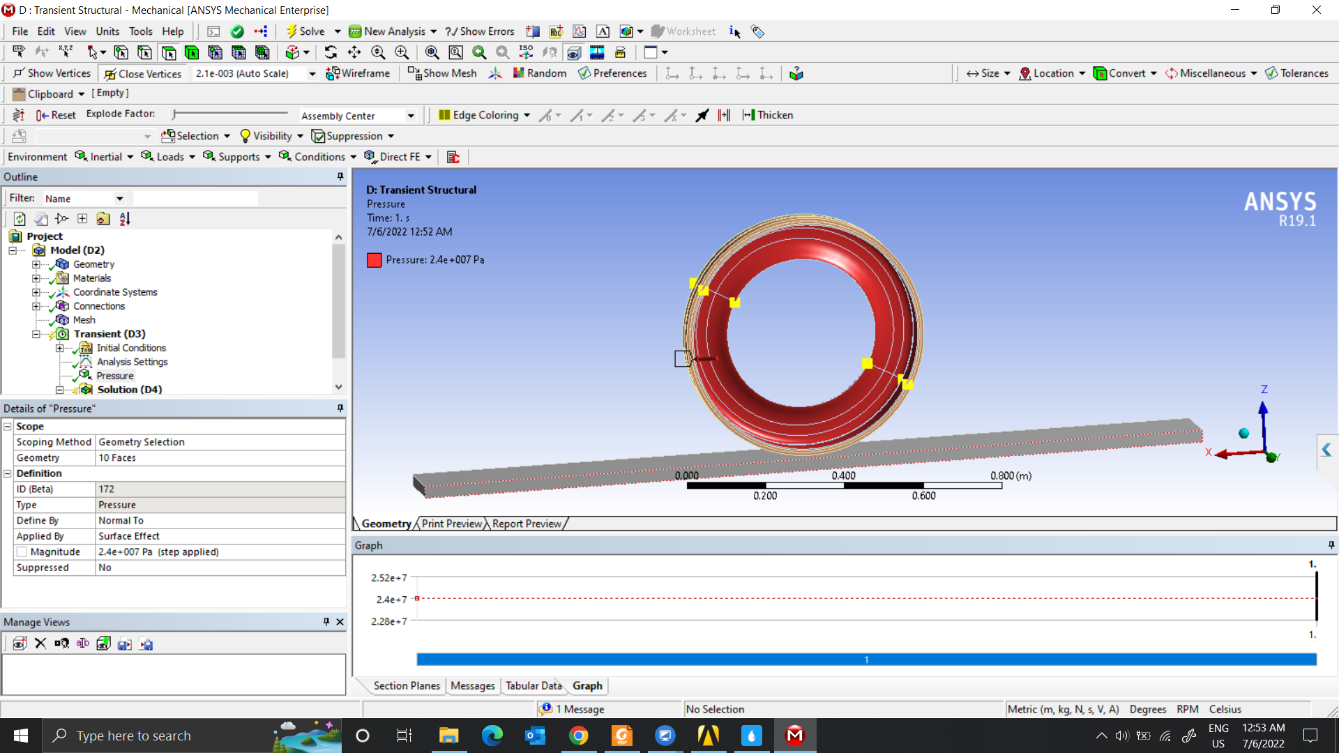

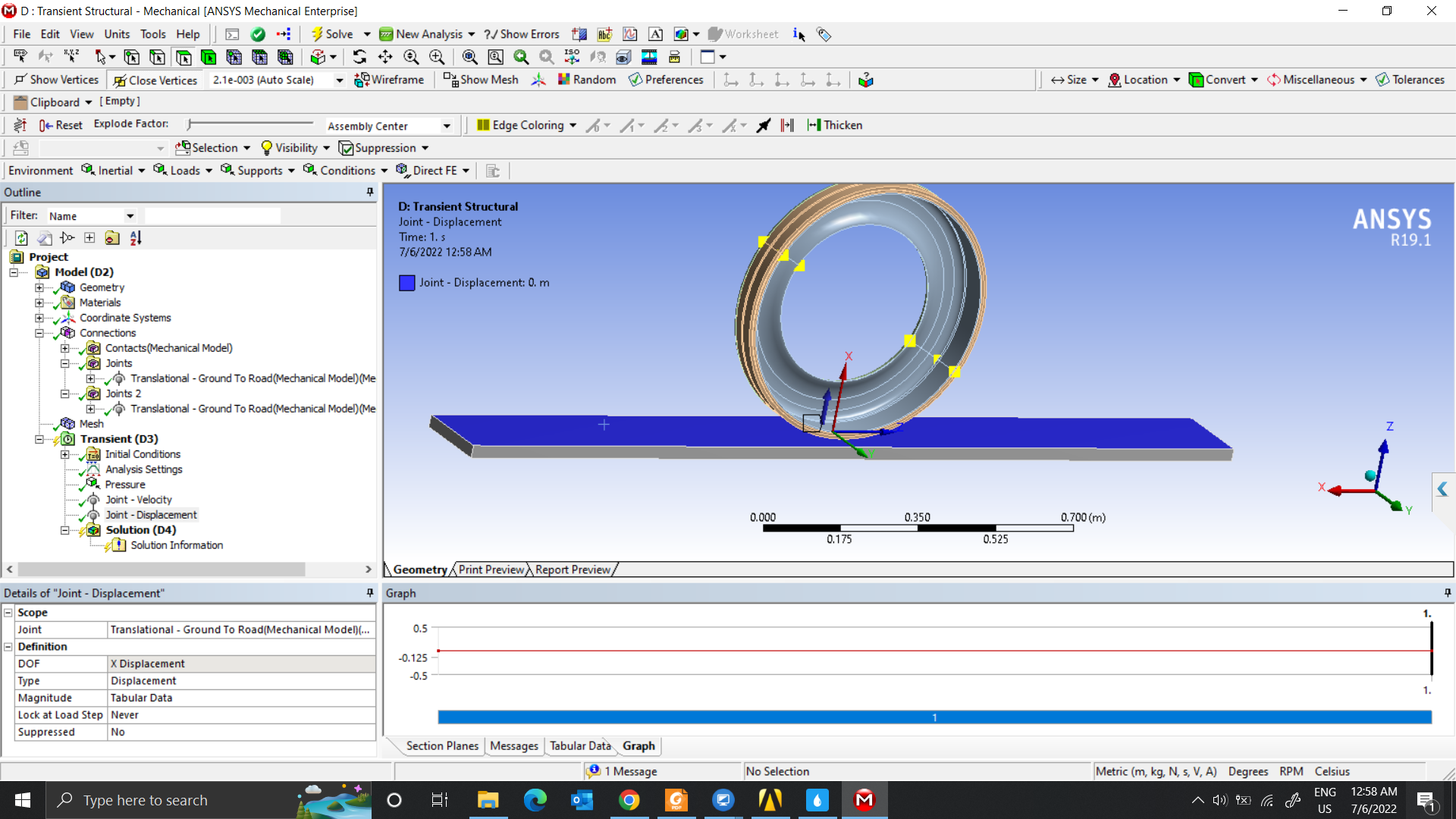

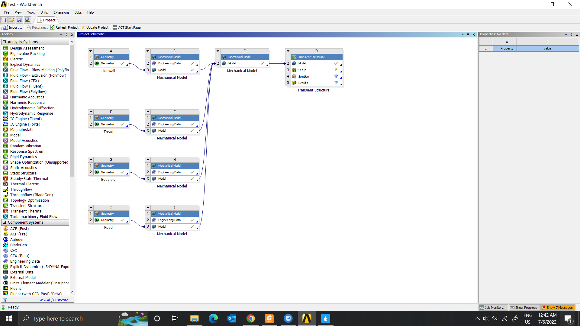

SubscriberHello Peter, I hope you can help me again.
I am using more than 1 material layer so I am joining multiple models like this photo

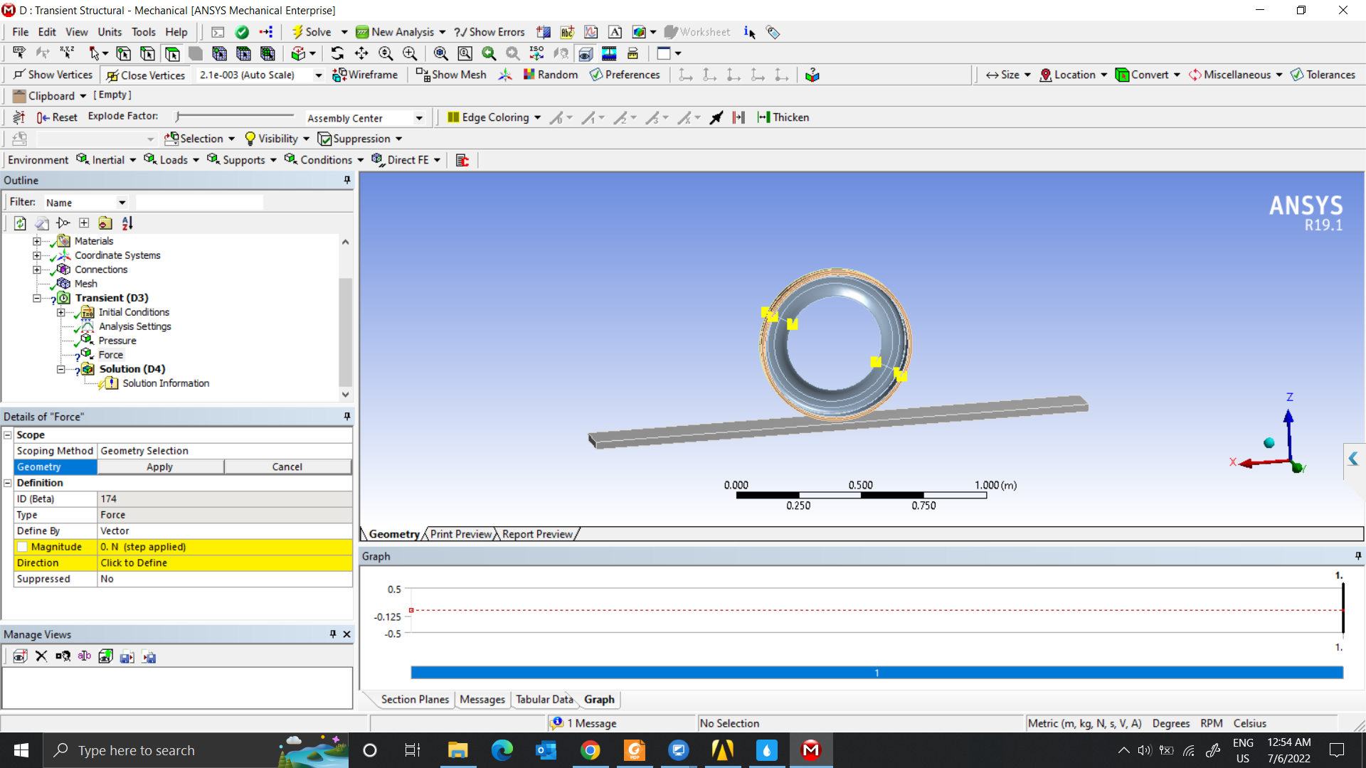

In the first step, I want to find the displacement of the tire. I will set the pressure condition on the inner surface of the tire. Next is the pressure but I don’t know how to set it properly. Hope you can guide me further. Thank you very much.
Pressure setting
Force Setting
After finding the tire displacement, I will go to step 2 and I will set it up like that.

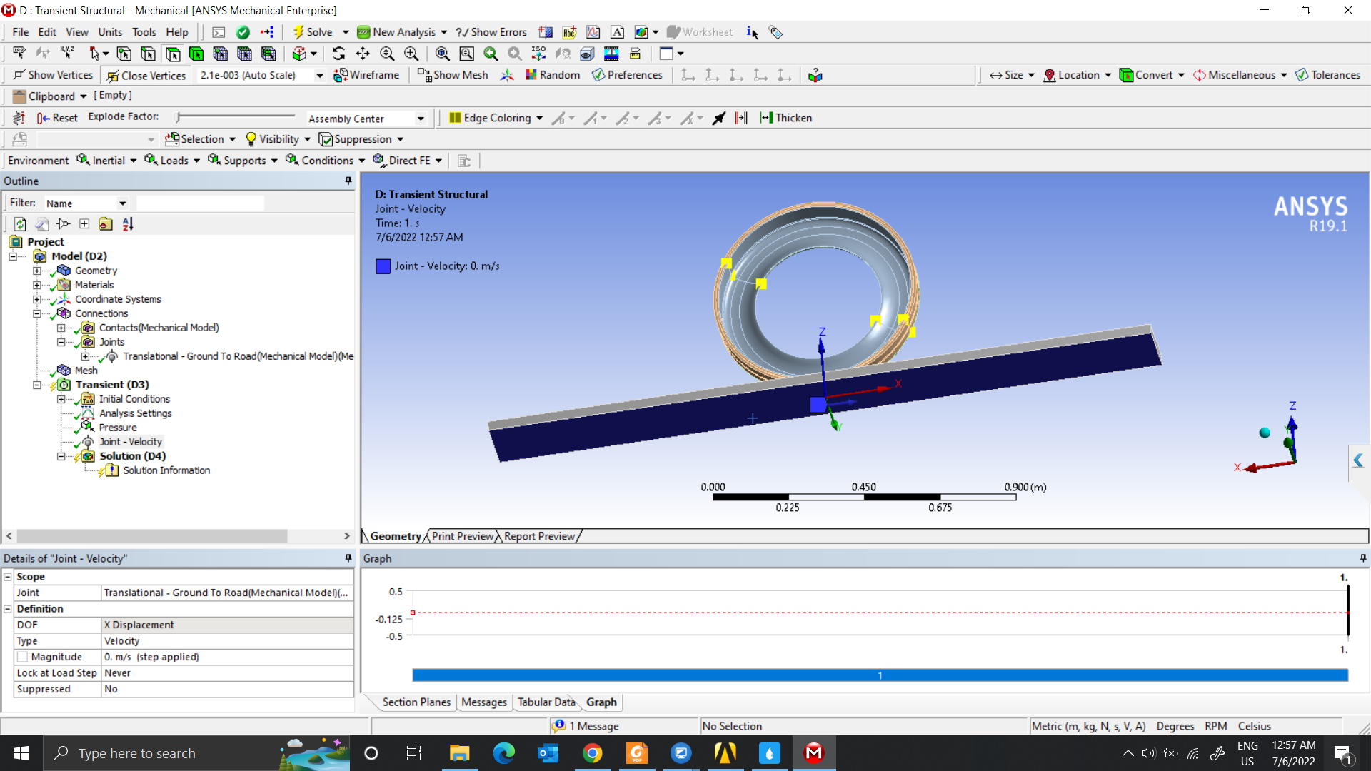

Velocity
As for how to fix the tire, I don’t know.Thank you so much for helping me. Have a nice day.Â
July 6, 2022 at 5:55 pm
peteroznewman
SubscriberÂ
You need a dummy body. The dummy body has a Translational Joint to Ground with the axis normal to the road surface. The joint load is a displacement. The tire is on a revolute joint to the dummy body. The road is on a translational joint with the axis parallel to the road length. The joint load should be displacement. The velocity is calculated by displacement/end time. As the road moves, the tire will rotate by the frictional contact between the tire and the road.
In the Transient Structural analysis:
Step 1 holds all Joint Loads at 0 displacement and adds the Pressure with Time Integration Off
Step 2 moves the dummy body Translational Joint by a small distance to squash the tire with Time Integration Off. Probe the Joint Reaction to measure the Force.Â
Step 3 change the road Translational Joint from 0 to the end displacement with Time Integration On.

How to get a dummy body? Could you please specify more?
July 8, 2022 at 1:23 pm
peteroznewman
SubscriberTo add a dummy body, open the geometry in Spaceclaim. Add a New Component. On a vertical plane, draw a square with one corner on the axis of the tire. In Mechanical, make the new component be Rigid. Add a revolute joint between the square and tire with the origin at the tire axle. Add a translational joint on the vertical edge of the square.
