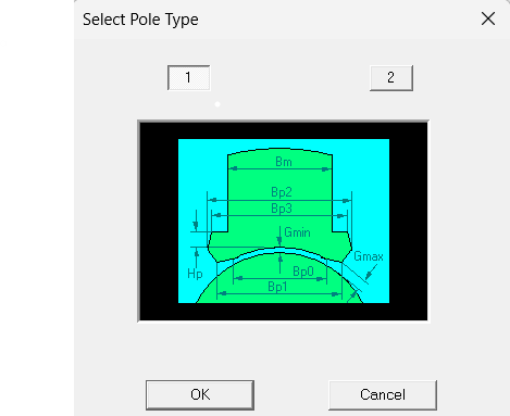

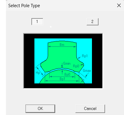

      How to make user defined pole shoe dimensions in rmxprt
      In ansys rmxprt we have only two types of variations pole type 1 and pole type 2
      but i want decremental pole shoe like below please help me to figure out this .
    • Reshmi Raghavan
      Hello Krishna,
      In RMxprt we dont have user defined option for pole creation. RMxprt only support the two type of pole shapes which you have highlited. The best that can be done is to adjust the dimesnions of the pole to get to the below shape.
