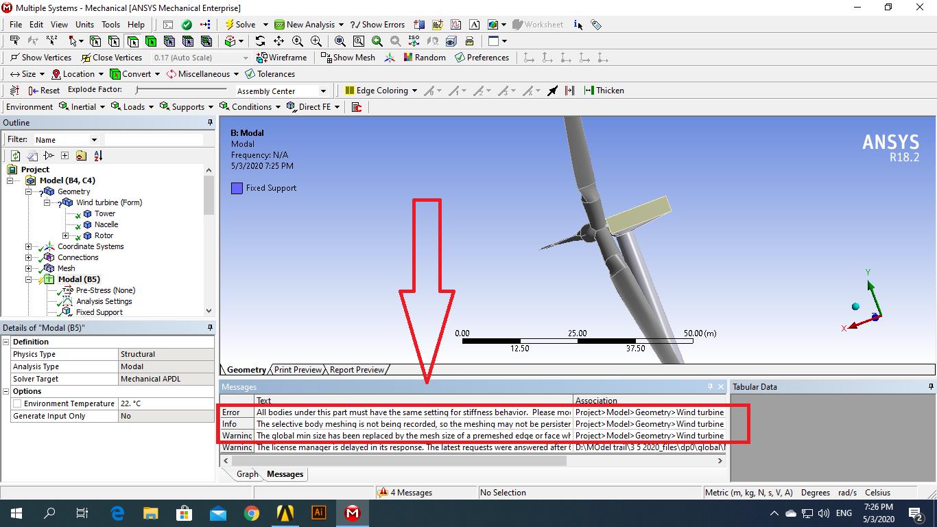

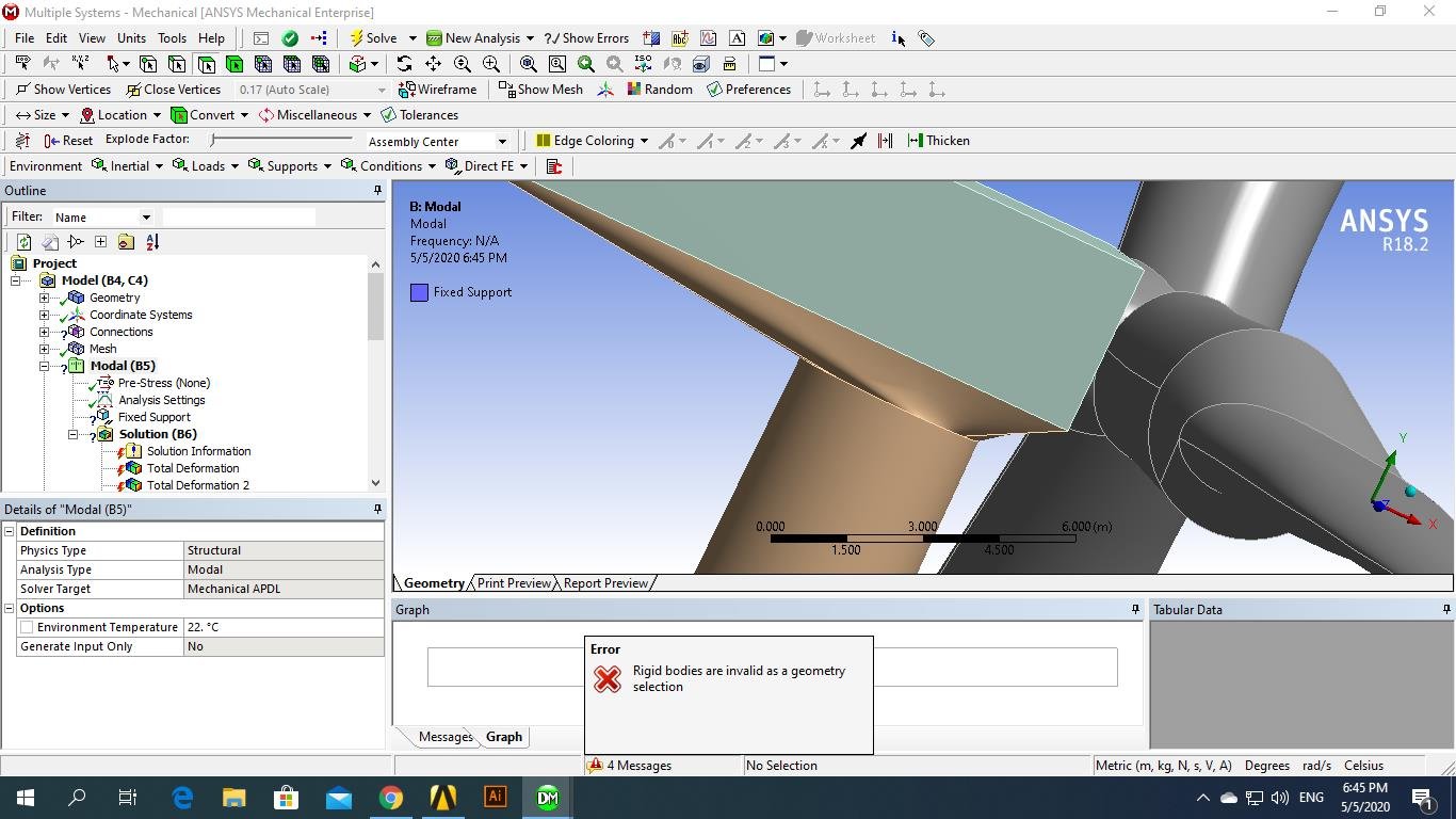

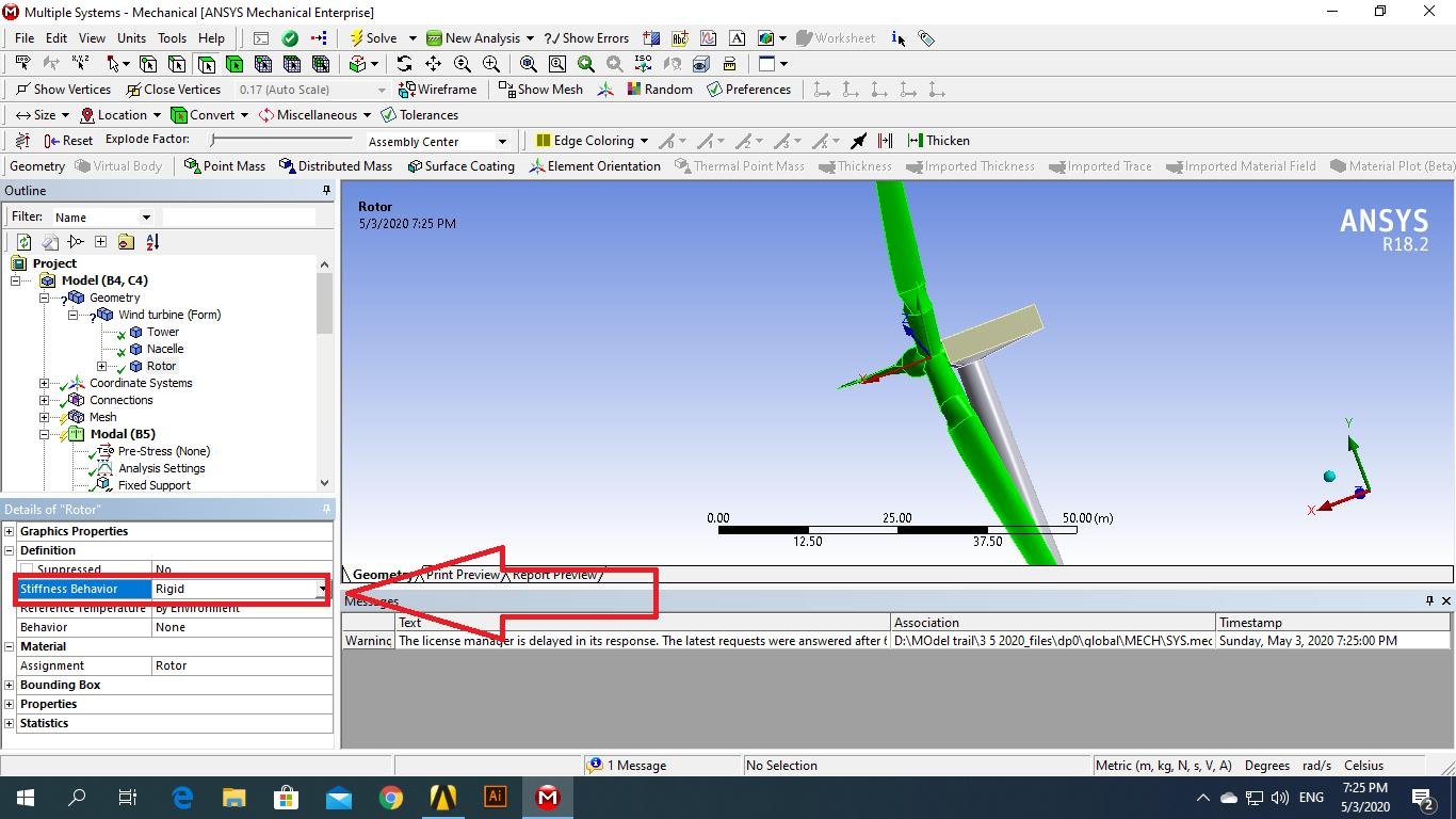

Forum ModeratorHave you tried moving the rigid bodies to separate multibody part as mentioned in the error message?
-Aniket

Abdelrahman
SubscriberIf I moved them away or excluded Rotor from form
Mesh will be disconnected, am I right ? -

Aniket Chavan
Forum ModeratorNo. You will have to use contact or joint.
-Aniket

Aniket Chavan
Forum Moderatorcan you expand the tree to show subbranches of Geometry and Connections? You should have the rigid body as target not as contact.
